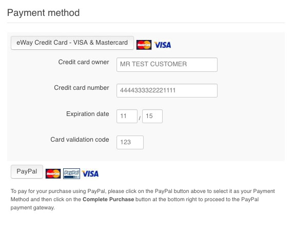

Hi there,
I've come across a strange problem with Payment Method selection that my client has found while testing the checkout process.
We have two payment methods set up, the Eway payment gateway and PayPal, with Eway appearing first on the checkout page and being selected as the default.
The client did the following:
1. Filled out their credit card details in the Eway fields - all good.

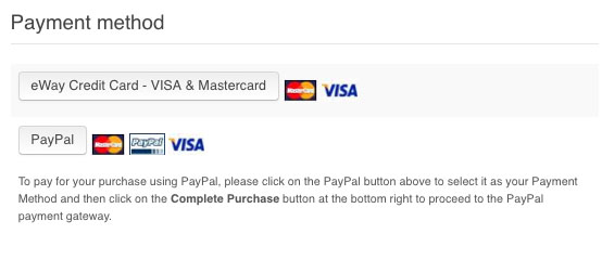

2. Then, just because she thought a customer might do it, she then clicked on the Eway button which selects it as a payment method. When she did this the credit card details fields disappeared as if she had clicked on the PayPal payment method and there was no way of getting them back.
I've attached 2 screenshots that show the before and after of doing this, with test credit card details of course.
Is there something we can do to stop this from happening if a customer accidentally clicks on the button after entering the card details?
Nathan
