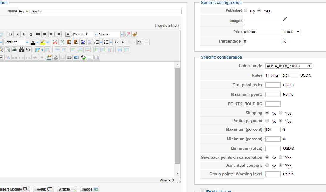

I'm pretty bright and understand most things....but I cannot get my head around the percentages (%) for the alphauserpoints payment system
Here's the scenarios
Customer has 10,000 points
Purchases a $5.20 product
I don't have any amounts in the maximum % field or the minimum % field (because I'm confused on how to use them)

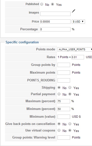

So I check out the documentation and use the sample info (75% maximum) and (50% minimum) to see what it looks like in my dummy order...and
1. I don't see an option where the user gets to CHOOSE to use points to partially pay for the order
2. I don't really understand what the 75% and 50% actually do in the order.

12 years 2 months ago #145743
Hi there,
I don't know which version of Hikashop you are using but we did a lot of improvements on this plugin.
First, make sure you have the last Hikashop version. Then, tell me what you are trying to do and I'll give you some guidelines to achieve it.

What you need to do is enable the option "partial payment" of the plugin.
This will allow your customer to pay with point but not the entire order.
Then, to determine the range they can pay, you must use the minimum and maximum values.
Example, Min:50% and max:75%
Order is 100€.
You customer will be able to use their point to pay between 50 and 75€ (if they have enough points)
If you want them to pay 20% max, just set min: 0 and max: 20%
I hope it's clear enough!

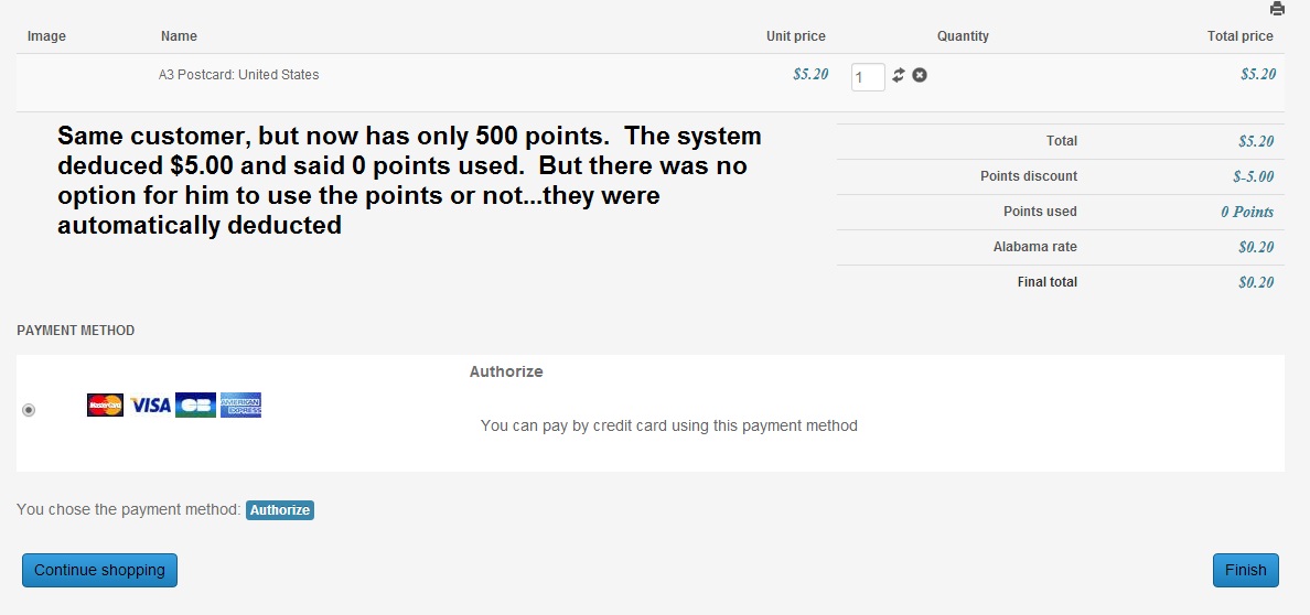

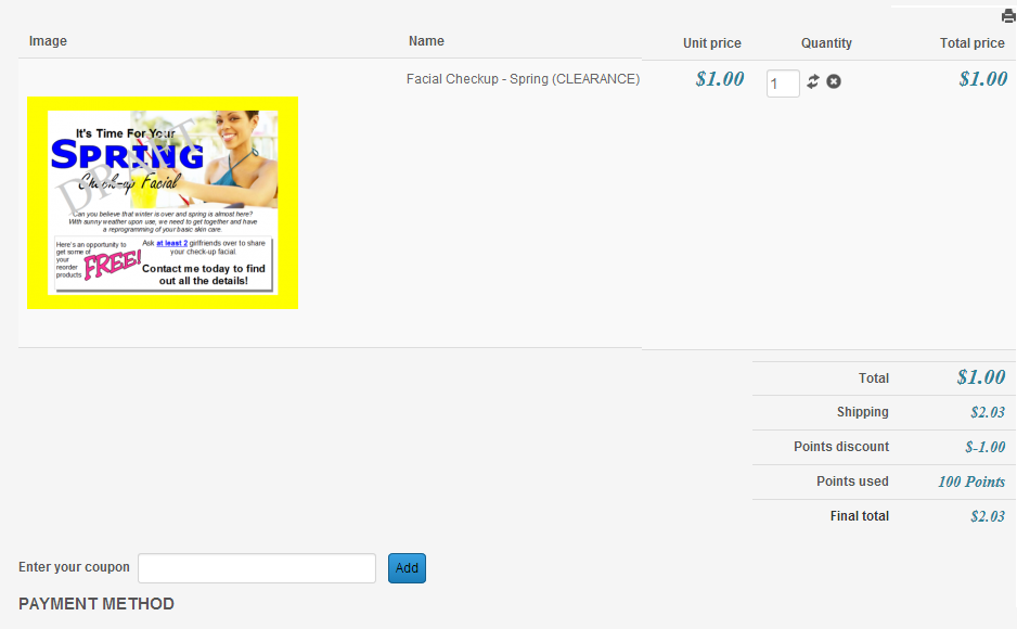

12 years 2 months ago #145789
Yes, it makes sense...but something is still not working because I still don't see an option in the payment methods for the customer to use the points for the payment. The system is just automatically applying them without him choosing to or not.
Here's the plugin and what I have done:
Here's a shot of the cart for customer test 1. Customer has 500 points....
Last edit: 12 years 2 months ago by simmiepam. Reason: Wrong screen shot for the plugin

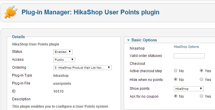

12 years 2 months ago #145811
Which version of HikaShop are you using ?
It is strange that it says you are using "0 points", it looks like an old bug on the plugin which did a wrong conversion of the point number during the display. It should be fixed in the latest version : 2.3.0
Otherwise, to let the customer choose if he want to use his points or not, you have to activate the option "Ask for no coupon" in the plugin (your last screenshot) and after that, you will see a new available step while configuring your checkout workflow.
This new step will allow your customer to see the number of his points and choose if he want to use them or not for this order.

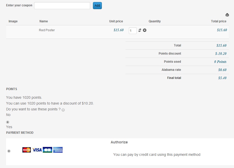

12 years 2 months ago #145813
Thank you...I just purchased Essentials 2 days ago.
Is there something else I should have downloaded other than buy Essentials?

12 years 2 months ago #145814
EUREKA. It's working
Here's what I WAS NOT doing.
On the plugin...I didn't have the Ask For No Coupon checked
And I didn't have the SHOW POINTS as Alphauserpoints. I had HikaShop chosen instead.
Hooray!
  • Posts: 208
  • Thank you received: 10
12 years 2 months ago #145815
OK. I now have the points section showing...
BUT.... the statement that I've used 0 points is still showing
And....the points section...can I alter how that looks? Box around it....the text larger, etc.? If so...where can I do that?

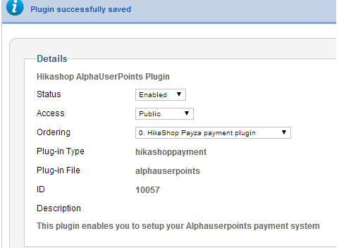

11 years 10 months ago #159483
For some reason.....the problem is happening AGAIN!
It is AUTOMATICALLY applying the alpha user points to the cart WITHOUT giving the customer the option to choose or not!!!
Here's my screenshot for the plugins and cart
Hikashop AlphaUserPoints Plugin screenshot
HikaShop User Points payment plugin screenshot
Cart Screenshot
Notice it did not give the customer the OPTION to use the points or not...it automatically applied them!!!!
  • Posts: 26337
  • Thank you received: 4065
11 years 10 months ago #159498
The plugins "user points" are not the same than the plugin "alpha user points".
Please do not use the "alpha user points" one which is deprecated.

11 years 10 months ago #159534
Thank you
If you notice the title of my images.....I'm not using the outdated plugin...
I'm using:
  • Posts: 26337
11 years 10 months ago #159543
"Hikashop AlphaUserPoints Plugin" is outdated/deprecated.
"HikaShop User Points payment plugin" is the plugin which replace the payment part of the deprecated plugin.
"HikaShop User Points plugin" is the plugin which replace the "gain of point" part of the deprecated plugin.
