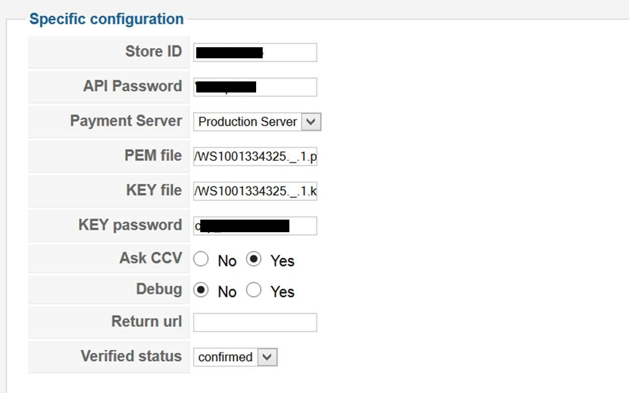

I've followed the steps from First Data and dropped the files in the folder and FTP'd them... getting hung on on the last step in the checkout process to process the payment. I know this is vague; but, any idea what the issue might be.

12 years 5 months ago #147723
nothing out of the ordinary- i followed the setup instructions for the gateway...
when you get to checkout nothing happens... pm me and ill be happy to send over admin access to take a look if you need to..

Can you just put the absolute path for the PEM and KEY files ?
Just like explain in the documentation : www.hikashop.com/support/documentation/i...-firstdata-form.html
