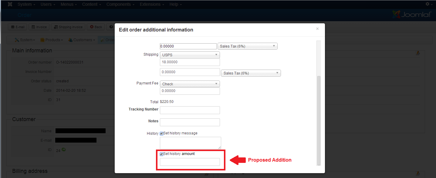

I have some customers that pay in full via the paypal plugin before their order is shipped, but I also have some customers that make cash down payments and do not pay the remainder until after they receive their order.
I need to be able to manually record partial payments made in cash from the backend, but I want the information to be stored the same way as paypal payments are stored - for consistency's sake.
My though process was to add a field to the "Edit order additional information" popup located on the edit order page. The field would updated the history_amount field in the __hikashop_history table.
I think that is the only place in the database that I would need to record the payment amount, but I could be wrong. Also, I am not sure which file(s) to edit to accomplish this and would rather not spend hours looking for it if I don't have to.
If someone could please chime in to point me in the right direction or perhaps even suggest an easier method I would greatly appreciate it.
I am, of course, happy to share my modifications so others with similar needs can benefit, I will post back to this thread once I have some workable code.
Thank you in advance!

Made this addition to administrator/components/com_hikashop/views/order/tmpl/edit_additional.php around line 187:
<dd class="hikashop_orderadditional_history">
			<span>
			<input onchange="window.orderMgr.orderadditional_history_changed(this);" type="checkbox" id="hikashop_history_orderadditional_store" name="data[history][store_data]" value="1"/>
			<label for="hikashop_history_orderadditional_store" style="display:inline-block">
				<?php echo JText::_('SET_HISTORY_MESSAGE');?>
			</label>
			</span>
			<br/>
			<textarea id="hikashop_history_orderadditional_msg" name="data[history][msg]" style="display:none;"></textarea>
		</dd>
<!-- start addition by pk -->
			<span>
			<input onchange="window.orderMgr.orderadditional_history_amt_changed(this);" type="checkbox" id="hikashop_history_amt_orderadditional_store" name="data[history][store_data]" value="1"/>
			<label for="hikashop_history_amt_orderadditional_store" style="display:inline-block">
				<?php echo JText::_('Record Payment');?>
			</label>
			</span>
			<br/>
			<input type="text" id="hikashop_history_amt_orderadditional" name="data[history][amt]" style="display:none;" />
		</dd>
<!-- end addition by pk -->
		<dd class="hikashop_orderadditional_usermsg">
Made this addition to same file around line 213:
<script type="text/javascript">
if(!window.orderMgr)
	window.orderMgr = {};
window.orderMgr.orderadditional_history_amt_changed = function(el) {
	var fields = ['hikashop_history_amt_orderadditional'], displayValue = '';
	if(!el.checked) displayValue = 'none';
	window.hikashop.setArrayDisplay(fields, displayValue);
</script>
I have a field now, but am not sure how to make it update the correct database field. I have tried looking at the following files, but nothing is jumping out at me ...
administrator/components/com_hikashop/controllers/order.php,
administrator/components/com_hikashop/classes/order.php
administrator/components/com_hikashop/classes/field.php
