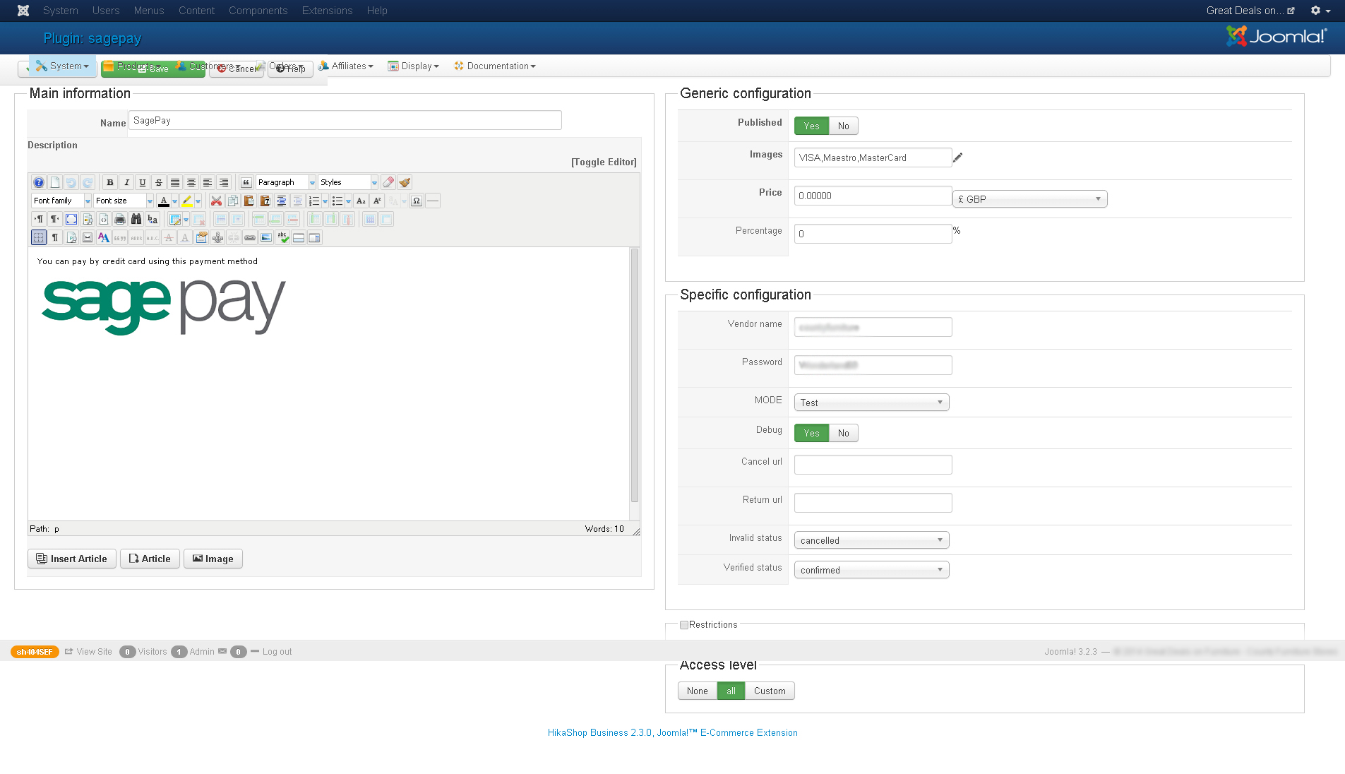

Can you show me some screenshots of how did you configured your Sagepay payment method ?
  • Posts: 13
12 years 4 months ago #151728
Hi Mohamed
Thank you very much for your help with this
Please see the attached full screenshot of the Sagepay page

I have spoken to Sagepay support and they are confirming that to get this error the currency code is not being passed to Sagepay via the Form Integration. Yes, the currency code GBP is selected in the Hikashop Sagepay plugin as you can see from the screenshot.

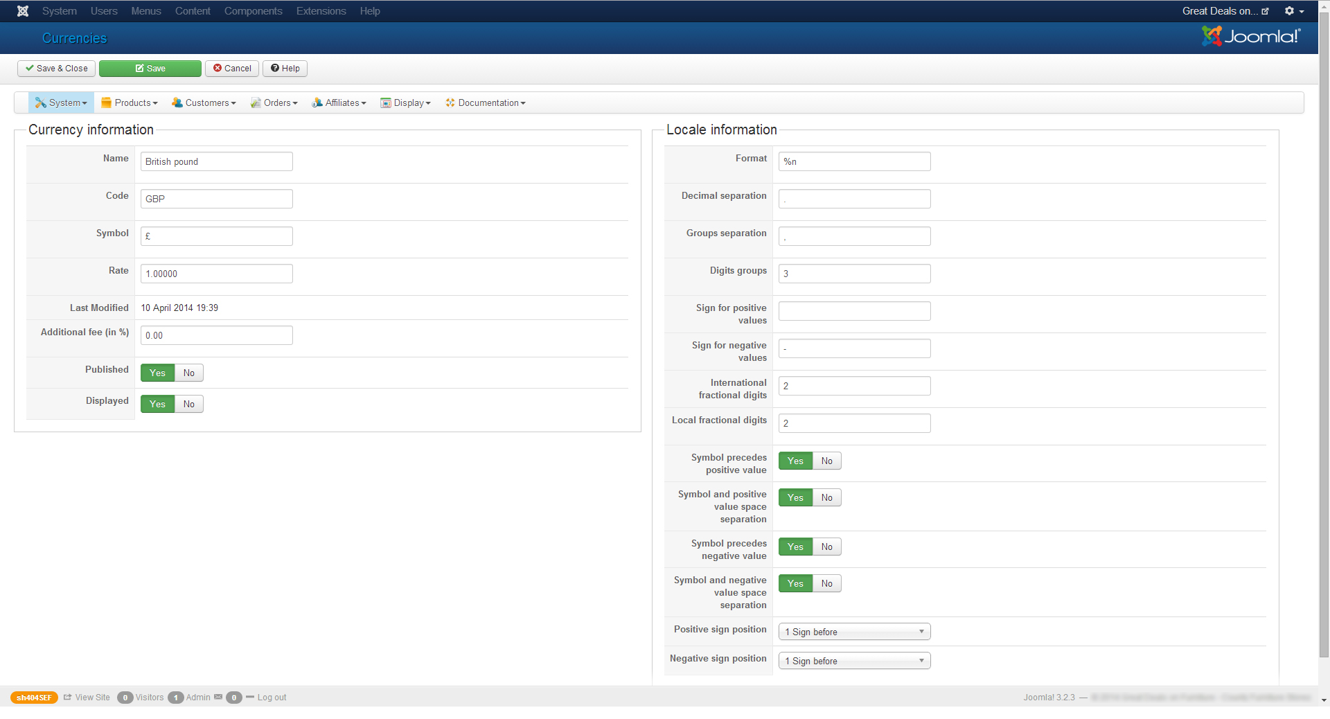

About the currency, would it be possible to have a screenshot of your GBP currency configuration ?
  • Posts: 13
12 years 3 months ago #151953
I checked the payments log file. It reports as empty, but the transactions tested have gone through to the point of redirecting to Sagepay and then get their 3405 error.
A screenshot of the currency configuration screen is attached.
