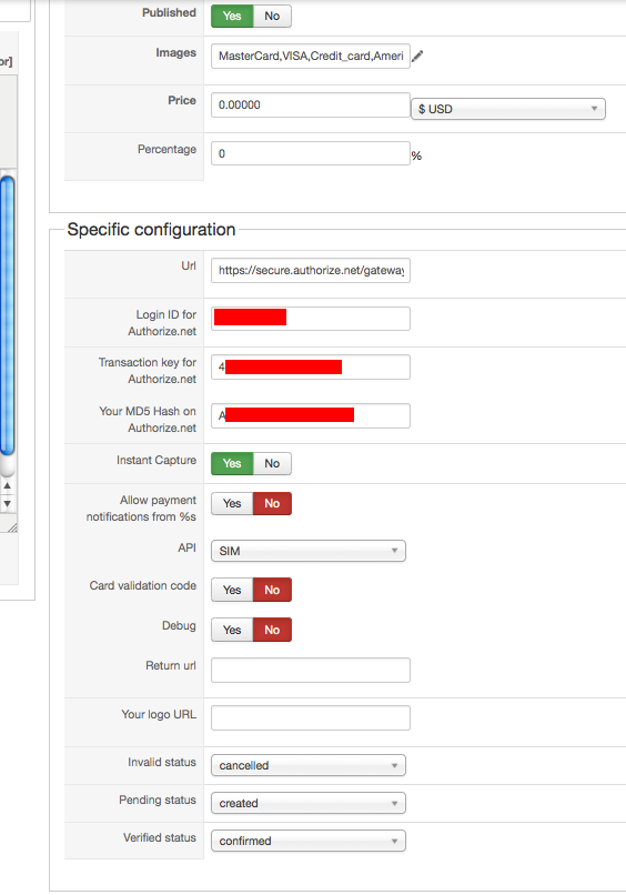

I'm trying to configure the Authorize.net payment option, but I receive the error quoted above. The attached image shows how it is configured. Any idea about what I'm missing?

This error message is sent by Authorize.net and says that your account is not properly activated. You need to contact the Authorize.net support so that they can check your account and fix it or tell you what you're missing in the account settings.
