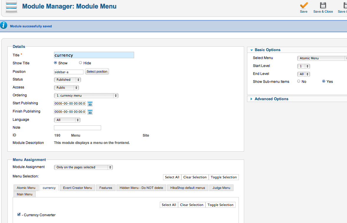

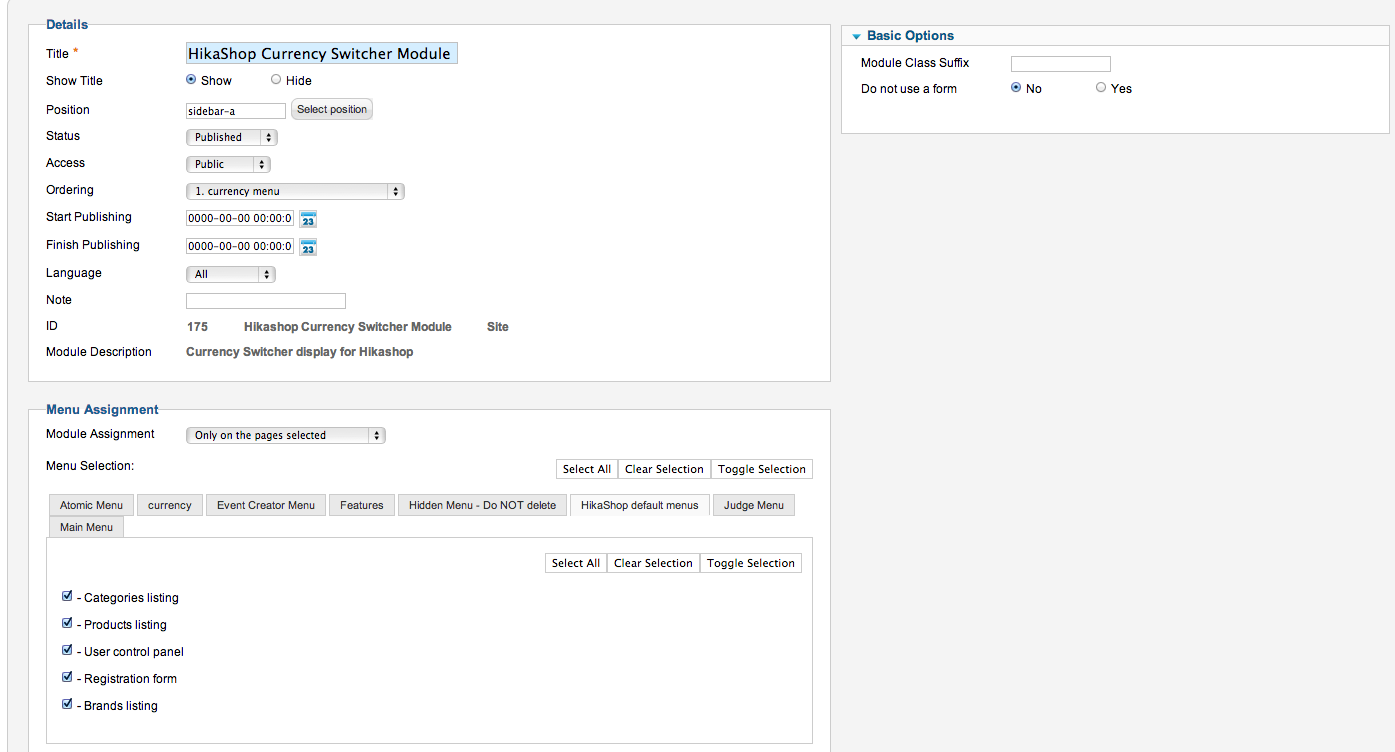

I can get it to work when selecting "on all pages" in the HikaShop Currency Switcher Module (screenshot #1)
However when I try to create a menu and assign it to that, it won't work...(screenshot #2)
Thanks in advance for the help.

Are you sure that the position "sidebar-a" is available in your template ?
  • Posts: 241
  • Thank you received: 5
11 years 11 months ago #155003
Yes I am quite sure.
When I have the module displayed "on all pages" it works fine.
What I would like is to have it either on the cart page or on the product pages.
I can not seem to get either without setting up special "hidden menu" items which then don't work with the workflow of hikashop.
Thx.
  • Posts: 26337
  • Thank you received: 4065
11 years 11 months ago #155013
The link you gave does not have any Itemid, so there is no menu.
No menu means : no modules.
So by adding a Itemid, to use a menu, works much better.
184.154.228.9/~throwdow/billel/index.php...w&cid=535&Itemid=435
It is not related to HikaShop but related to Joomla itself.
For more details about the modules and menu assignations, please use the Joomla support forum.

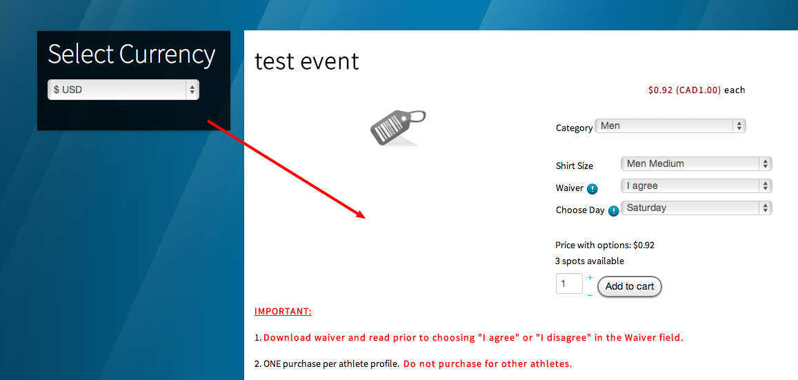

Is there any way to get the currency switcher into the product page as per the screenshot attached?
11 years 11 months ago #155115
Yes, you can use the Joomla tags {loadmodule XX} or {loadposition XX} and put them in the product page by editing the view "product / show_default" via the menu Display > Views.
The easiest way is to set an undefined position to your currency switcher module and use the loadposition tag with the previously specified position.
