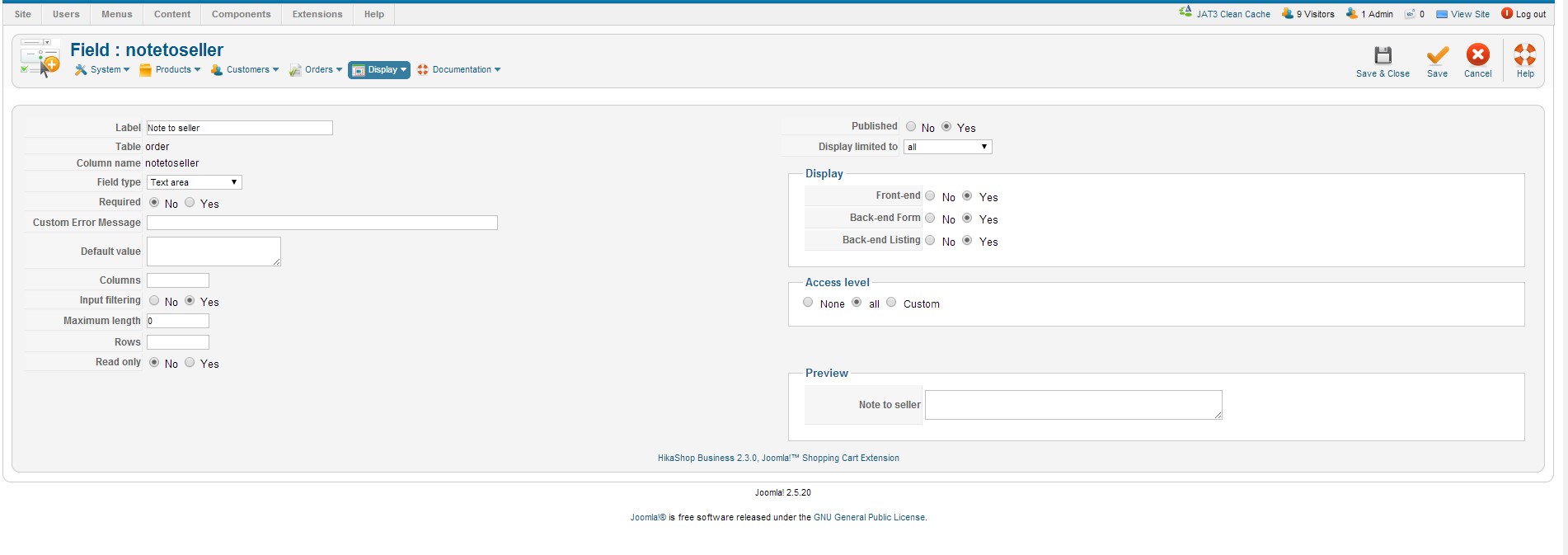

But a simpler method, which would work with any payment method, would be to create a custom field of the table "order" and of the type "textarea" via the menu Display>Custom fields. That would allow your users to add a note during the checkout and it would automatically be attached to the order, the email notifications etc.

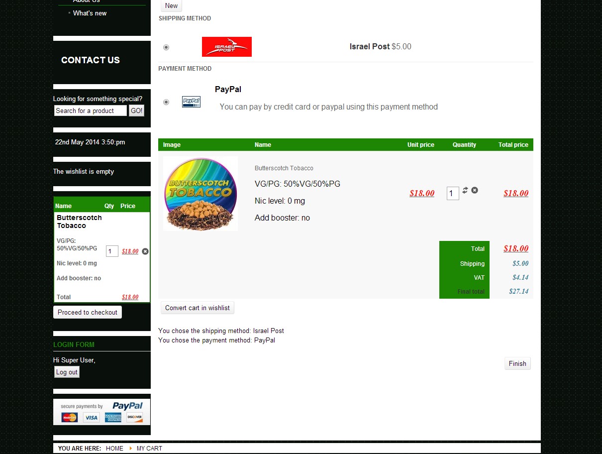

Ok, I made this but I can't see it in check out. Something I missed?
See attachments.
11 years 11 months ago #156964
Thanks to add the "field" step in your checkout workflow via Configuration > Checkout
