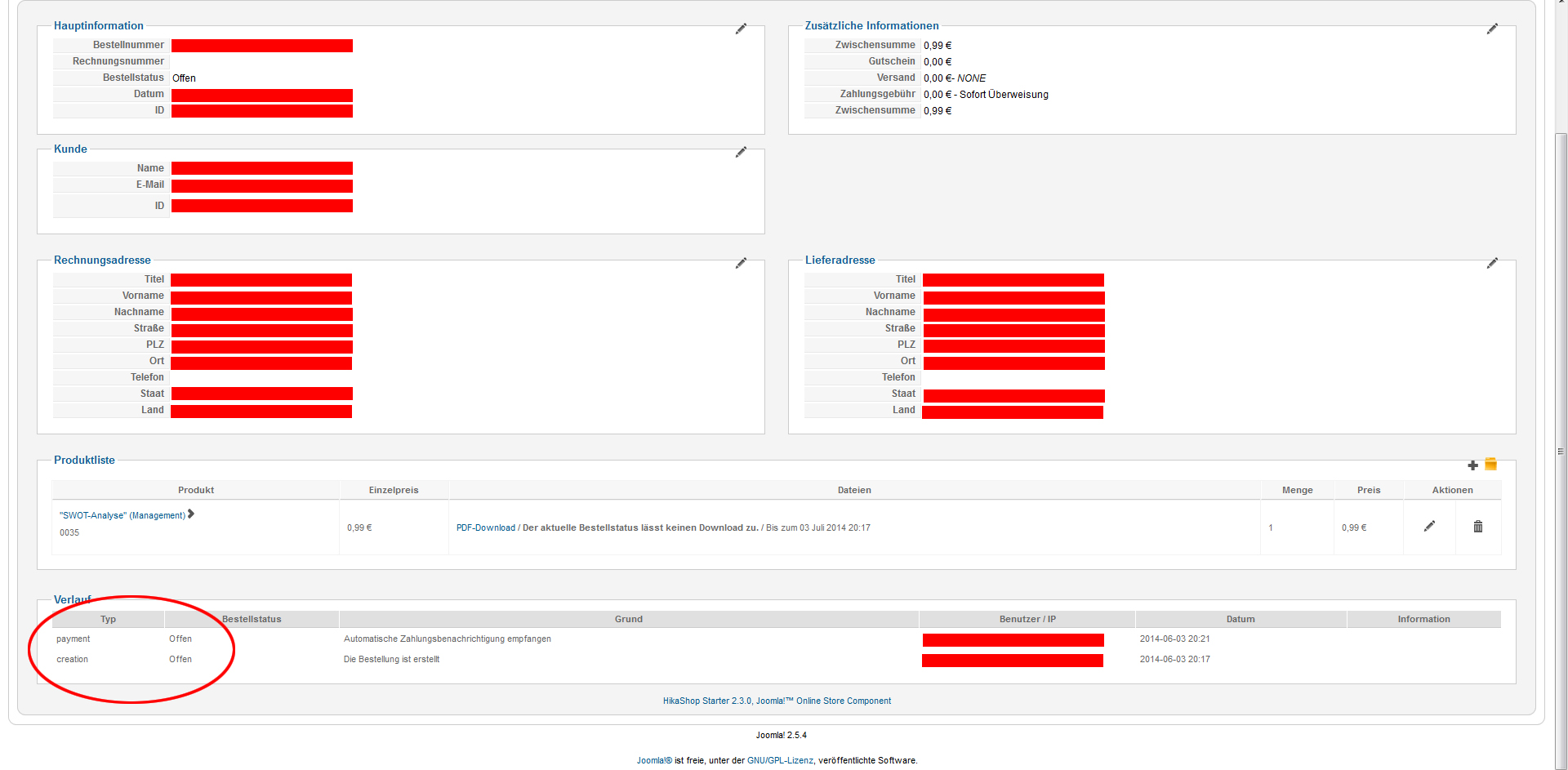

I have a problem with the order status of payments made via sofort.com in a clients shop.
The shop works fine, payment works, just, the status of the order in the orders list shows "offen" (open, the selected status for pending orders).
I aspected the status to change to "bazahlt", means payed, the selected status for confermed orders.
At SOFORT.com they tell me, the show was asking for confirmation and their system confirmed.
Can I check somewhere in HikaShop if the status is realy confirmed?
And if so, why is there a wrong status set?

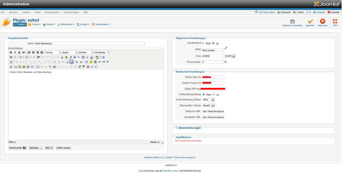

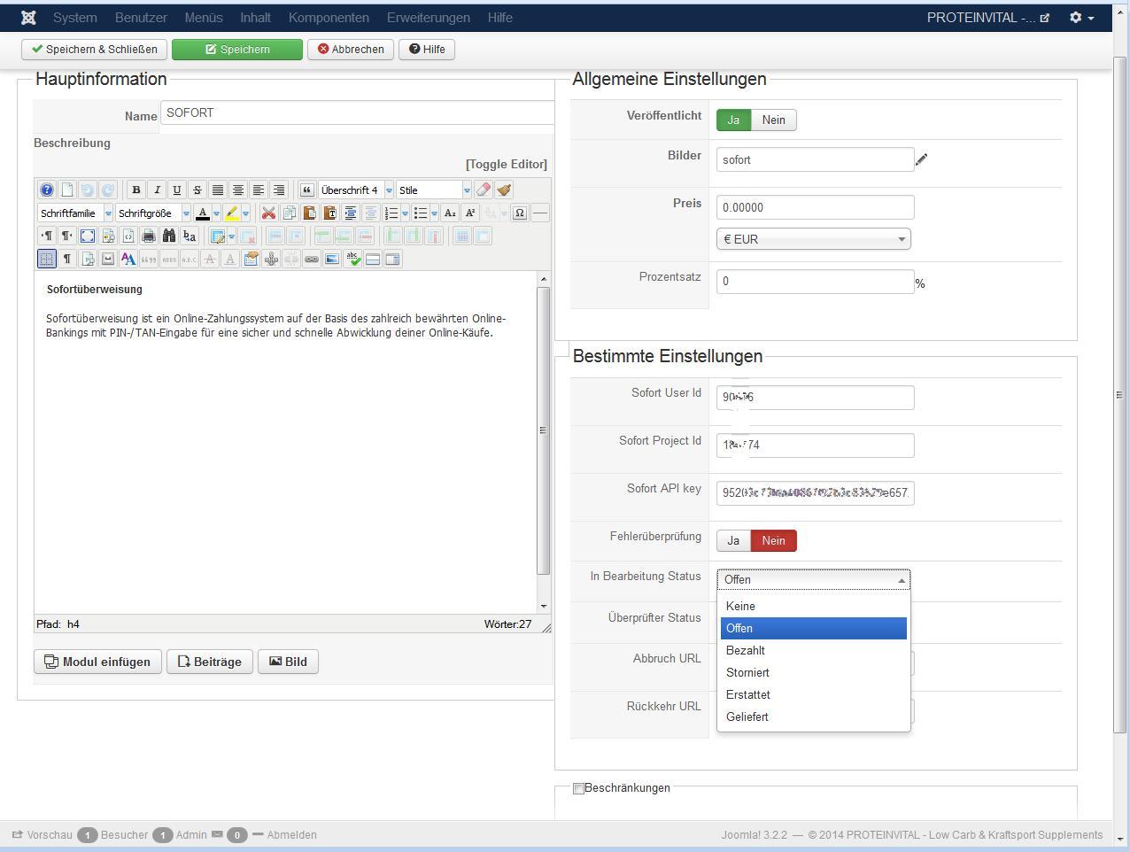

12 years 2 months ago #158388
Hello Oliver,
Can you show me through some screenshots how did you configured your "Sofort" payment method ?
  • Posts: 9

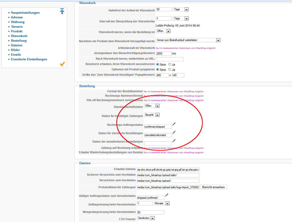

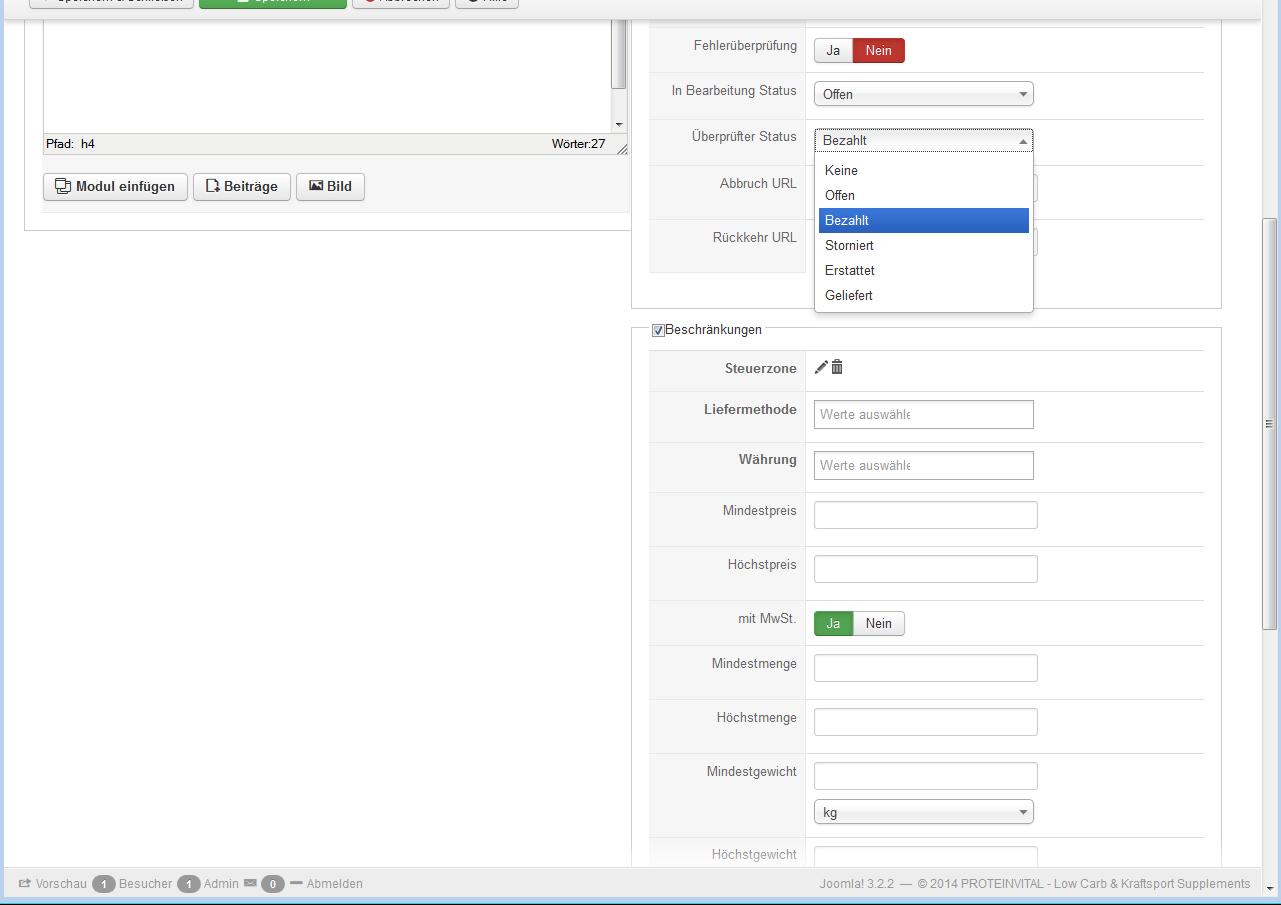

12 years 2 months ago #158570
Hi Mohamed,
there are two screenshots from both status settings. no restrictions selected.
thanx
oliver

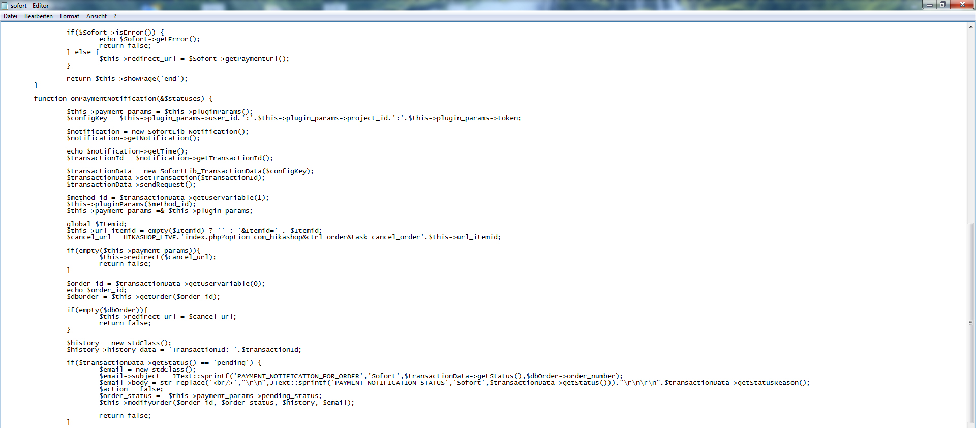

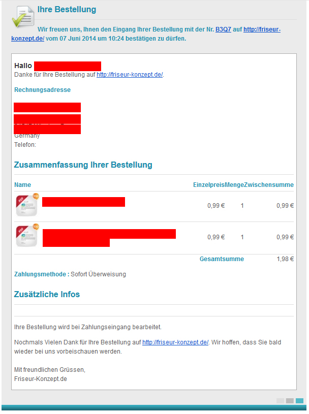

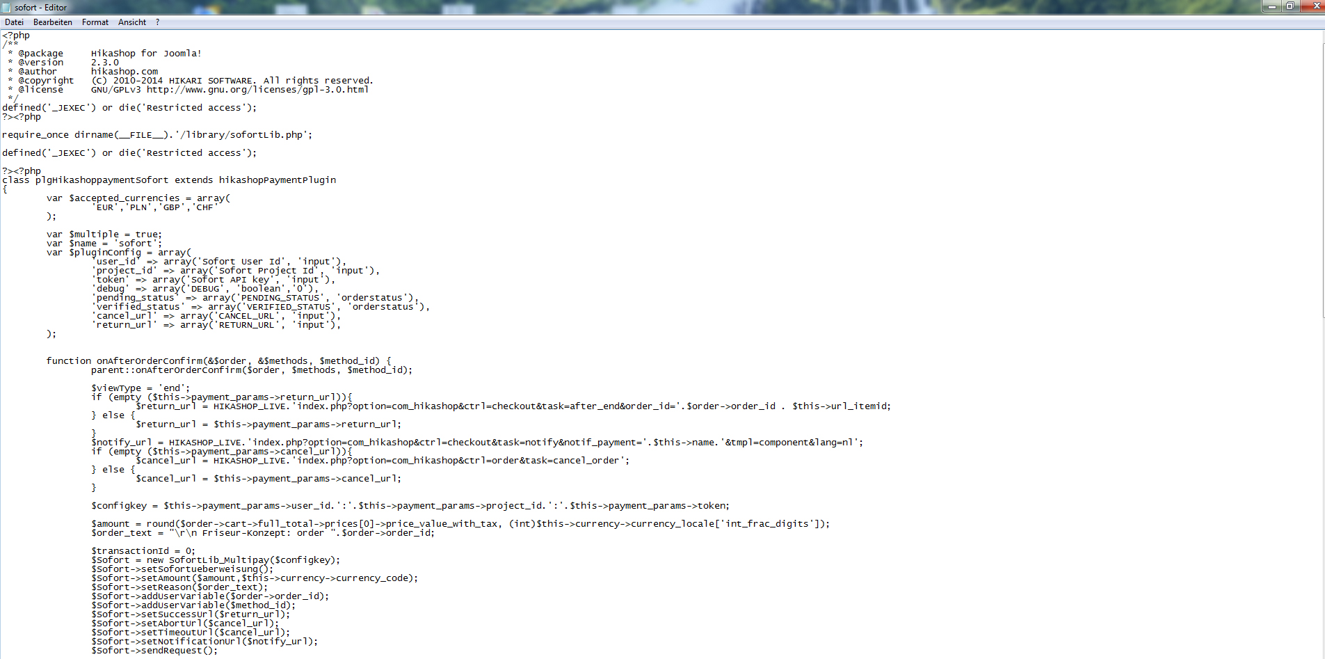

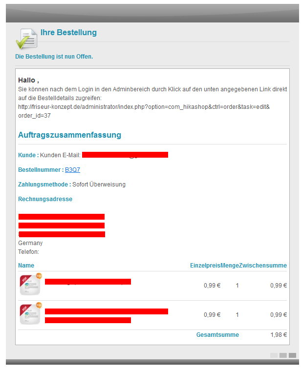

  • Posts: 11
12 years 2 months ago #159294
thanks niclas for your support, but unfortunatelly it is still not working.
Here ist the only email which the admin receives:
Here is the only email which the client receives:
Here is the code of Sofort.php in the file plugins/hikashoppayment/sofort/sofort.php
Thanks for your help.

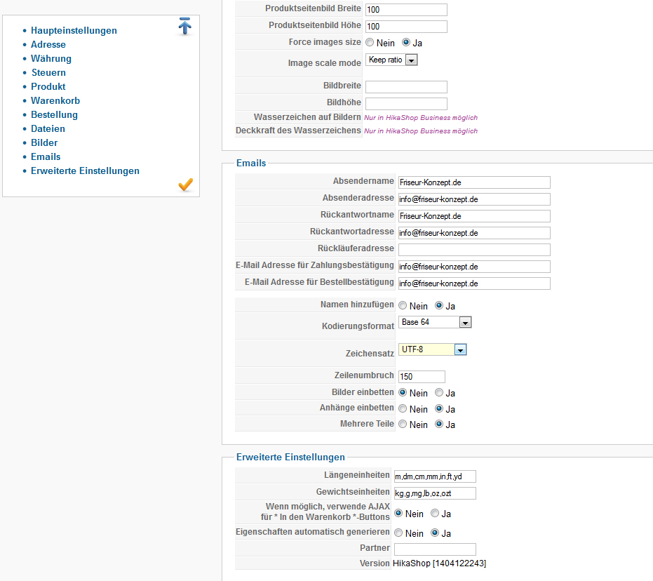

Normally, you should receive also a payment notification email with information on the payment notification.
If you don't receive it, it means that you probably have the "payment notification email address field of the Emails section of the configuration empty. Please enter there your email address and try again.
  • Posts: 11
12 years 2 months ago #159342
I thin it was correct.
looks correct?!

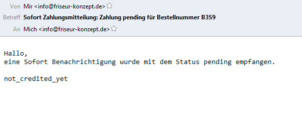

  • Posts: 11

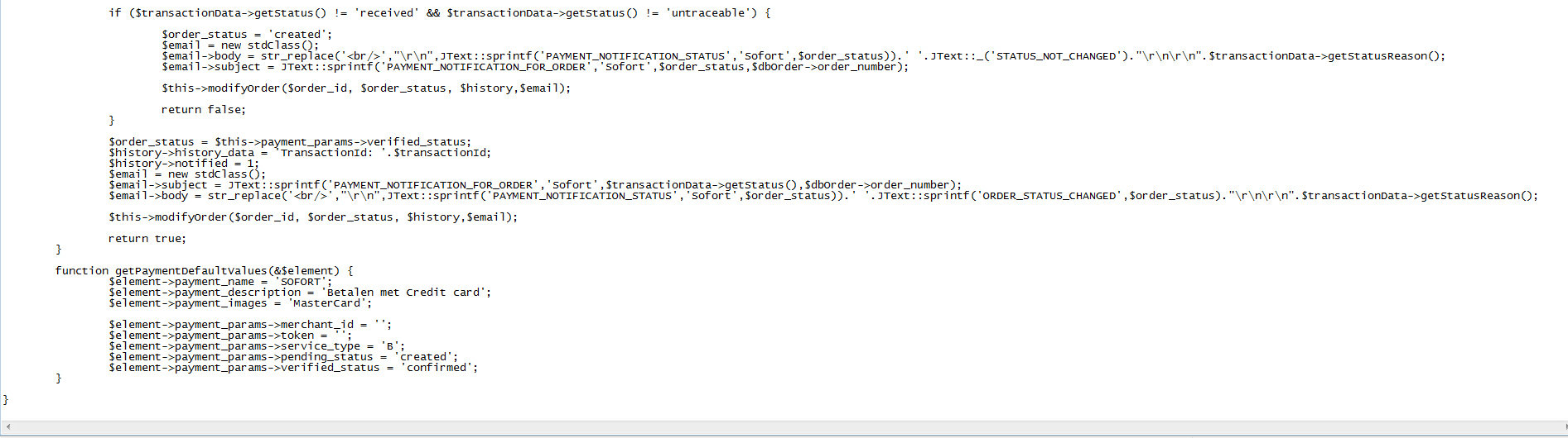

12 years 1 month ago #159736
Totally missed to say that the admin gets this email aswell (when the payment is done):
I guess the problem here:
		$history = new stdClass();
		$history->history_data = 'TransactionId: '.$transactionId;
		if($transactionData->getStatus() == 'pending') {
			$email = new stdClass();
			$email->subject = JText::sprintf('PAYMENT_NOTIFICATION_FOR_ORDER','Sofort',$transactionData->getStatus(),$dbOrder->order_number);
			$email->body = str_replace('<br/>',"\r\n",JText::sprintf('PAYMENT_NOTIFICATION_STATUS','Sofort',$transactionData->getStatus()))."\r\n\r\n".$transactionData->getStatusReason();
			$action = false;
			$order_status =  $this->payment_params->pending_status;
			$this->modifyOrder($order_id, $order_status, $history, $email);
			return false;
		if ($transactionData->getStatus() != 'received' && $transactionData->getStatus() != 'untraceable') {
			$order_status = 'created';
			$email->body = str_replace('<br/>',"\r\n",JText::sprintf('PAYMENT_NOTIFICATION_STATUS','Sofort',$order_status)).' '.JText::_('STATUS_NOT_CHANGED')."\r\n\r\n".$transactionData->getStatusReason();
		 	$email->subject = JText::sprintf('PAYMENT_NOTIFICATION_FOR_ORDER','Sofort',$order_status,$dbOrder->order_number);
			$this->modifyOrder($order_id, $order_status, $history,$email);
			return false;
		$order_status = $this->payment_params->verified_status;
		$history->notified = 1;
		$email->body = str_replace('<br/>',"\r\n",JText::sprintf('PAYMENT_NOTIFICATION_STATUS','Sofort',$order_status)).' '.JText::sprintf('ORDER_STATUS_CHANGED',$order_status)."\r\n\r\n".$transactionData->getStatusReason();
		return true;
	function getPaymentDefaultValues(&$element) {
		$element->payment_name = 'SOFORT';
		$element->payment_description = 'Betalen met Credit card';
		$element->payment_images = 'MasterCard';
		$element->payment_params->merchant_id = '';
		$element->payment_params->token = '';
		$element->payment_params->service_type = 'B';
		$element->payment_params->pending_status = 'created';
		$element->payment_params->verified_status = 'confirmed';
