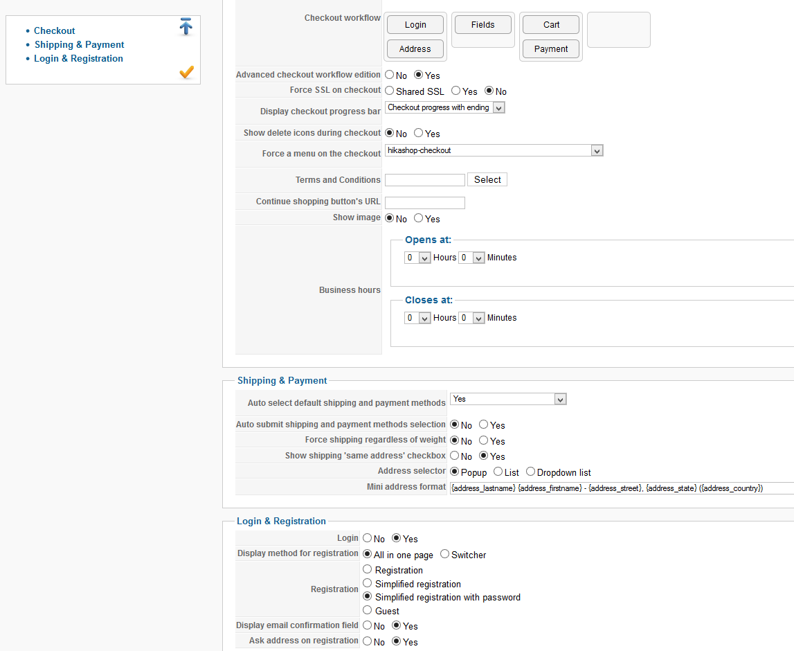

Could you start by providing a link to the shop and a screenshot of the options of the Checkout tab of the configuration so that we can analyze a bit what's going on ?
  • Posts: 9

Try to turn on the "auto submit shipping and payment methods selection" option of the configuration and see if that helps.

Tried to turn on the auto submit, this causes a slightly different problem:
You can not change between the two options available but one of them will go through to the payment portal.
