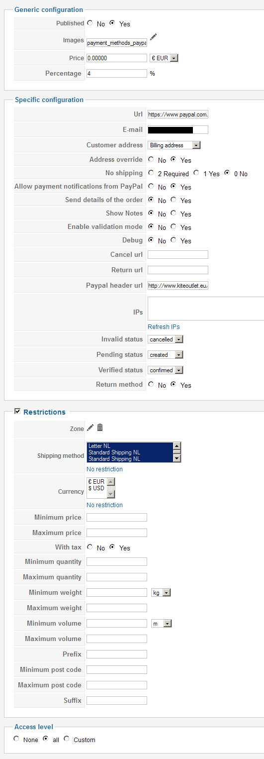

Since a few weeks for every Paypal payments that is made on my clients website I receive the following error message by email:
Paypal payment notification refused:invalid transaction
A paypal notification was refused because it could not be verified by the paypal server
Check the documentation concerning this issue at www.hikashop.com/index.php?option=com_up...pal-error#invalidtnx
This notification was for the order ######## on the website XXXXXXXXXXXXXX
You can access the order details directly by clicking on the link below after logging in your back end:
The Paypal payment does get through and money is received, but the orders are no longer set to the confirmed status automatically anymore.
I have attached a screenshot of the settings in the Hikashop Paypal plugin.
Could you please advice me in how to fix this?
Kind regards,
Chris

11 years 11 months ago #168144
Hi Xavier,
Thank you for your quick reply.
The documentation for this error does not give much helpful information. It just stated that notifications are checked to see if they originated from a known Paypal server, and that if they are not the message can be ignored. The problem is that the message should come from a Paypal server since they are the direct result of a paypal payment.
Clicking "See the Report" under Configuration > Main > Files gives me the message "The log file is empty".
Kind regards,
Chris

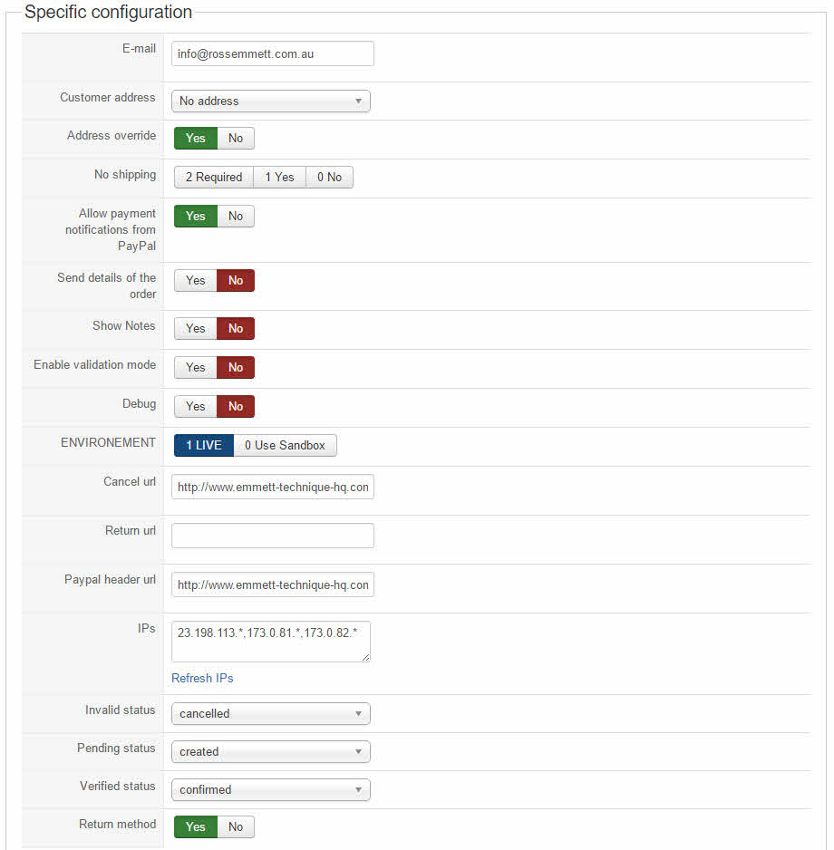

  • Posts: 64
10 years 3 months ago #238157
Hi, I am having this exact same problem, I have I tried the last fix that Foxworks says is ' I don't think this is ideal' and it seems to work.
Is it good to use this fix? have there been any other forum fixes other that this one?
HikaShop: v.2.5.0
Joomla: v.3.4.3
10 years 3 months ago #238222
Can you give us more elements, please check together these points :
- Do you have already use the Paypal plugin before ?
- If yes : do you note an evenement around this plugin issue ? Joomla or HikaShop Updates ?
does your plugins is updated ?
- Do you process some tests with debug mode ON ?
- Do you have some data in your log file ?
- Do you check sales data on your Paypal settings page ?
Note that the Paypal plugin was recently updated in order to follow new Paypal payment gateway standards.
Awaiting news from you.
Regards.
Last edit: 10 years 3 months ago by Philip.
  • Posts: 64
10 years 2 months ago #239626
In reply to your questions...
Q: Do you have already use the Paypal plugin before ?
A: yes it was working before the Joomla 3.5.1 update
Q: If yes : do you note an evenement around this plugin issue ? Joomla or HikaShop Updates ?
A: Joomla 3.5.1 update, I have applied the fix on this page and the one here: www.hikashop.com/forum/checkout/883603-4...heckout-process.html
Q: does your plugins is updated ?
A: I am using ( * @version 1.6.7) of the plugin
Q: Do you process some tests with debug mode ON ?
A: yes, what is this suppose to do? I saw no difference in the process and there was no data added to the paypal log file
Q: Do you have some data in your log file ?
A: The log file is empty /home/*********/public_html/media/com_hikashop/upload/safe/logs/report_135237915.log
Q: Do you check sales data on your Paypal settings page ?
A: please see attachment for settings
You said: Note that the Paypal plugin was recently updated in order to follow new Paypal payment gateway standards.
Where do I update this, where do I find the download file?
HikaShop: v.2.5.0
Joomla: v.3.4.3
