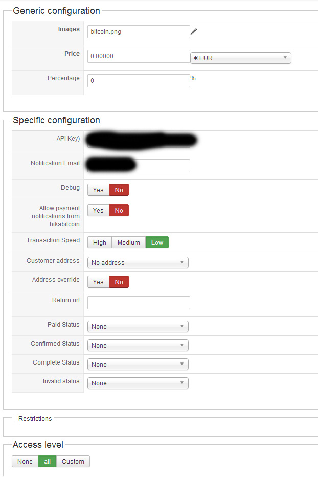

You can see the screenshot attached.

  • Posts: 26380
11 years 10 months ago #172703
Regarding the plugin, there is some code in order to strip the variables so I think the error message is there because the variable is empty.
Please edit the plugin and replace
			if(isset($options[$k])){
				$options[$k] = substr($options[$k], 0, 100);
By
				if(empty($options[$k]))
					unset($options[$k]);
It will unset the options while empty.
I hope it will fix the issue.

  • Posts: 26380
11 years 10 months ago #172785
Without knowing the incriminated field or more details about your configuration, I am sorry but no.
We did not developed the plugin, we are not able to reproduce your problem.
