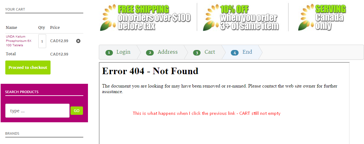

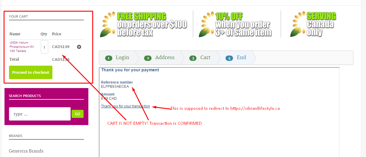

I have set up PayPal Advanced to work in a n iframe at checkout. It works: the customers can pay; get the summary of transaction, BUT when they click the link "Return to Site" I get a Error 404 in the iframe and the cart is not emptied at that time (or maybe it is but the page will not refresh).

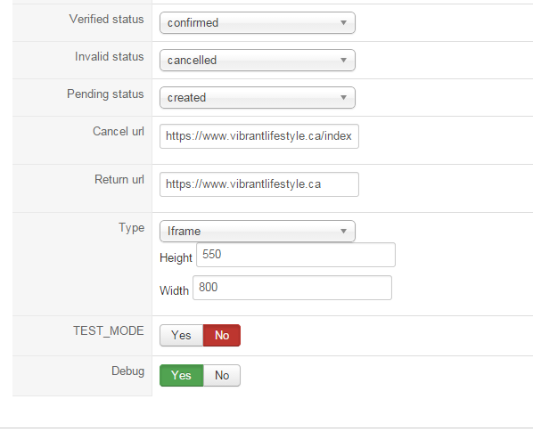

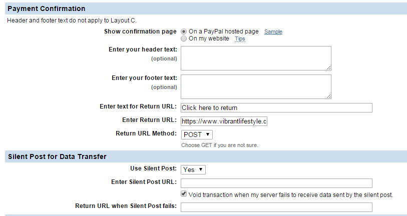

In PayPay Manager interface I set up the return page to be my homepage and in the config for the payment plugin I set the same.

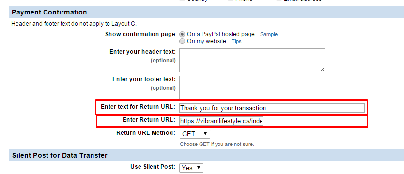

  • Posts: 18
11 years 8 months ago #182217
I have attached the image with the link i setup in //manager.paypal.com (for PayPal Advanced)

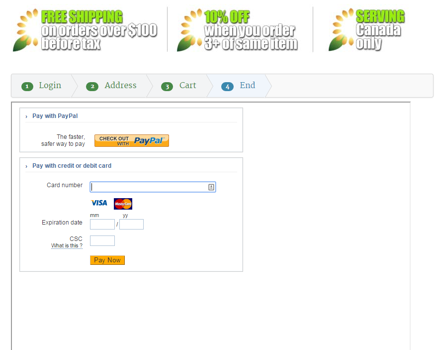

Here's what happens at the time of transaction:

The page in your website is not refreshed ; I really don't see how it would be possible to refresh and empty the cart dynamically. The only solution is that the iframe open a thank you page which will redirect/refresh the parent to a confirm page.

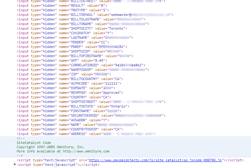

As Jerome said, We would need to know the URL that generate the 404 error to be able to better understand what's going on on your website. Please use your browser's developer tool to look at the href attribute of the "go back to the shop" link in the HTML of the page in order to get that URL. This page explains how to look at the HTML of a specific element on pages with your browser:

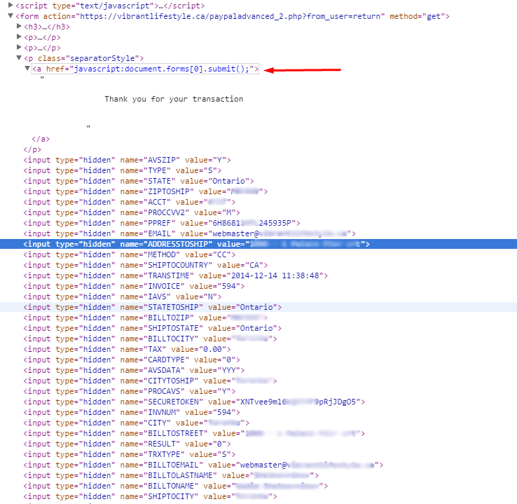

  • Posts: 18
11 years 7 months ago #183288
Here's what I found (this is form a live test):

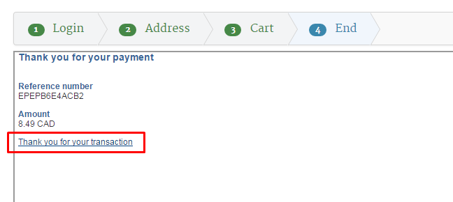

At checkout I get a PayPal Confirmation:
Which should lead me back to a thank you page on my site, which has been setup in both manager.paypal.com and HikaShop plugin
But this is th code that is attached to the "Thank you..." message
  • Posts: 18
11 years 7 months ago #183427
Nicolas, Jeremy,
More info on the subject....
I just got off the phone with PayPal - their integration team testing showed that the code for return URL I set up in their admin settings is being overwritten by an API call from the PayPal Advanced plugin from HikaShop.... and according to them that is what is causing that unpleasant URL and Error 404 message.
11 years 6 months ago #187472
So do you have solved you issue ? Removing the return url in the plugin settings and let Paypal manage the return url was the solution ?
