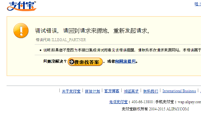

-- Joomla version -- : 3.3.6
-- PHP version -- : 5.3.28
-- Error-message(debug-mod must be tuned on) -- : Alipay Payment method configured but giving error message as "ILLEGAL PARTNER" on Alipay page

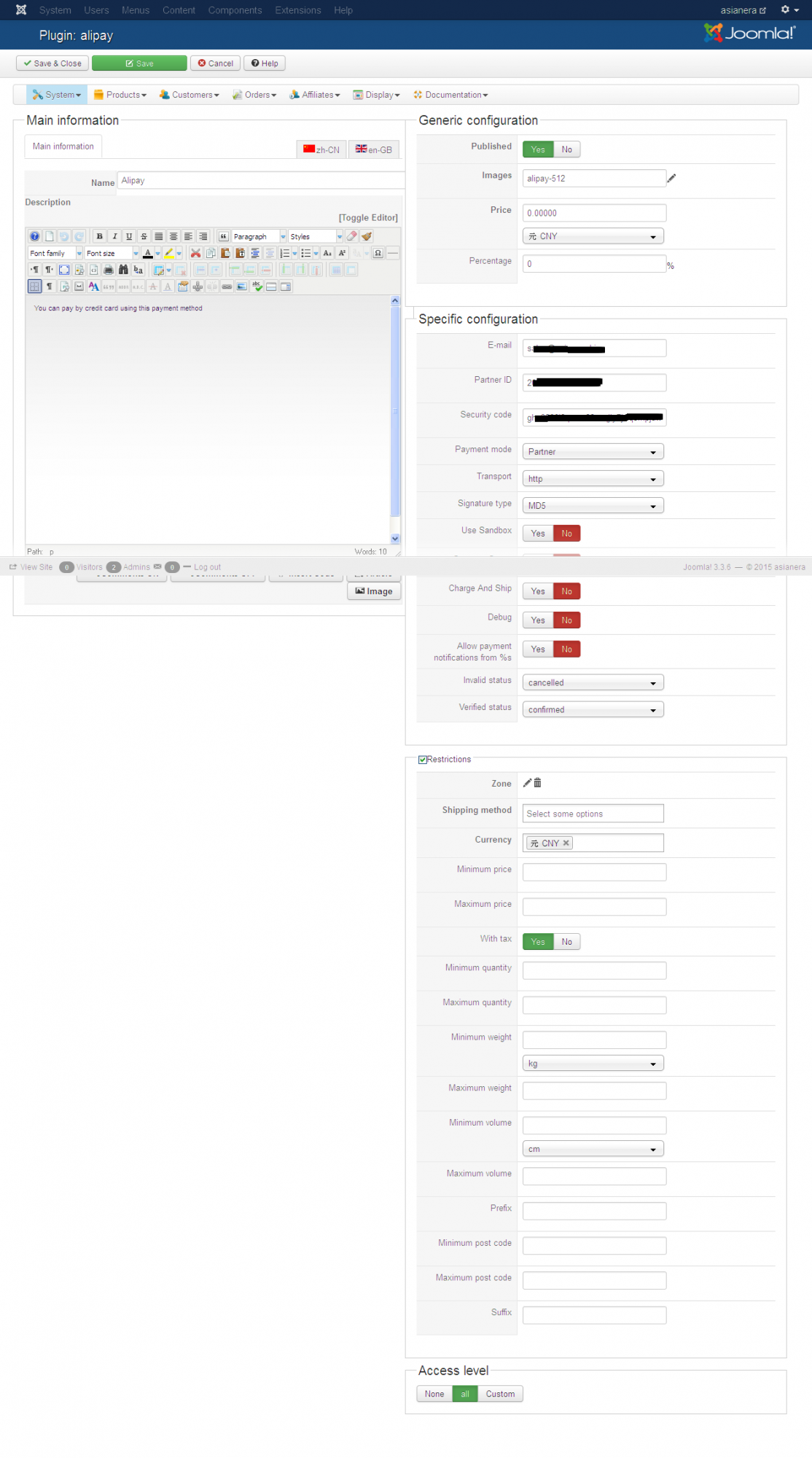

Can you show me how did you configured your Alipay payment method through some screenshots ?

11 years 5 months ago #191236
Please find the attached image showing Alipay configuration .
Jag
11 years 5 months ago #191288
The alipay payment method can't handle the "partner" mode for the moment, you should use the "direct" mode.

11 years 5 months ago #191415
That means , clinet has to get new API credentials for direct method..? Then "Direct Mode" should be selected from dropdown option..?

11 years 5 months ago #191438
Yes :).

11 years 5 months ago #192220
Can you test it with the "Payment mode" of your Alipay payment method set to "Direct" ?

10 years 9 months ago #218920
Client has got ICP licence for their website, Alipay is configured to use "Direct Method" but still we get error message as ILLEGAL PARTNER when checkout is redirected to Alipay Website
Please advise
