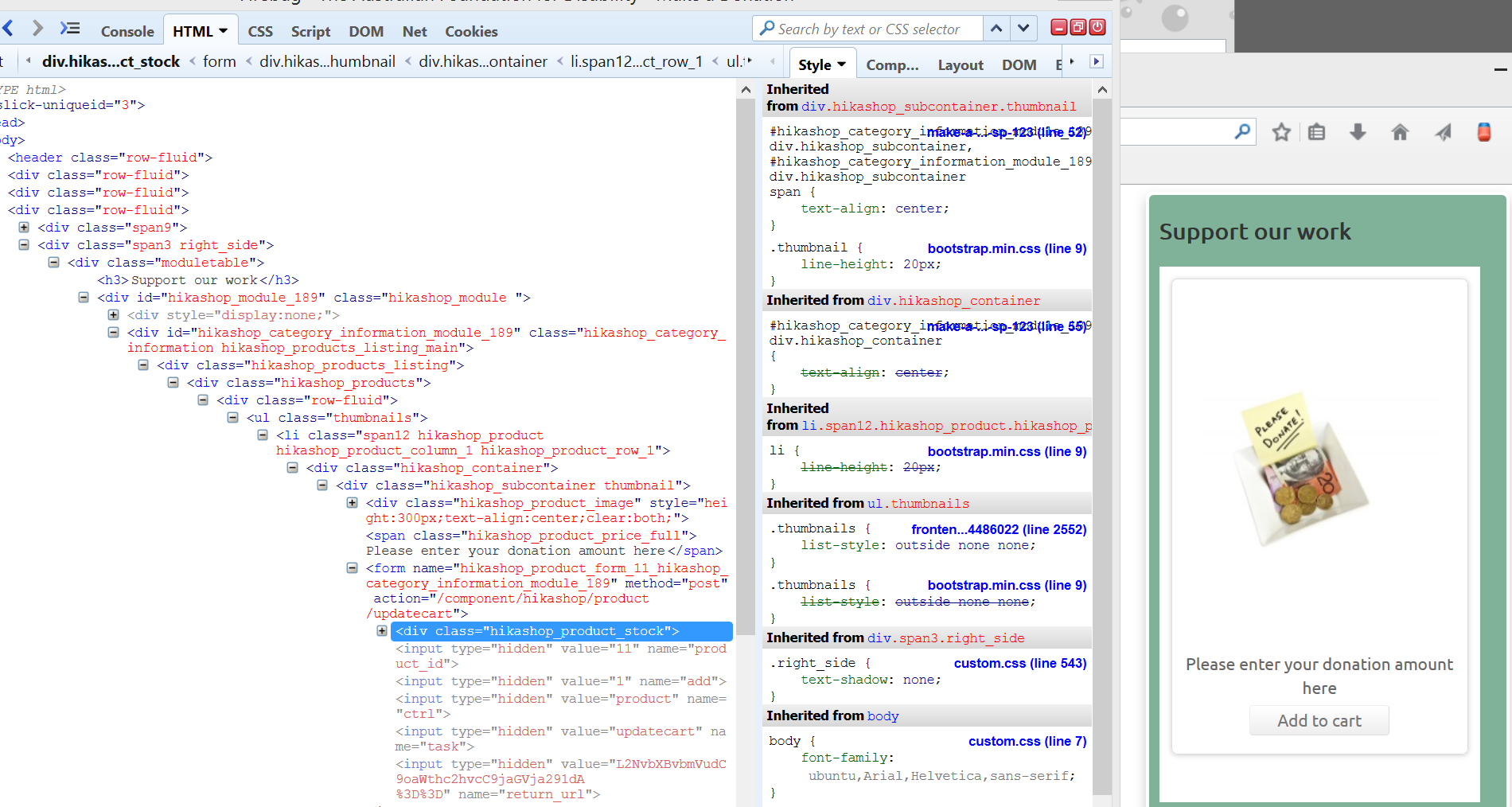

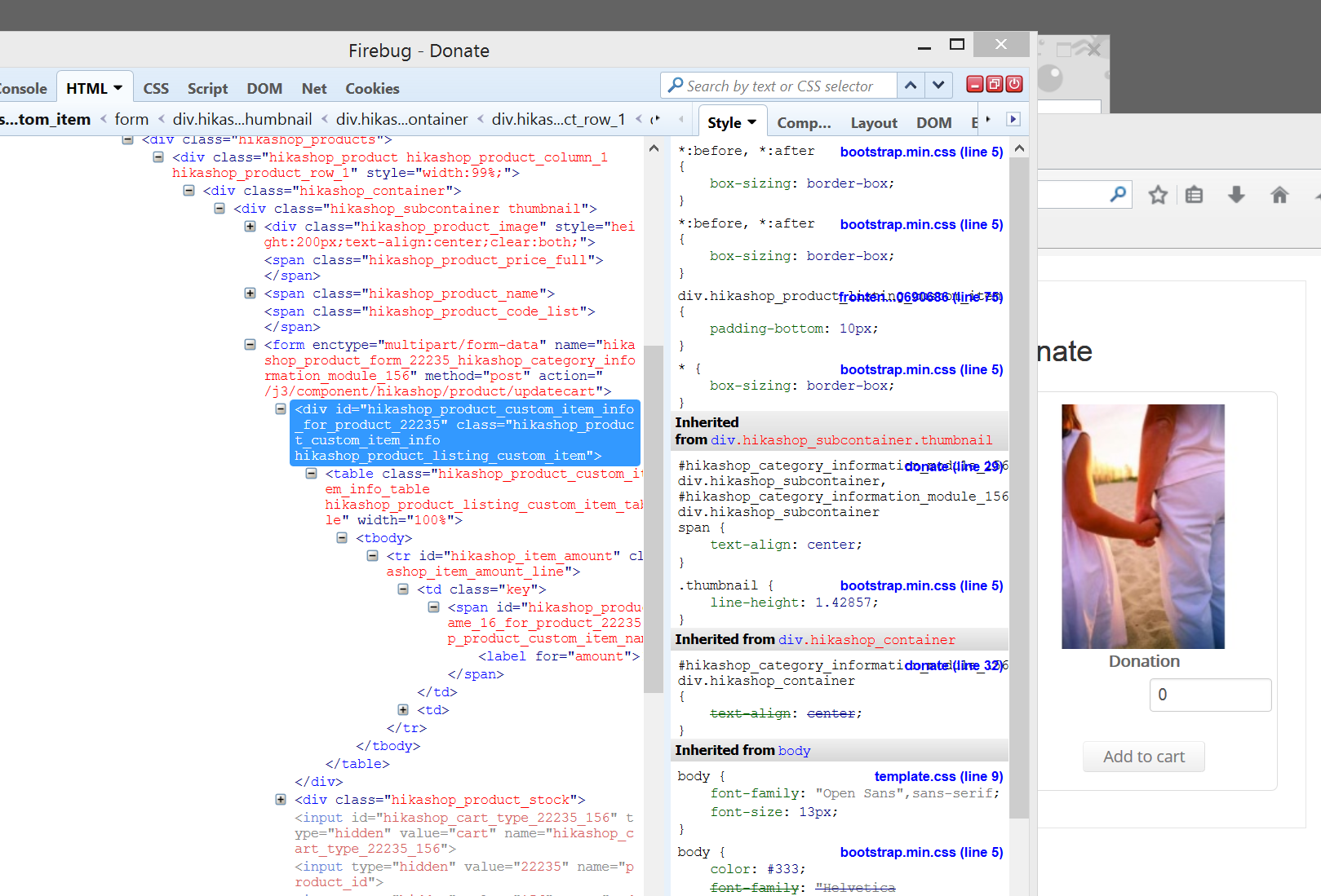

-- Error-message(debug-mod must be tuned on) -- : Quantity field on 'Add to cart' button and Display custom item fields not effected by setings on module
I have successfully set up donate feature on another website www.scfa.edu.au/j3/donate but on the site I am working on afford.com.au/support-our-work/make-a-donation-sp-123 I cannot get the quanity and display custom fields to be effected by the setting of the module.
Any suggestions apprietiated

11 years 5 months ago #191389
this is the problem page.
in the example page the custom code allows the user to enter the amount and go directly to the cart. The Hika setting for this modulke are not responding in the problem site as they are in the parallel site

  • Posts: 59
11 years 5 months ago #191418
I am still not getting the custom code to show in the product module...
afford.com.au/hikashop-menu-for-module-1...uct/11-make-donation
I have update all apps and joomla to curent ver in case there was a conflict but no luck

  • Posts: 59
11 years 5 months ago #191533
sorry. i might have been very tired. lets try again. thanks for your patience.. here is the problem module on the right columb.
the custom field are not appearing on hika product module dispite being selected on the module setting tabes.
the custom field shoes perfect in the product page, but wanted users to input the ammount in the module a go strait to the payment.
i manages this in another hika site last week, www.scfa.edu.au/j3/donate
the main difference is that the custom code is not appearing in the probem donate module code ar all. i have just transfered afford.com.au from starter to busines and up graded to the latest update if that helps.

  • Posts: 59
11 years 5 months ago #191537
i have also found that the custom amount showes in the right module whe module display set to table or list.. just not when div
  • Posts: 26380
11 years 5 months ago #191565
In the page "support our work", the module used is the module with ID 189
You should check the configuration of that module (in HikaShop > Display > Content module) to have same options for the module with ID "156" in the second website (the "donate" page).
Like you have already mentioned, the problem is for what I see, more related to the setting which allow to display the custom item fields.
But with your different screenshots, it's difficult to know which module your displaying (from which website and for which ID).

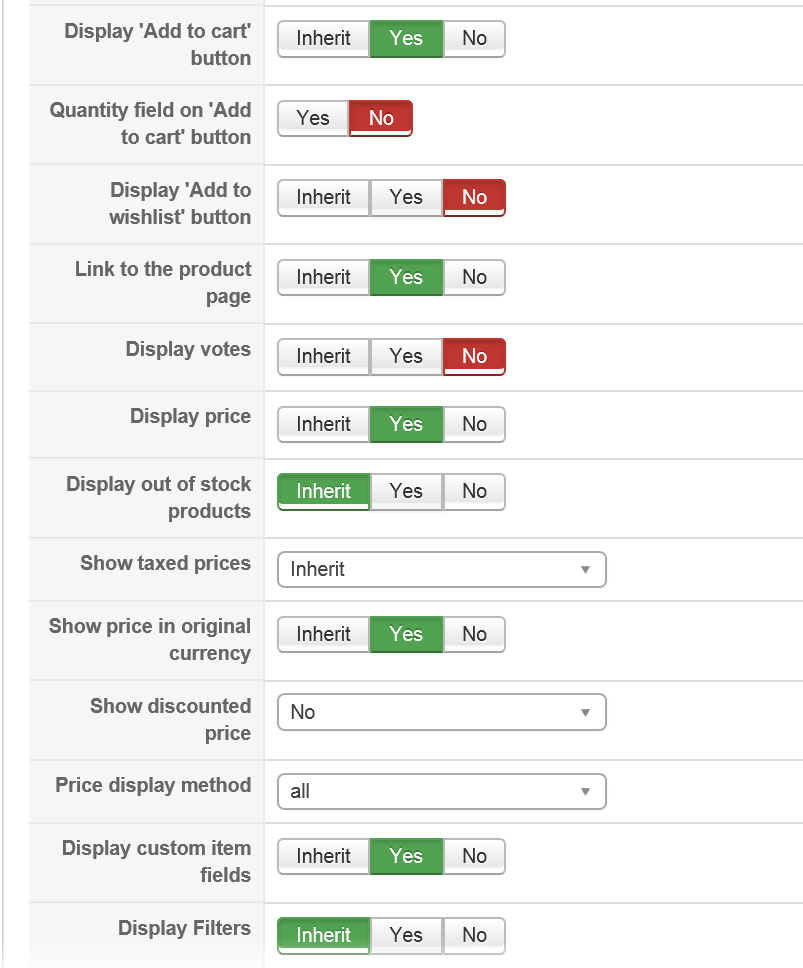

  • Posts: 59
11 years 5 months ago #191633
I have set all the module setting exactly the same, that is quite simple. When set to active, the donation shot shows the table with the custom inserted correctly.
In the second screen grab you can see the support module screen grab showing that dispute having custom code is active in the module settings. It is not showing in the module. I know it is working since it is on the product page.
