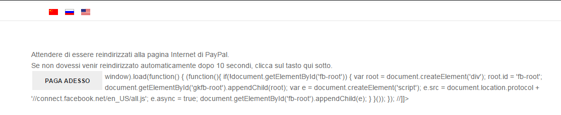

I have tested the paypal plugin on the sandbox.
I have this problem (see image)
If I go on, the order is placed, but I would like to get rid of the error.

That code issue looks like another extension replacing the HikaShop code there with its own code.
Did you configure any facebook related extension on your website ? If you disable it, does that fix the issue ?
Wheny ou find which extension creates the problem, contact their developer so that they can add an additional check in their code to not replace the HikaShop code.

So if you don't have any facebook related extension on your website, where does that facebook code comes from ?

sorry it was a plugin automatically enabled in the template.
it is the joomla facebook authentication plugin.
I disabled it and the problem disappeared.
Anyway, in case I want to use that, how can this conflict be solved?

If it's something coming from your Joomla template, you'll have to contact your template provider so that they can fix the code of the template in order to not replace code on that page of your website.
