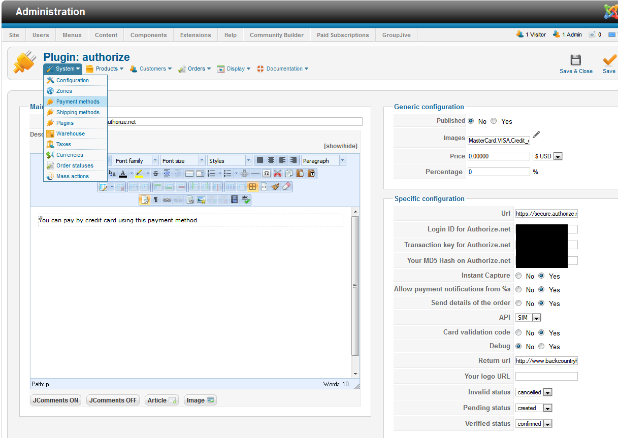

I'm attaching a screen capture of the AN Plugin page - perhaps I've set it up wrong?

Your Authorize.net seems to be correctly configured, can you :
- Check that the debug mode option is ON through your Authorize.net payment configuration page
- Test it again
- Show me your Payment log file content.
