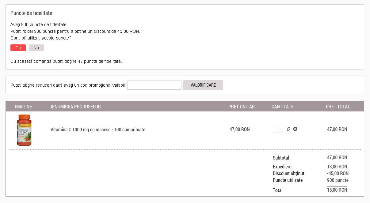

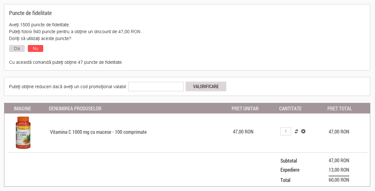

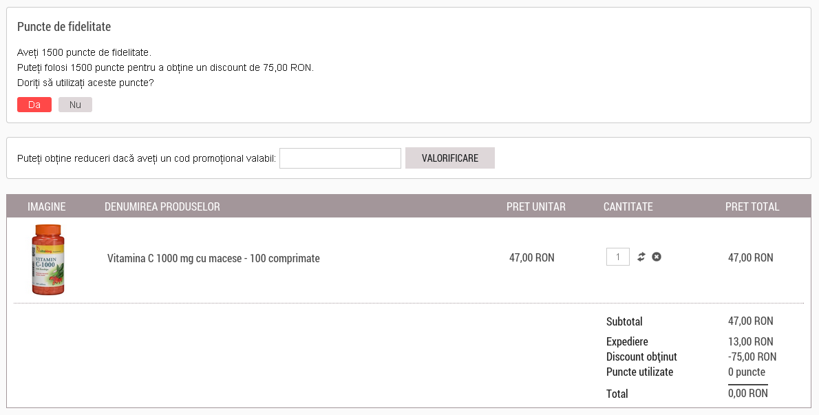

I want to upgrade our shop to 2.4 to use the newly implemented caching, but unfortunately there is some strange problem with the pay with points plugin. If the user has more points than necessary to pay for the current order, then the plugin tries to substract again a different sum after selecting the "Yes" option. I have attached 3 screenshots.
On the first one, when the customer doesn't have enough points to pay the total, the plugin works as expected. It substracts some value from the order and displays the result.
On the second one the customer has more points than necessary, and he has the option to pay with points for the current order ( he can not pay for the shipment ). The calculations are correct until this point.
On the third one however, after selecting the "Yes" option the plugin displays a different scenario for the same order, and also miscalculates the final total. It looks like the plugin adds the discount to the order and then offers a different amount of points to use. In our example before selecting the "Yes" option we had 940 points to use for 47 Ron, and after selecting the "Yes" option we have 1500 points for 75 Ron....

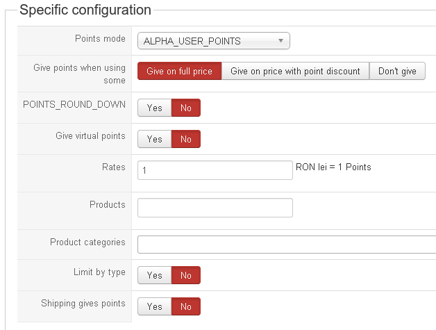

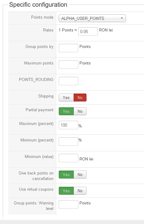

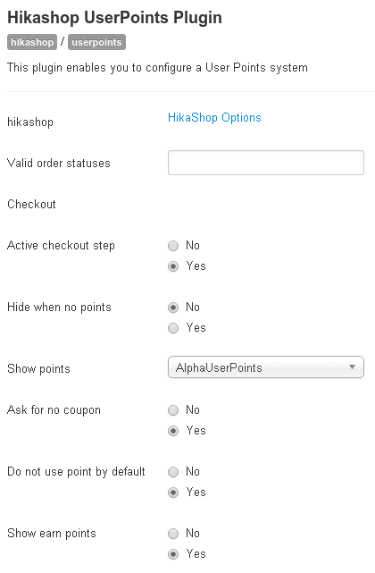

Dear Jerome,
Thank you for your reply. Here they are:
