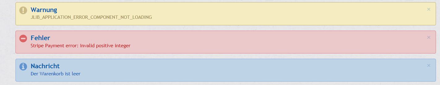

I have installed the Stripe Payment plugin, and it seems to work until the actual payment.
It returns two errors:
WARNING: JLIB_APPLICATION_ERROR_COMPONENT_NOT_LOADING
Stripe Payment error: Invalid positive integer (see attachment)
I have updated the API keys, I am in live mode, and I checked all data. I have used my own Credit Card to check but it failed.
I have checked my Stripe account using a different e-commerce solution, and it worked. So it must be something between Stripe and Hikashop.
Any idea?
Thanks,
Chris

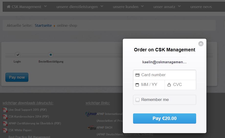

  • Posts: 29
11 years 4 months ago #195524
I have investigated further.
When I go into the Stripe log, I find this:
card: "tok_15hzqkBUmq3ZYDEfkah1F8MO"
amount: "0"
currency: "EUR"
This basically tells, me that Stripe received a payment request of EUR 0. This would exlplain the error.
However, in the payment process, the popup from the Stripe payment plugin says "Pay EUR 20" (see screenshot attached).
No idea where the payment amount gets lost between Hikashop and Stripe...

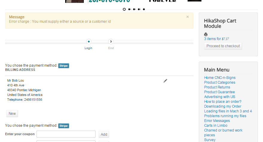

  • Posts: 17
11 years 4 months ago #195771
I am getting errors but it looks like an ID issue with Hikashop. Joomla and Hikashop both are latest versions. Just trying to give my customers more options to get more sales.
  • Posts: 26378
11 years 4 months ago #195775
The issue is not related to HikaShop but to the configuration of the plugin.
The error message is not provided by HikaShop or by our plugin ; the Stripe API return us the error message and the plugin display it.
That's why you can find the error message over the Internet:
stackoverflow.com/questions/27461021/str...stomer-id-using-lara
It looks like your secret key is invalid.
  • Posts: 17
11 years 4 months ago #196163
PHP bindings have been updated to latest version by stripe, they have also changed the way they handle API's.
They did make some changes to their API, and you now pass tokens upon charge or customer creation as 'source' instead of 'card.
That information came from Stripe directly. Could this be why tokens are not being sent?
  • Posts: 26378
11 years 4 months ago #196173
Marvelous,
Now the payment gateway are breaking the compatibility ; I think I have to renew my prozac prescription.
If I understand it right, the best is to update the stripe API using the version 1.18.0 which should continue to work according to the readme of the v2
If you are using PHP 5.2, you can download v1.18.0 (zip, tar.gz) from our releases page.
This version will continue to work with new versions of the Stripe API for all common uses.
github.com/stripe/stripe-php/tree/v1.18.0
I don't know what is the current version of the library in the Stripe HikaShop plugin but it's not the 1.18.0 for sure.
  • Posts: 85988
  • Thank you received: 14154
11 years 4 months ago #196205
I've looked around for information regarding that and yes they did change that parameter with their recent API changes.
However, from what I could read from their documentation, and from what someone from Stripe support wrote here groups.google.com/a/lists.stripe.com/for...-discuss/-jURiizLOiU if you use an old library (which the HikaShop plugin do, it will use the old API and thus the old parameter "card" should be used in that case, as it was when the plugin was developed).
So I still believe that the issue is with your payment method settings, and not with the plugin, specially since others using the plugin are able to use it without changing anything in the code. So I strongly recommend you to check the issue with the Stripe support to make sure that you've setup the payment method properly.
