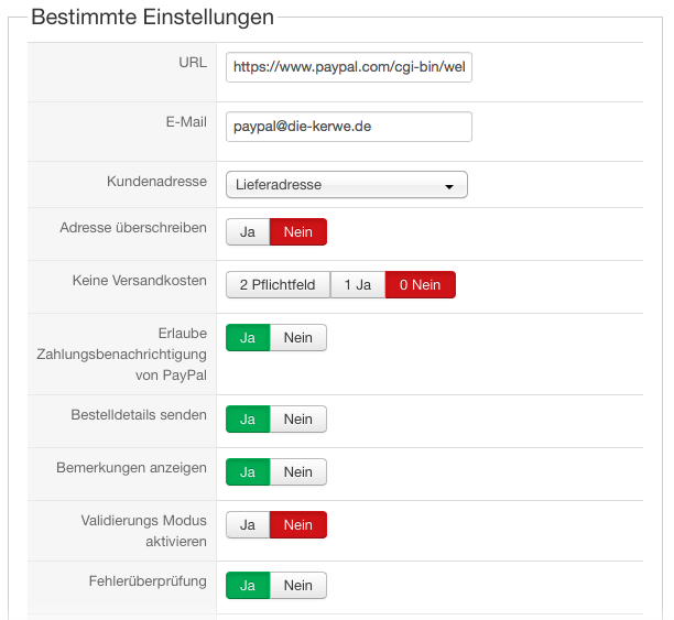

Hello community,
I have the same problem as a few others in the past: My PayPal plugin isn't working correctly as I don't receive any notifications from PayPal after a completed transaction (report_xxxxx.log is empty).
This is my configuration of the plugin:
Url: www.paypal.com/cgi-bin/webscr
Email: This email address is being protected from spambots. You need JavaScript enabled to view it.
Customer address: No address
Address override: No
No shipping: No
Allow payment notifications from PayPal: Yes
Send details: Yes
Show notes: Yes
Validation mode: No
Debug: Yes
Return method: Tried Yes and No
  • My report.log file didn't exist until I created it manually with the file name of the components configuration. According to Joomlas system information the file should be writable.
  • I used real transactions and NOT the sandbox mode.
  • My site is running in German only.
  • I also tried a return URL and var_dumped $_POST and $_GET and both were empty arrays
I think that this was all I did.
Does anyone have an idea what else I could do or what the problem might be?
Many thanks in advance for any help!
Best regards
Stefan

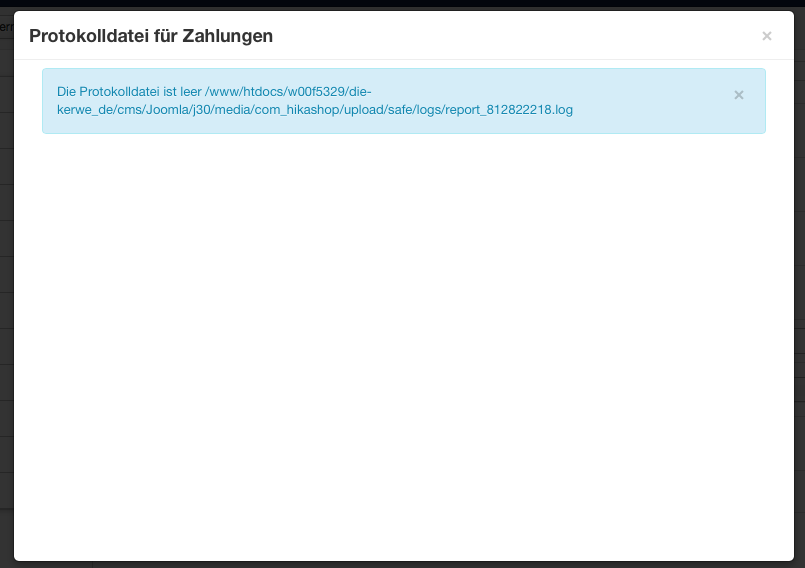

Sorry, I get used to screenshots for this kind of thing.
The HikaShop payment log is only available from the HikaShop configuration backend, it has a very specific name and the folder where this file is stored by default is not managed or listed in the Joomla system information screen.
So, I'm afraid that we will need screenshots to be sure what you are currently performing with the HikaShop payment log.

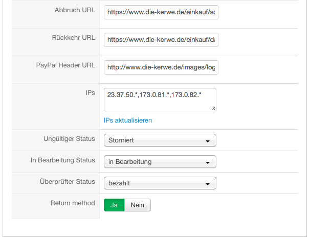

11 years 3 months ago #198229
You're right, I'm sorry! So here are the relating screenshots. Maybe you could add a "Is the report directory / file writable?" feature like Joomlas system information to ensure the permissions are correctly configured?

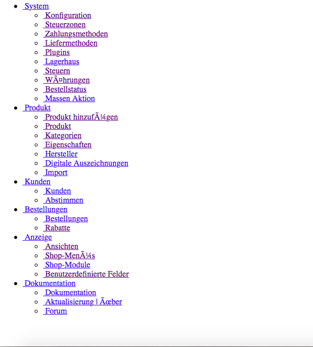

I tried the replacing but no change. Neither was anything written to the file nor did I get any error messages. BUT:
With using this code
function onPaymentConfiguration(&$element) {
$this->writeToLog( 'test' );
I'm getting a almost blank page with the menu of HikaShop so I don't come onto the configuration page of the plugin (see attachment).
So I tried to add the code above into the existing onPaymentConfiguration function but also no change of the report.log file (but at least I came onto the plugins configuration page).
After this I tried to manually write anything to the report.log file (via FTP) and view it via "configuration/files/view report" and it was still empty. Even after commenting out "deny from all" just to be sure it's not due to access restriction.
  • Posts: 26380
11 years 3 months ago #198433
You should have a PHP fatal error ; please check your PHP error log.
You can also set the "error reporting level" to "maximum" in your Joomla global configuration.
