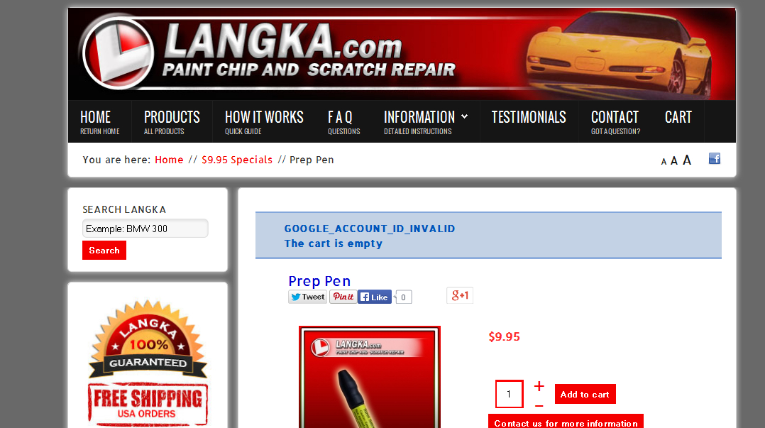

3) Several customers have told me they are getting an "google_account_id_invalid" error (See attached picture. Which I have been able to reproduce after I pay for a product on the site and then return to the site later, and the cart is empty.

3. This error indicates that the HikaShop google analytics plugin has been activated and configured with an invalid google account id. You can check the settings of that plugin via the Joomla plugins manager.

3) I will look into the google analytics plugin.
