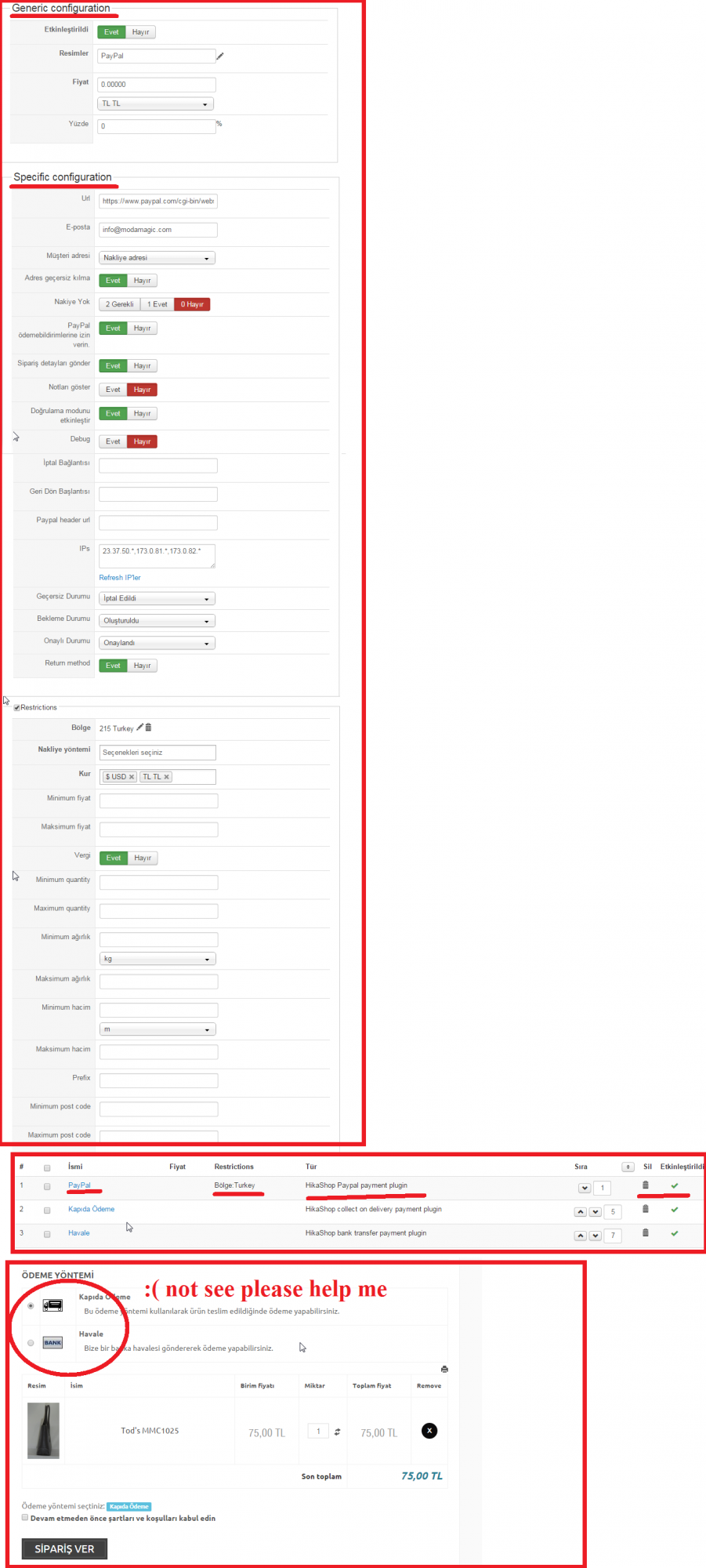

:( I can not actively pay hikashop PayPal (turkey TL), How can we solve
for answer thnekyou

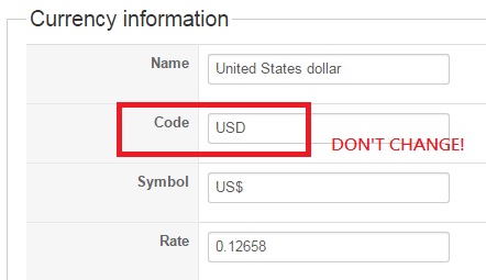

Please do not change the Currencies Code and it will be work

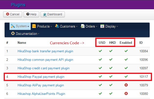

Please check the paypal plugin first (should be enable)

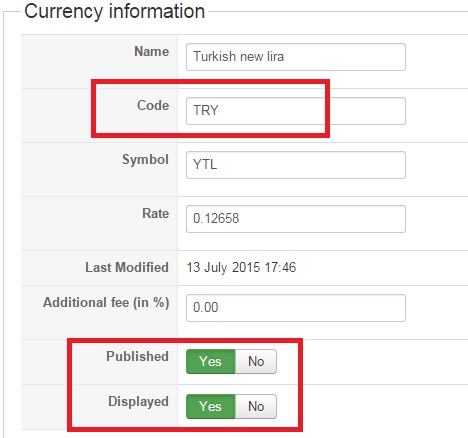

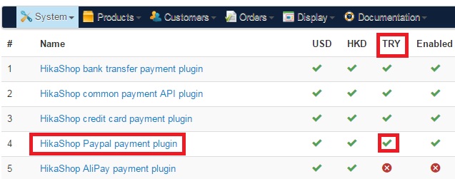

It is enable in paypal plugin?
Does the currency code = TRY?
if not, please change it back.

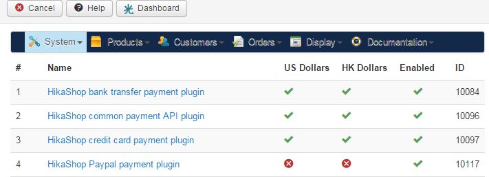

As it's said on that thread :
www.hikashop.com/forum/payment-methods/8...t-method.html#208165
You'll just have to use a Payment method which can use the "TL" currency, or only use the "USD" currency through your website.
You can't use the "TL" currency with that payment method, so use another payment method, OR use that payment method with the "USD" currency
