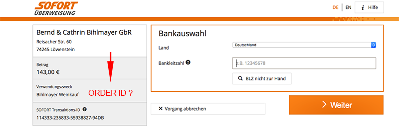

my customer is using SOFORT payment and nearly everything seems to work fine (still in test mode), but at the checkout page where you enter your banking information no order id is displayed (see screenshot).
How can I manage that the corresponding order id will be shown?

The solution will probably be to directly edit the "plugins\hikashoppayment\sofort\sofort.php" file and add that line :
		$Sofort->setSofortrechnungOrderId($order->order_id);
Just after that line :
		$Sofort->addUserVariable($order->order_id);
Can you test it and then tell me if that did the job ?
Thanks.
  • Posts: 11
10 years 11 months ago #207174
this does not solve the problem.
But when I replace:
$order_text = "\r\n".JText::sprintf('betaling Feeen en ridders: order ',$order->order_id);
with:
$order_text = "\r\n Ihre Bestell-Nr. ".($order->order_id);
it is working :)

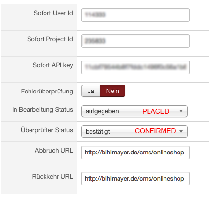

Nevertheless, if you don't want that email to be sent, you can simply deactivate it via the menu System>Emails. It is called "order creation notification".
For the order cancellation, it should happen automatically but only if you didn't enter anything in the "cancel URL" field of the payment method. If you did, Sofort will redirect the customer on your URL instead of the order cancellation URL of HikaShop and thus the order won't be cancelled.
The following user(s) said Thank You: Babylon5
  • Posts: 11
10 years 11 months ago #207813
seems I walked into a trap...
Great, it is working now!
Once again, your support ist friendly, professional and really helpful......GREAT
