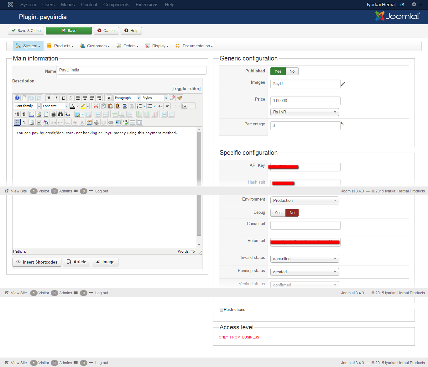

I am excited with new feature "PayU India" payment plugin on Hikashop 2.5.0 version. Thanks for this feature.
Recently I have upgraded from 2.4.0 to 2.5.0. And I have configured the 'HikaShop PayU India payment plugin" with my existing PayUmoney approved merchant key (API Key), Hash Salt. After enabling the plugin in the front end it redirects to payu website secure.payu.in/_payment with error:
"An Error Occurred
Sorry, Some Problem Occurred."
I am not sure where the issue arises. Kindly help to fix this.
