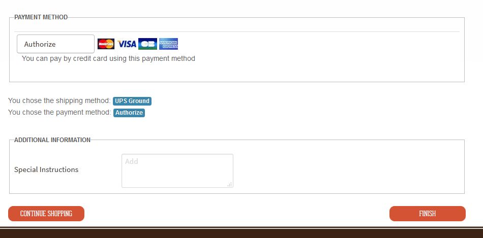

-- Error-message(debug-mod must be tuned on) -- : Where do we change the text that is showing in the authorize.net payment box in the 1st step of checkout? People are wanting to put their credit card info in here, and don't realize they need to click finish to go to authorize.net to input their credit card info. We want to update the text in this box.
Where do we change the text that is showing in the authorize.net payment box in the 1st step of checkout? People are wanting to put their credit card info in here, and don't realize they need to click finish to go to authorize.net to input their credit card info. We want to update the text in this box to let them know to click finish 1st.

The "authorize" text is the payment method name and the "you can pay by credit card using this payment method" text is the payment method description. You can modify both by editing your payment method via the menu System>Payment methods.
