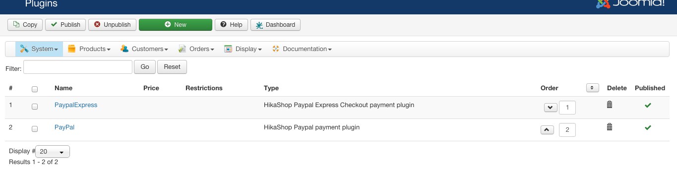

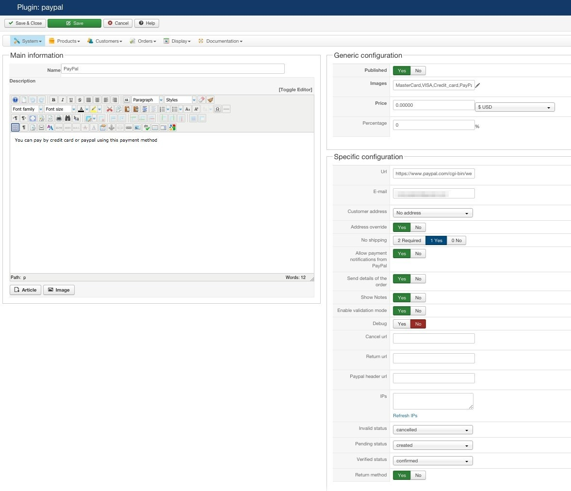

10 years 10 months ago #215081
Can you show us some screenshots of how you configured your payment methods and your checkout workflow via "Hikashop->System->Configuration->Checkout" ?
Thanks.
  • Posts: 5
10 years 10 months ago #215173
Per your request. Enclosed pls find screen shots of various pertinent settings.
Thank yo for your help!
SH

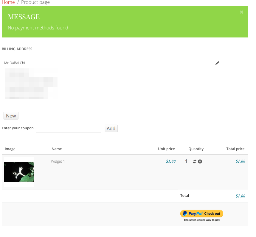

  • Posts: 5
10 years 10 months ago #215354
Hi Guys
Haven't heard from you in a couple of days... Any tips on how to move forward is much appreciated. Really hate getting stuck.
Thank you and I look forward hearing from you.
SH
  • Posts: 26380
10 years 10 months ago #215371
For "paypal", please deactivate the setting "send details of the cart".
For more details, please see : www.hikashop.com/support/documentation/i...nt-paypal-error.html

  • Posts: 5
10 years 10 months ago #215437
Thank you for your help! The more I work w/ Hikashop, the more impressed I am.
I am working w/ my hosting provider to open an outgoing port for PayPal. Could you advise if there is a specific port and/or host/IP I should target the port for?
regards,
SH
  • Posts: 86027
  • Thank you received: 14172
10 years 10 months ago #215445
You want to enable the ports 80 and 443.
  • Posts: 5
10 years 10 months ago #215607
Hi Hika
My hosting company has confirmed that ports 80 and 443 are both open by default. And it supports openssl, but my sites right now do NOT have https connection. Would that be an issue?
Here is where we stand right now.
PayPal Standard
The "Send details of the cart" option has been deactivated.
The system only charges once now, compared to a double charging when we first started.
However, after PayPal redirects back to my site, the same error message shows up again:
Message
Connection failure - error code: 10525, error message: This transaction cannot be processed. The amount to be charged is zero.
But I have received confirmation from PayPal on both authorized a payment and payment authorization. I can also log in to seller's PayPal account to capture the payment.
Since the transaction has gone through completely, why is Hikashp showing the error message? What could be causing it?
PayPal Express
After clicking on the PayPal Exp button, again, nothing changes, the screen stays the same with the following URL:
The payment log file reads (I changed the signature and PWD... ):
-- 09.29.15 01:15:31 --
Fail at step 0 :Connection failure - error code : 10525 , error message : This transaction cannot be processed. The amount to be charged is zero.-- 09.29.15 01:15:31 --
Array
[USER] => clinicalahm_api1.gmail.com
[PWD] => xxxxxx
[SIGNATURE] => xxxx
[VERSION] => 109.0
[PAYMENTREQUEST_0_PAYMENTACTION] => Sale
[SOLUTIONTYPE] => Sole
[LANDINGPAGE] => Billing
[PAYMENTREQUEST_0_AMT] => 0
[PAYMENTREQUEST_0_CURRENCYCODE] =>
[RETURNURL] => nina.clinicalahm.org/index.php?option=co...component&Itemid=385
[CANCELURL] => nina.clinicalahm.org/index.php?option=co...cel_order&Itemid=385
[METHOD] => SetExpressCheckout
Please help! Thanks!
SH

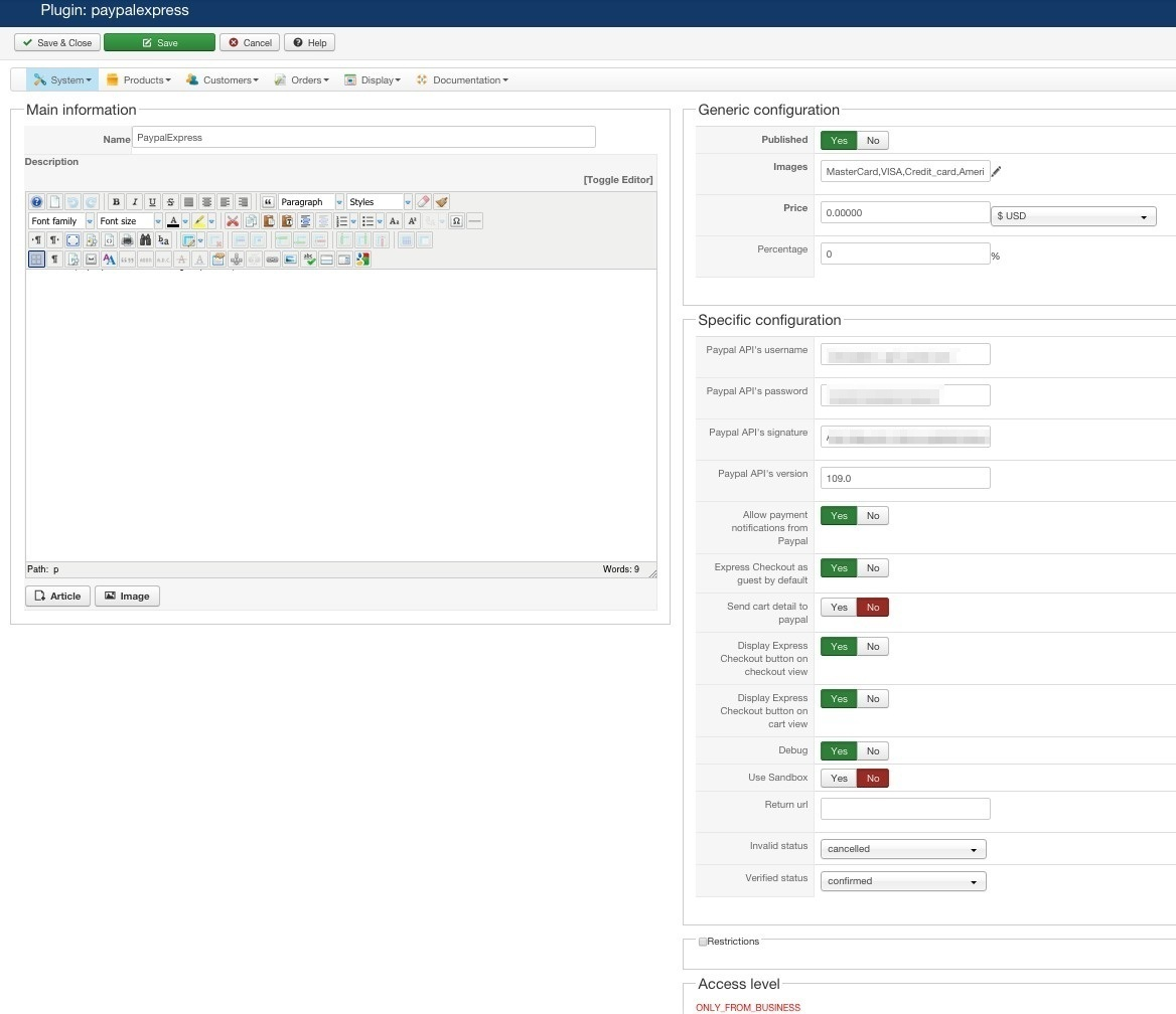

  • Posts: 86027
10 years 10 months ago #215634
HTTPS is not necessary.
The error
is not a HikaShop error. That's a PayPal error. If PayPal displays that, it means that it believes that the total amount of the order is 0.
Could you do a screenshot of the settings of your PayPal express payment method ? (please blur sensitive data)
