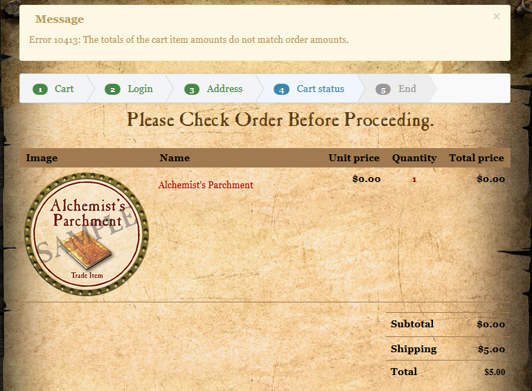

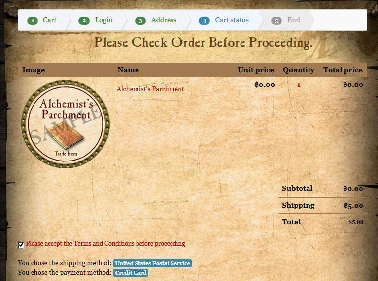

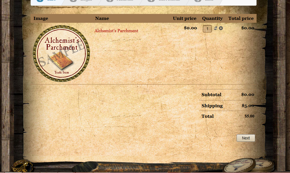

  • Posts: 14
10 years 10 months ago #216546
Yes you are right, i'm sorry i forgot to mention shipping price is getting applied.
I've attached few screenshots for your reference.
I'm using HikaShop version -- : 2.3.5 in which i can't find option of "Send order details to paypal" in Paypal pro payment method.
Is it possible to upgrade only paypal pro payment method because i've made a lot of tweaks and changes in hikashop, so upgrading the whole package will result in extra work which is not possible for me to do now.
Please could you kindly advise me.
Thank you.
  • Posts: 86027
  • Thank you received: 14172
10 years 10 months ago #216574
Yes, you can upgrade just the plugin.
Download the latest version install package on our website, extract it on your website and go in the folder back/extensions/plg_hikashoppayment_paypalpro and zip the files in that folder.
Then, install that zip on your website and it will update just PayPal Pro and you should then get that new option.
