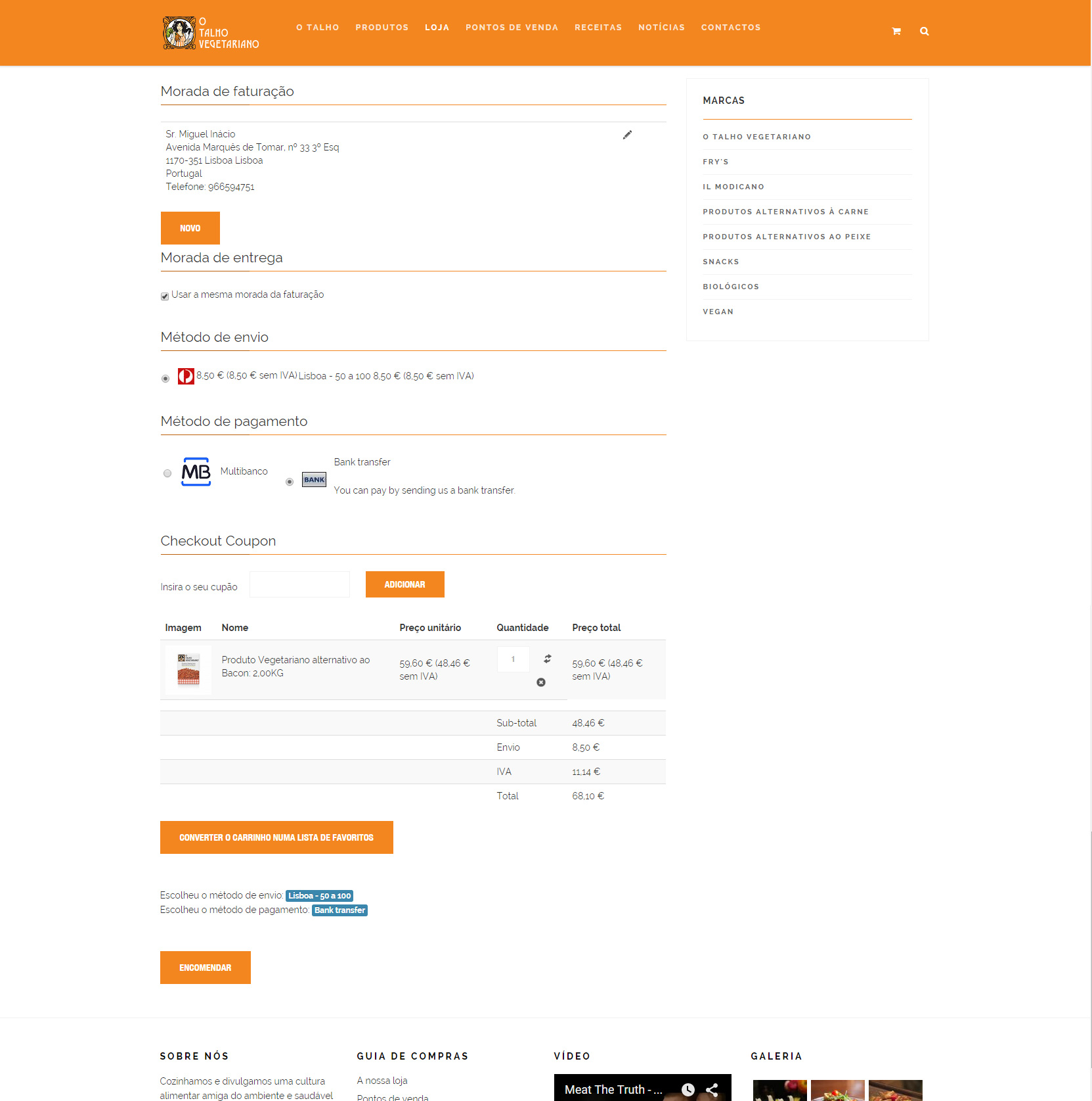

I'm trying to have bank transfer payment method. It just appears but when i click on "Encomendar" to finish, it just refresh the page, and don't go the confirmation page with bank information for the transfer. I just keep in the same page :(
If you gonna test, please you have to select Portugal Country, and an Portugal District. And minimal of 50€
I have no errors by joomla debug... Can you help me?

Would it be possible to know a little more about your checkout configuration and about that "multibanco" plugin ?
Because it's possible to finish the order using that "multibanco" plugin ; I think there is something which refuse the order creation when "bank transfer" is selected.

But when i added the "bank transfer" it's just doesn't do the checkout, i have the debug mode in "maximum" and no erros :/
It just refresh the page like it went to a next step page :(

If you deactivate the "multibanco" payment method, does that solves the problem with the "bank transfer" payment method ?
If yes, then the problem lies in the code of the multibanco payment plugin and you'll have to contact multibase for help.
I've checked your checkout but I don't see any other reason why it would do that.

Yes I checked now and if I desactivate the "multibanco" payment plugin, the "bank transfer" starts working.
I will talk with multibase for help then, thanks anyway.
