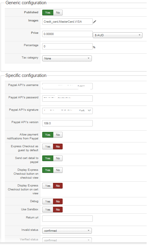

Can you provide a screenshot of the settings of your PayPal Express payment plugin ? (hidding the confidential information).
  • Posts: 13
10 years 7 months ago #224194
  • Posts: 86027
  • Thank you received: 14172
10 years 7 months ago #224222
It seems correct. Could you provide a link to the shop so that we could analyze the situation ?
