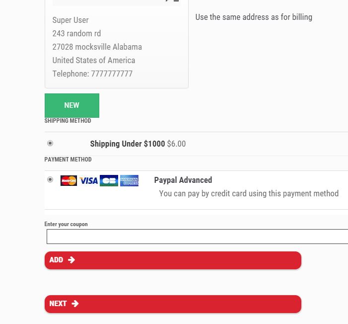

I have a client who is using payflow pro payment method on hikashop. However, I was told by one of the developers here to just use the paypal advanced plugin. I tried this and it works, however this plugin takes you off the site when paying and I have to have the credit cards processed on site.
How can i have my credit cards processed onsite using payflow pro? I have tried setting the type filed to both iframe and form and it seems to have no effect at all. I attached a screenshot of what is happening. It does not allow you to pay onsite.
Edit: Upon looking at this further the way this is working is going to be a problem with this client. I have reviewed the documentation again and it appears that the payment options either popup at the end of the checkout process or opens in a new window when selecting "form". Neither of these options will work with the existing client. They need to pay directly on the site where it says paypal advanced in the screenshot I attached. It needs to function the exact same what the "HikaShop credit card payment plugin" or the authorize.net plugin works. How can i get it to function that way?
www.hikashop.com/support/documentation/2...aladvanced-form.html
I just though of something would Is it possible to at least make the iframe load below where it says paypal advanced instead of on the final step of the checkout?

The iframe mode of the PayPal Advanced plugin will display the credit card form directly on the site in the last step of the checkout.
It's not possible to do differently and have it below the payment method name like with authorize.net or the credit card plugin.
If you want that, you need to use the PayPal Pro plugin, which display exactly like that.
