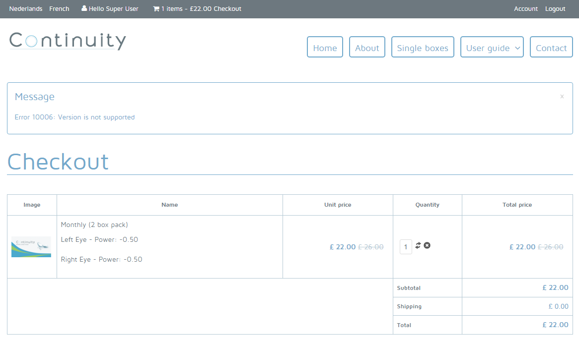

We changed the line to '200' and got a different error message:
Error 10006: Version is not supported. See attached screenshot.
We also noted on the PayPal site, we could set the version to '201' or '202' etc. We tried this but it did not work either.
Do you have any further suggestions?

Well, they told you to put 200 and they payment gateway now says that 200 is not supported...
Are you sure they know what they're saying ?
Besides, I don't see why changing the version number would help.
There are plenty of other merchants using HikaShop and PayPal Pro with the version 51, and it works just fine for them, so the problem must be elsewhere.
It's actually easy to find the issue.
If you look for the error message online the first result on google is:
stackoverflow.com/questions/15578855/pay...e-to-invalid-address
And it says that it can happen when some fields of the address are not filled in.
So I went on your checkout and I saw this:
take.ms/cYra8
So you removed some of the fields of the addresses which are necessary for PayPal Pro. Enable them back and fill them in your user address and it will work.
