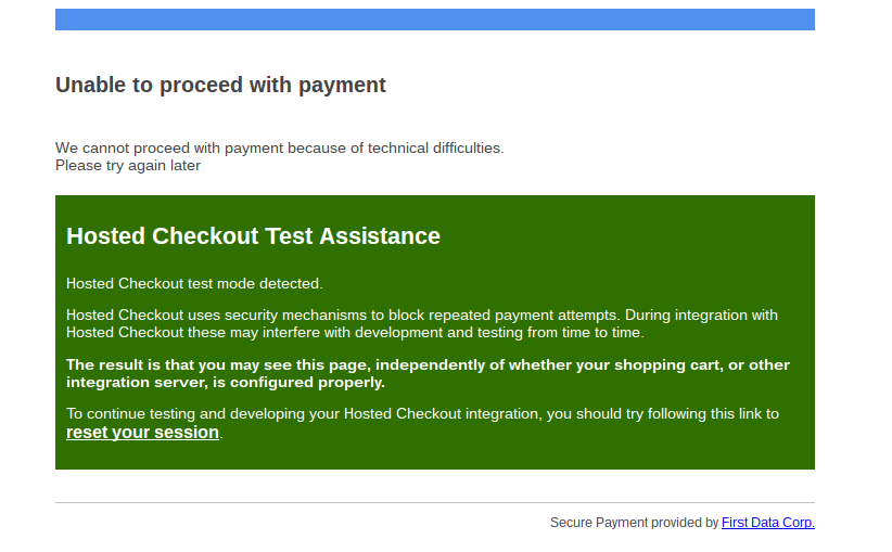

Ok, thank you. I did it. Now it drops me to he page from Payeezy and shows me a message (photo in attachment).

I've never seen that. Try to follow that text and click on "reset your session".

I did. Page just refreshed and then it shows me the link with help. support.payeezy.com/hc/en-us

Then I would recommend to contact the PayEezy support and check with them what this error is about.
