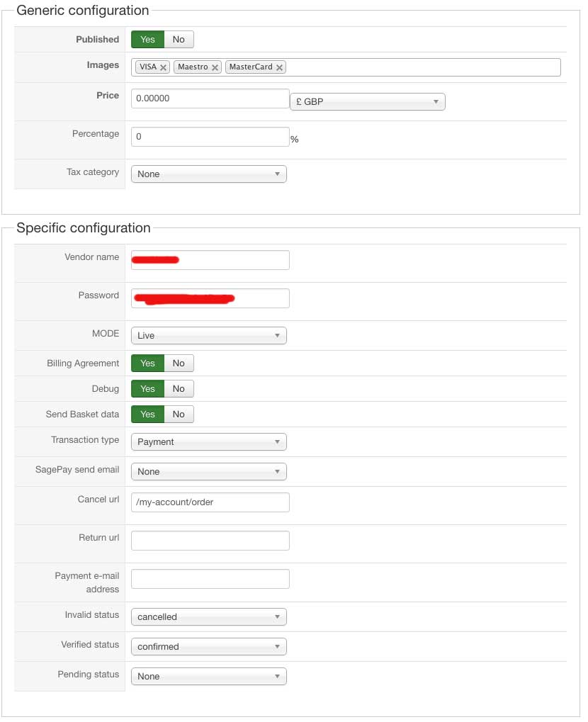

After upgrading from Hikashop 2.5 to 2.6.2 we get the following error message when making a transaction.
"Forbidden
You don't have permission to access /sagepay_4.php on this server.
Additionally, a 404 Not Found error was encountered while trying to use an ErrorDocument to handle the request."
This is at the end of the payment process and according to SagePay the transaction was successful. Screenshot of SagePay settings attached. Have the success/failure URL's changed?
