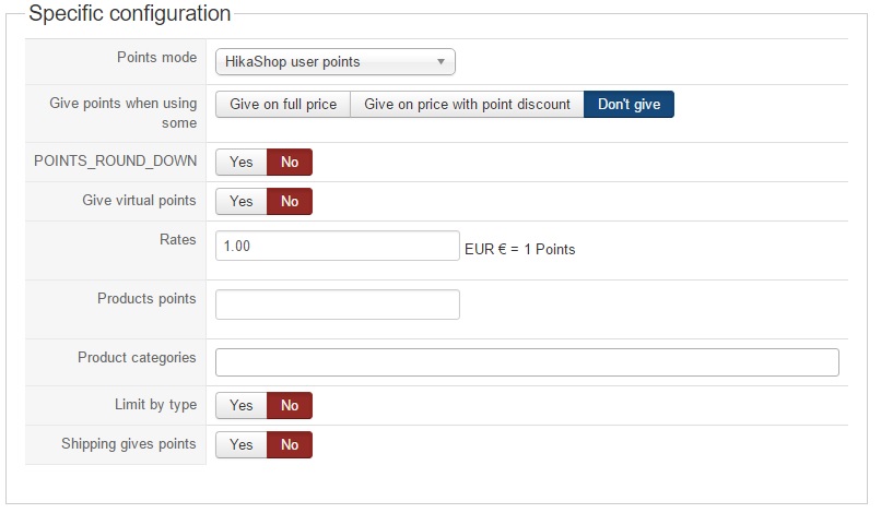

  • Posts: 39
10 years 3 months ago #238915
no because when use "Give on full price" it still doesnt work!
and correct me if i am wrong, but the "give points when using some" setting: "don't give" is:
When a customer redeems points, he will not receive new user points ?
But it only works when i give the user points from the backend, then you see that the database is updated.

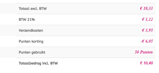

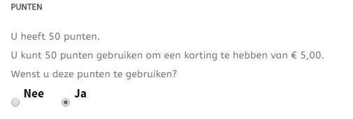

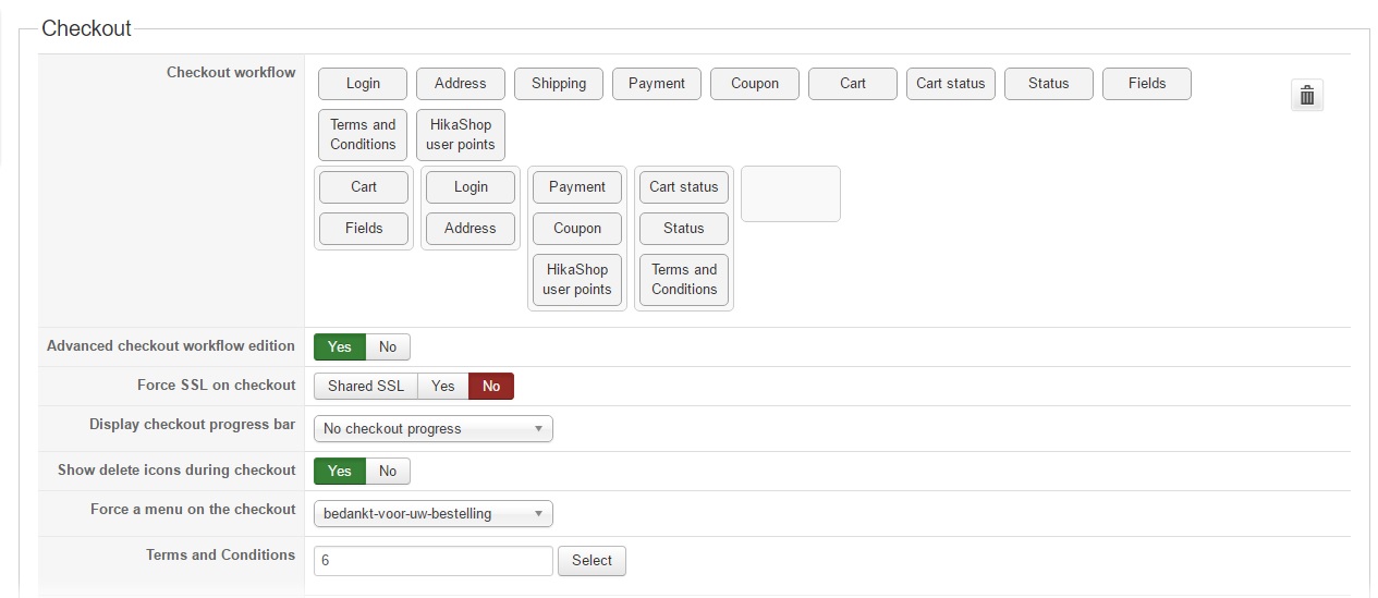

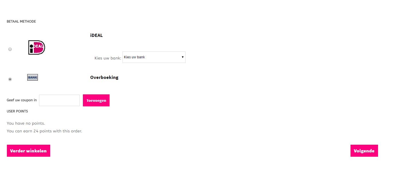

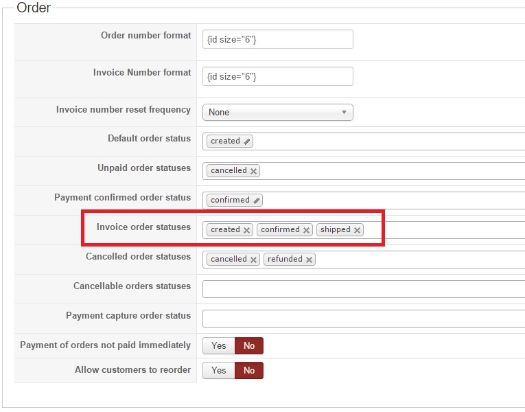

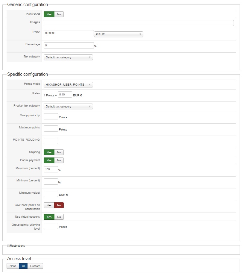

  • Posts: 39
10 years 3 months ago #238971
In step 3 with the payment option, it shows me that i can earn 24 points ( see attachment 1 )
But after a successful checkout and payment, nothing happens and i get no points.
Maybe its something in my Checkout or Order settings? ( see attachement 2 + 3 )

  • Posts: 26380
10 years 2 months ago #240565
It looks likes I'm the only one with enough knowledge on the User Points system ; but unfortunately I'm not in the HikaShop support team.
It's a shame because I already gave the answer several time in the forum.
Your setting "invoice order statuses" is empty and that's the source of your issue.
The "invoice order statuses" setting is there to indicate for which order statuses an order is considered as paid ; so when HikaShop have to generate an invoice number.
If that setting is empty, the "user points" fallback on hard coded settings.
It is also possible to set your own order statuses for the plugin, in the Joomla settings you have a field called "valid order statuses". But the best is generally to use the "invoice order statuses" setting.

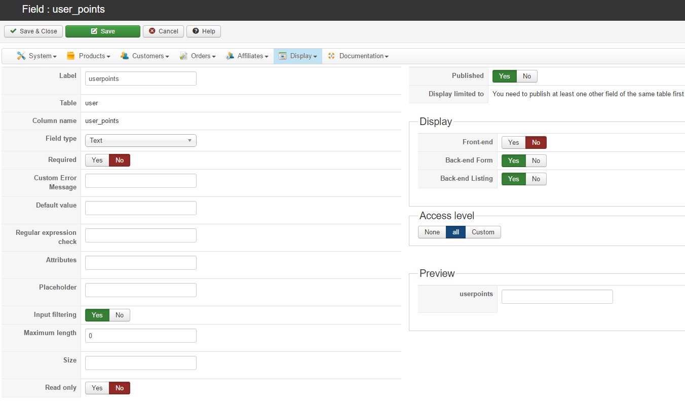

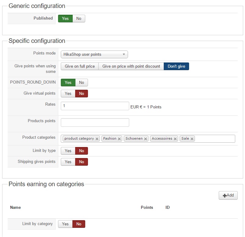

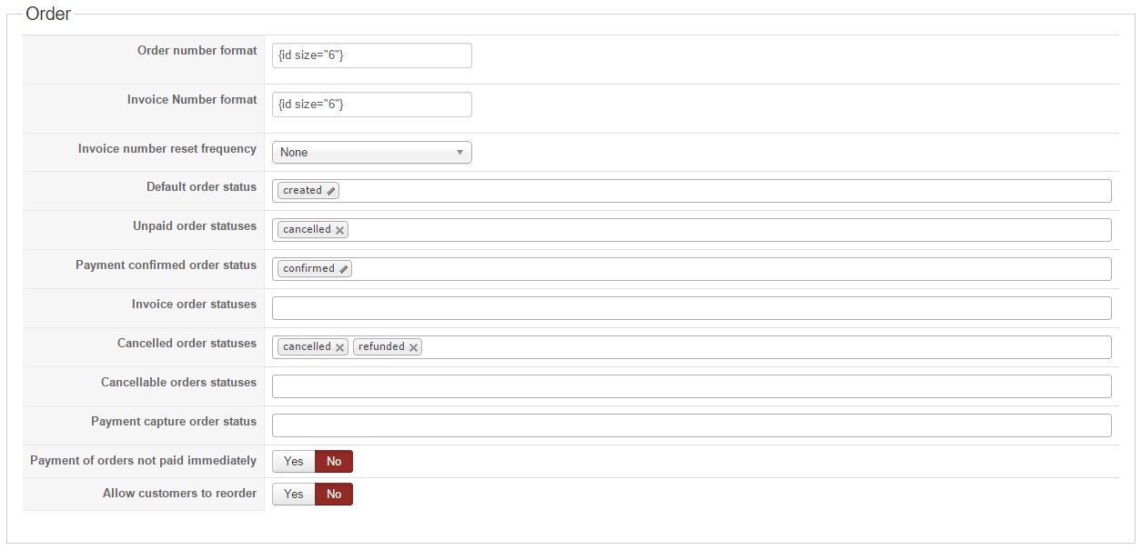

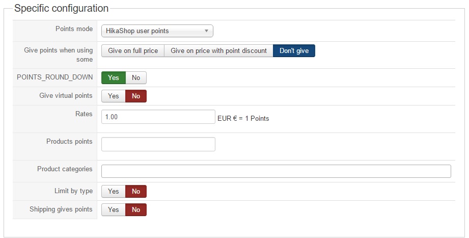

  • Posts: 39
10 years 2 months ago #240729
Hi Jerome,
I'm sure that the order had been made when the settings are right configured.
I just tried it again, first made all the correct settings and then place an order. But unfortunately the user still get points when the user spent the points.
I also tried to start over with the settings and the user points.
* So first i removed the Custom Field "user_points"
* Configured the right settings in System -> Configuration -> Order -> Invoice order statuses (See invoice order status.jpg)
* Create a new Custom Field "user_points" (See custom field.jpg)
* At this time, all customers have no points
* A user creates an order and recieves his points (For example 11 points for 11€) So far so good!
* When the same user spent his points, he will get a discount for that 11 points but still retains his points after a successfull checkout and payment.
* This is strange because the settings of the user points plugin (System -> Plugins -> Userpoints) are at the Specific configuration: Give points when using some "Don't Give" (See give points when.jpg)
I don't get it, even when I start over, it does not work.
Last edit: 10 years 2 months ago by ralph024.

  • Posts: 26380
10 years 2 months ago #242241
It looks like there is one of the patches I submitted (May 2016) has not been integrated into the current release.
In the file "plugins/hikashop/userpoints/userpoints.php"
Please replace
if(!empty($this->plugin_params->notgivewhenuse) && (int)$this->plugin_params->notgivewhenuse == 1 && !empty($order->additional['userpoints']))
By
if(!empty($this->plugin_params->notgivewhenuse) && (int)$this->plugin_params->notgivewhenuse == 1 && (!empty($order->additional['userpoints']) || !empty($order->cart->additional['userpoints'])))
And I guess that's the main reason why I couldn't reproduce the issue.
The following user(s) said Thank You: ralph024
