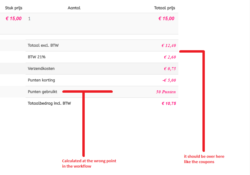

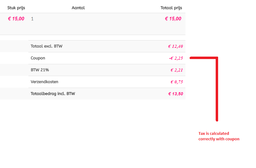

10 years 3 weeks ago #245414
In the current situation, if I use a coupon for discount the Tax is calculated correctly. (See image below)
When i use the UserPoints for discount, the Tax is calculated totaly wrong! (See image below)
And it seems that the Userpoints are calculated at the wrong point in the workflow! This would basically at the same point be calculated as the coupons. Now the tax is calculated from the normal amount, and after that the UserPoints are calculated and that is totaly wrong!
So to change this, so the tax will be calculated in the correct way?
  • Posts: 86027
  • Thank you received: 14172
10 years 3 weeks ago #245423
So it's not wrong, it's just not like you want them for your case.
As far as I understand, the points uses either the total or the sub total based on how you configured the "shipping" setting of the payment user points plugin so please check on that.
And for the taxes that are applied to the points discount, it depends on how you configured your user points plugin. The product tax category setting of the user points payment plugin must be set to your main tax category.
