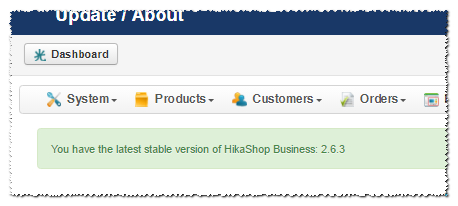

10 years 2 months ago #241724
I see on your website that you have HikaShop 2.6.2 and not the 2.6.3
We've actually modified the authorize.net payment plugin with the 2.6.3 to better handle the notifications so please update.

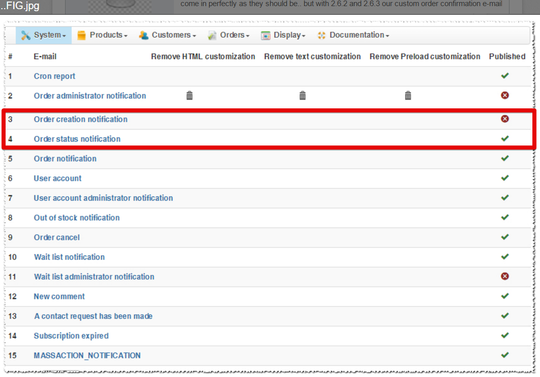

10 years 1 month ago #243173
The screenshot www.hikashop.com/media/kunena/attachment...637/EMAIL_CONFIG.jpg is quite strange.
There, I see that the only email that you customized is the "order admin notification", but you disabled it.
So what is that personnalized email you customized ? The order admin notification ? In that case, you should enable it.
The order status notification ? But it's not written as being customized on your screenshot. Did you remove the customization ?
  • Posts: 31
10 years 1 month ago #243233
The admin notifications should be irrelevant? .. I disabled it because they no longer wanted those.. they've been disabled for a long time so that shouldn't be the issue... the notifications were working long before that was disabled using another payment type.
I can provide you FTP and Admin if you want to take a look at it.. I set up a test site on another server even to try to eliminate a server problem as being the issue but that, as I suspected, wasn't the problem.. we do have another test site where it does work so I'm at a loss..
