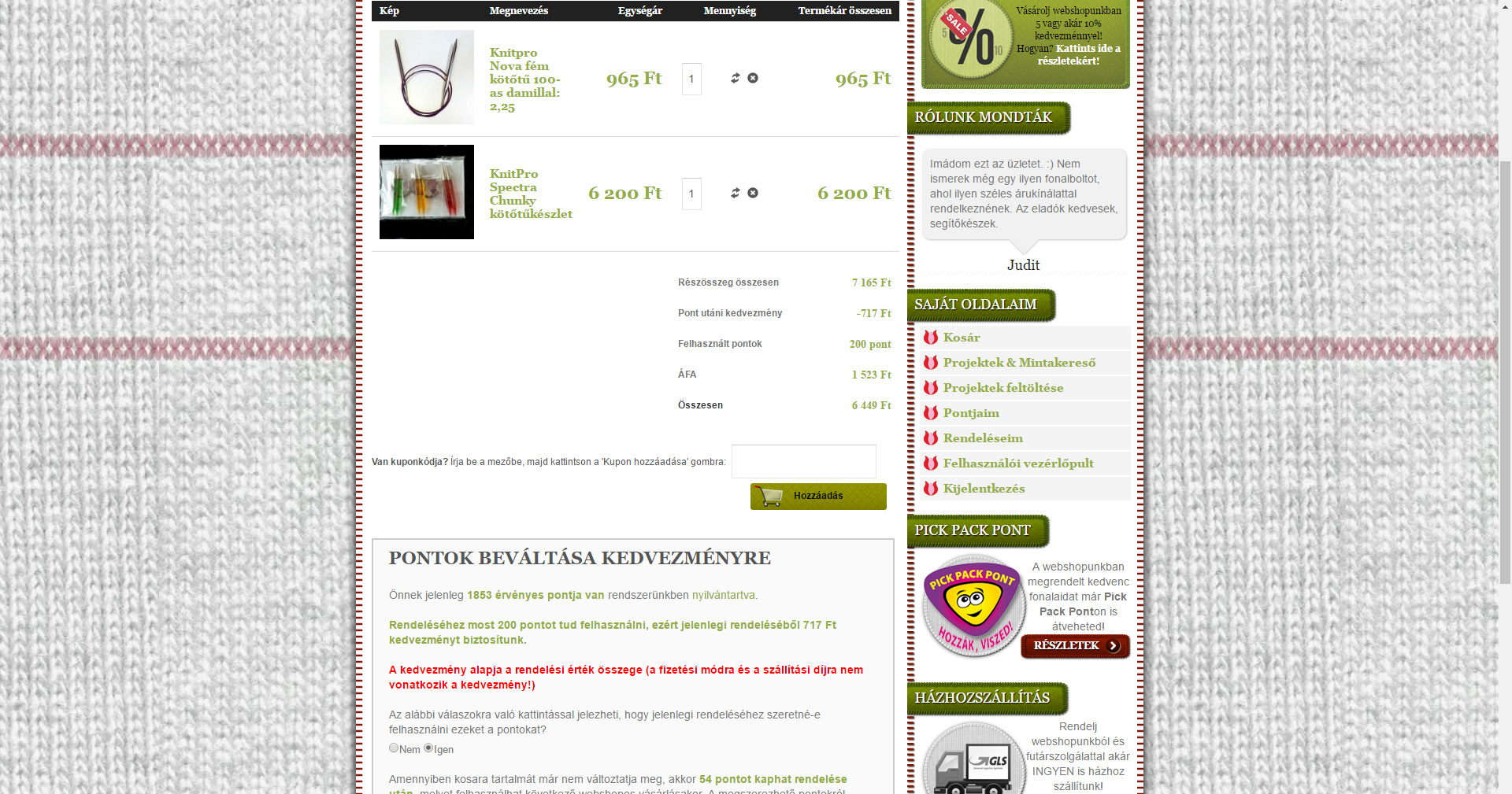

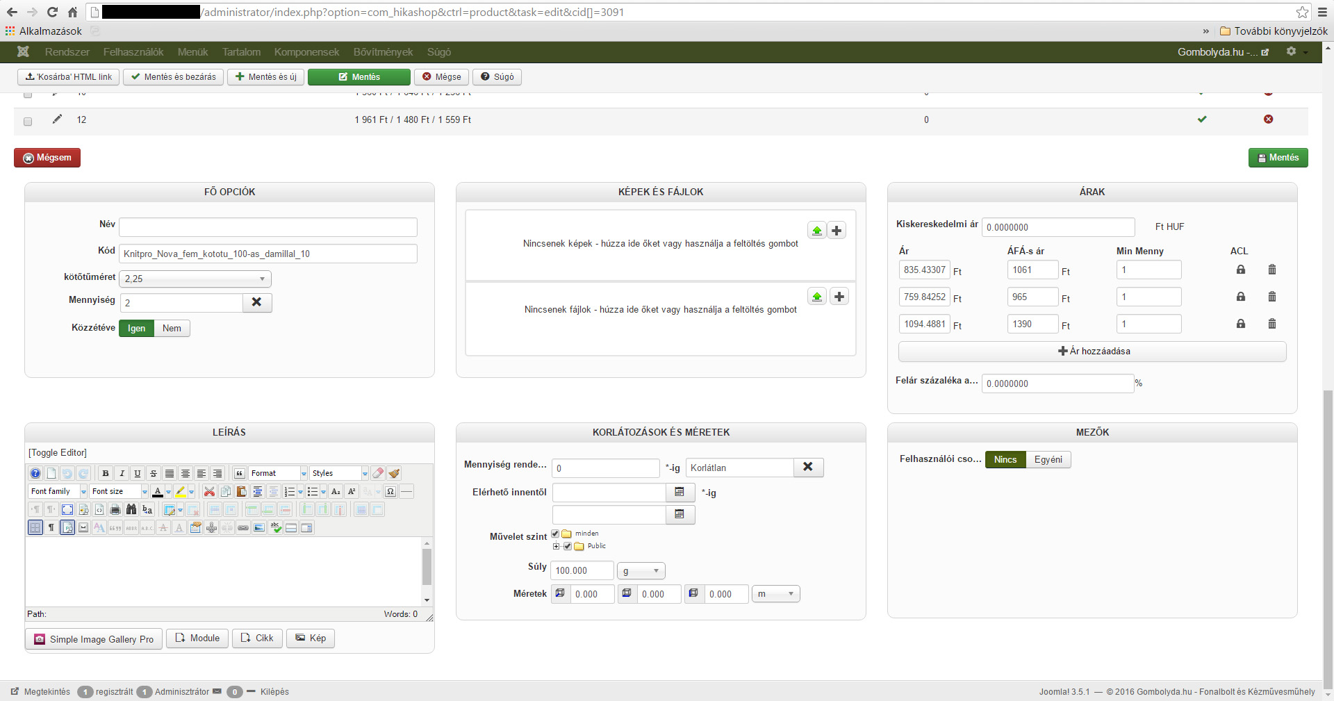

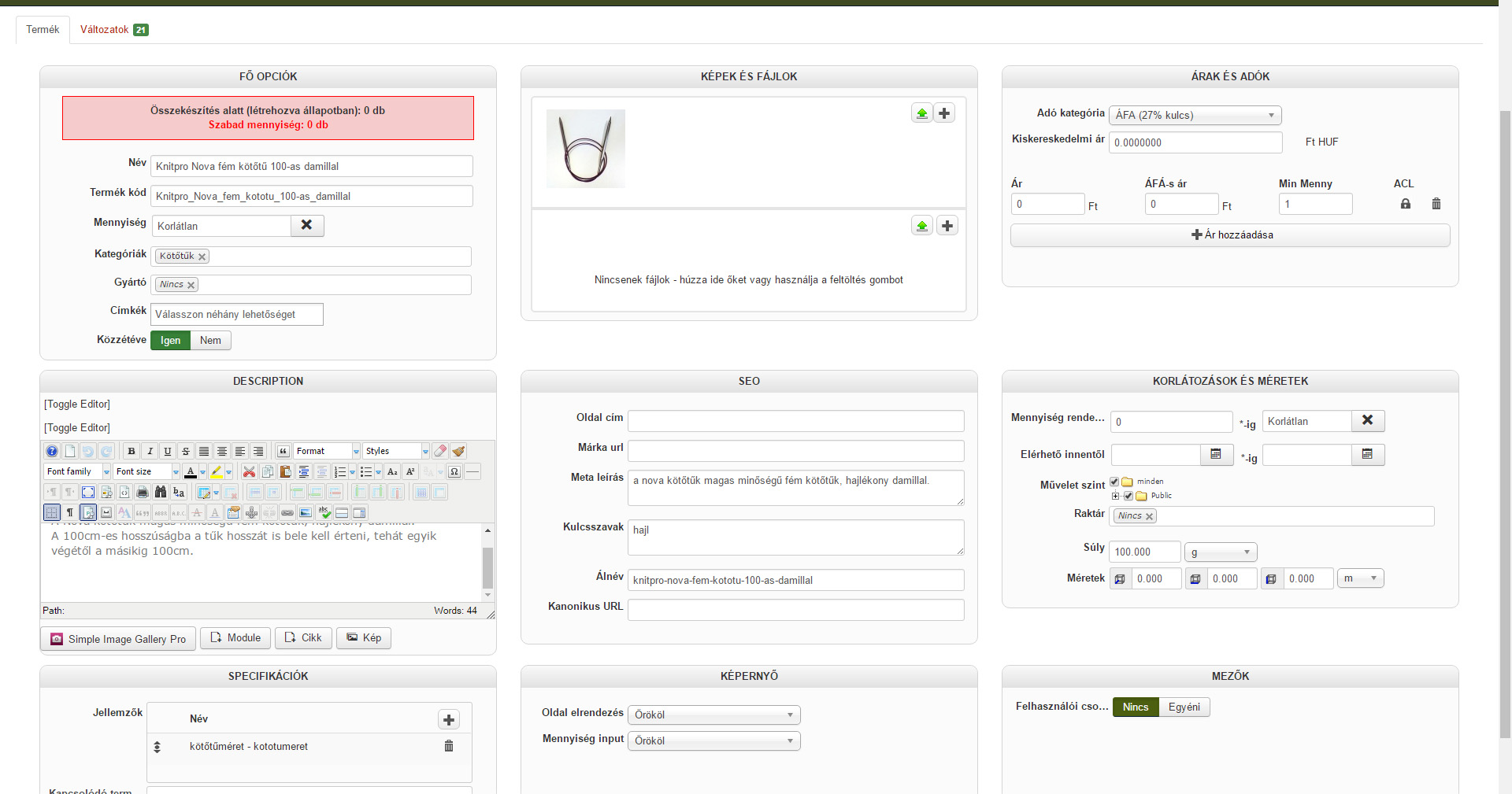

  • Posts: 171
  • Thank you received: 9
10 years 2 months ago #242251
Hi Jerome,
Thanks, I've attached a few screenshots, maybe helps for finding the problem.
On 03.jpg and 03_withnochildproduct.jpg you can see that system count points for that product, which is a parent product (with no child products - named: KnitPro Spectra Chunky kötőtűkészlet).

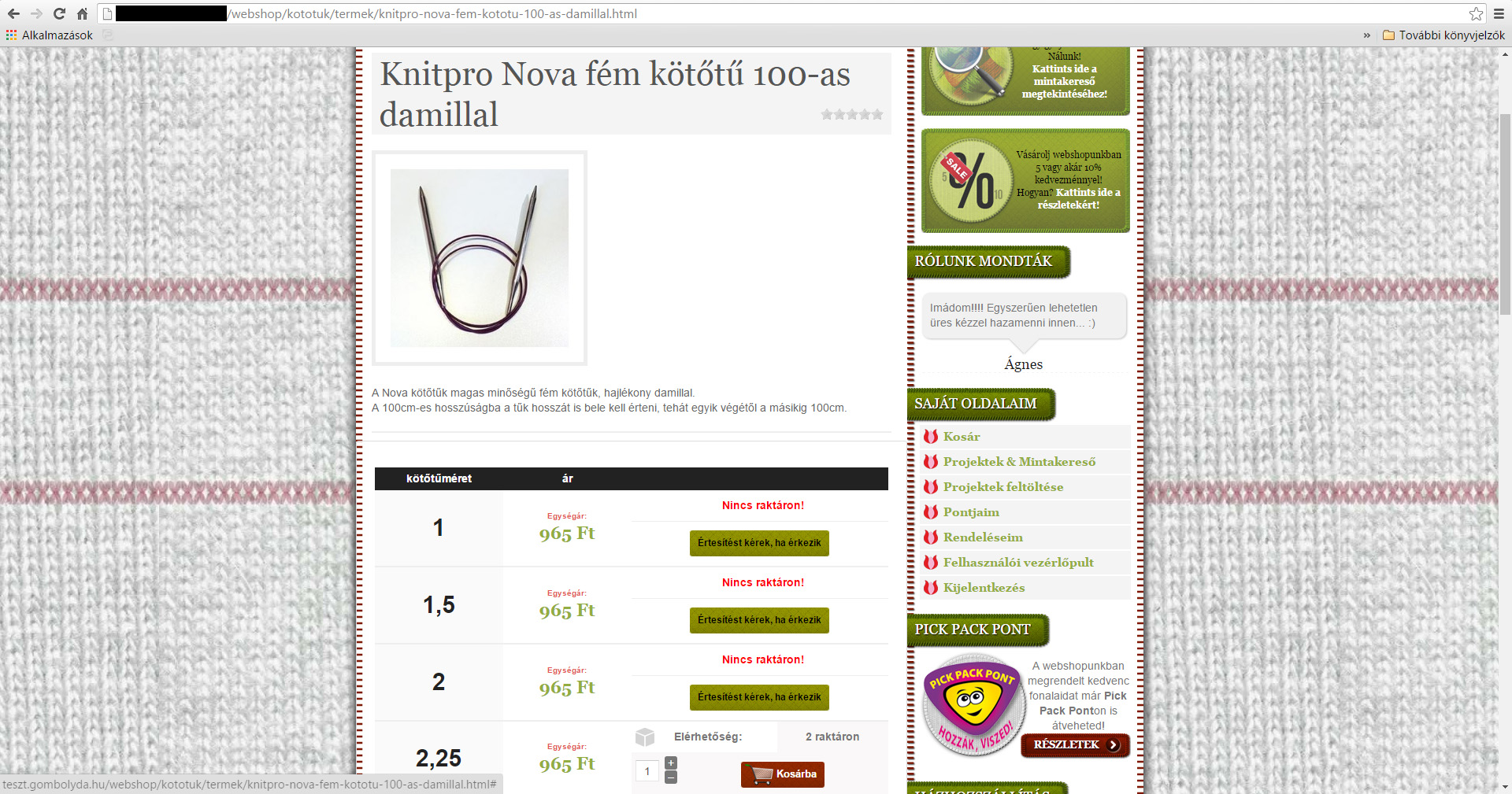

I've also found a strange thing: when order is created the child product is saved this way in the #__hikashop_order_product's order_product_name: Knitpro Nova fém kötőtű 100-as damillal<span class="hikashop_product_variant_subname">: 2,25</span>
Is that normal? Because some user's complains, that they are unable to put child products into cart, but I'm unable to reproduce it, on any devices I tested...

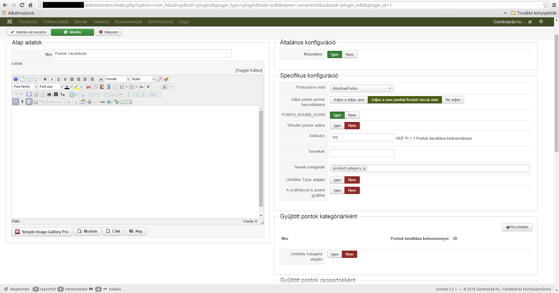

  • Posts: 26380
10 years 1 month ago #243931
You have a filter on the category but the category you selected is "product category" (which is the main category).
So I suppose that every product should be under that category..
Because variants are product without category (the product is just related to his parent product), they are excluded when the category filter is applied.
By removing it from your configuration you will fix your problem.

10 years 1 month ago #244156
Hi Jerome!
You're right, that was the problem. Now as I removed the product category it's OK.
Thanks a lot!
