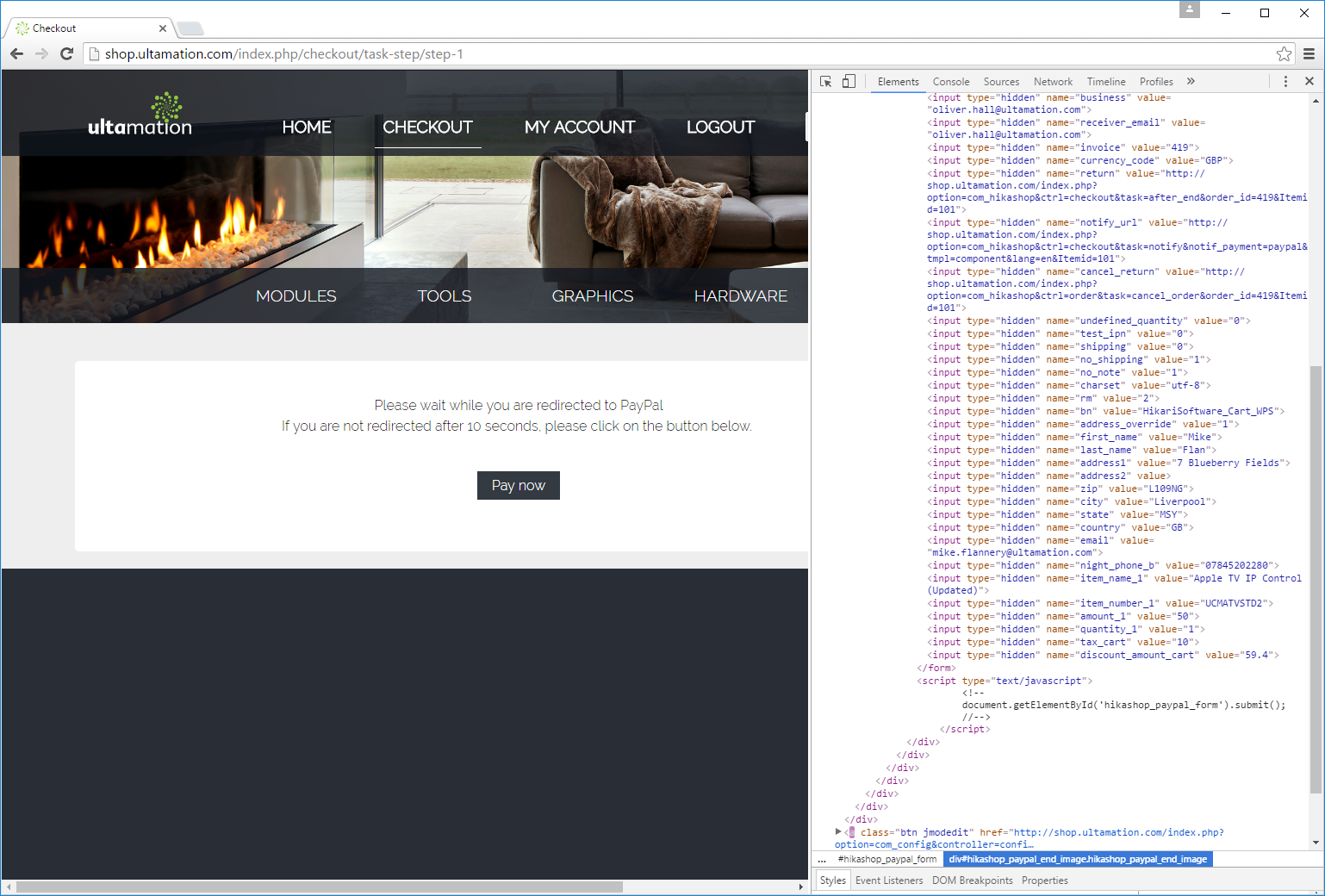

Could you provide a screenshot of an order, and when you place that order, when you see the page with the button to click on if you're not redirected, stop your browser (with the stop button) and look at the hidden input fields next to that button thanks to the developer inspect tool of your browser:

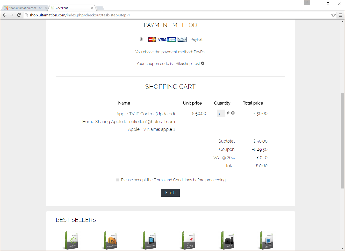

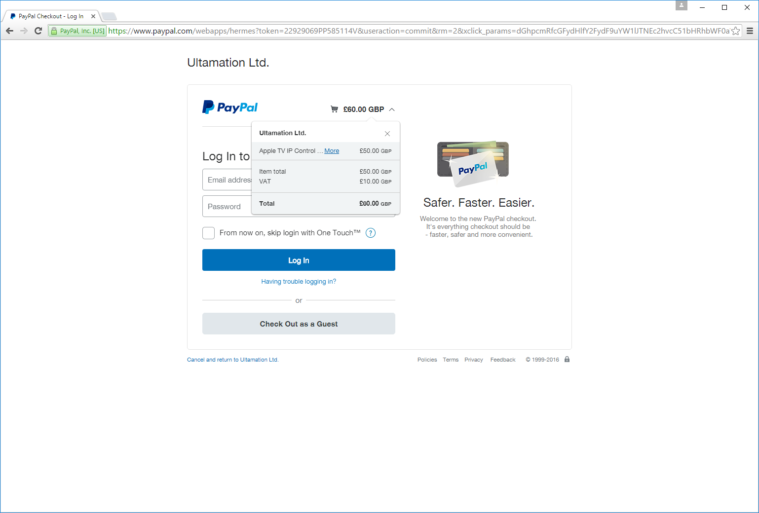

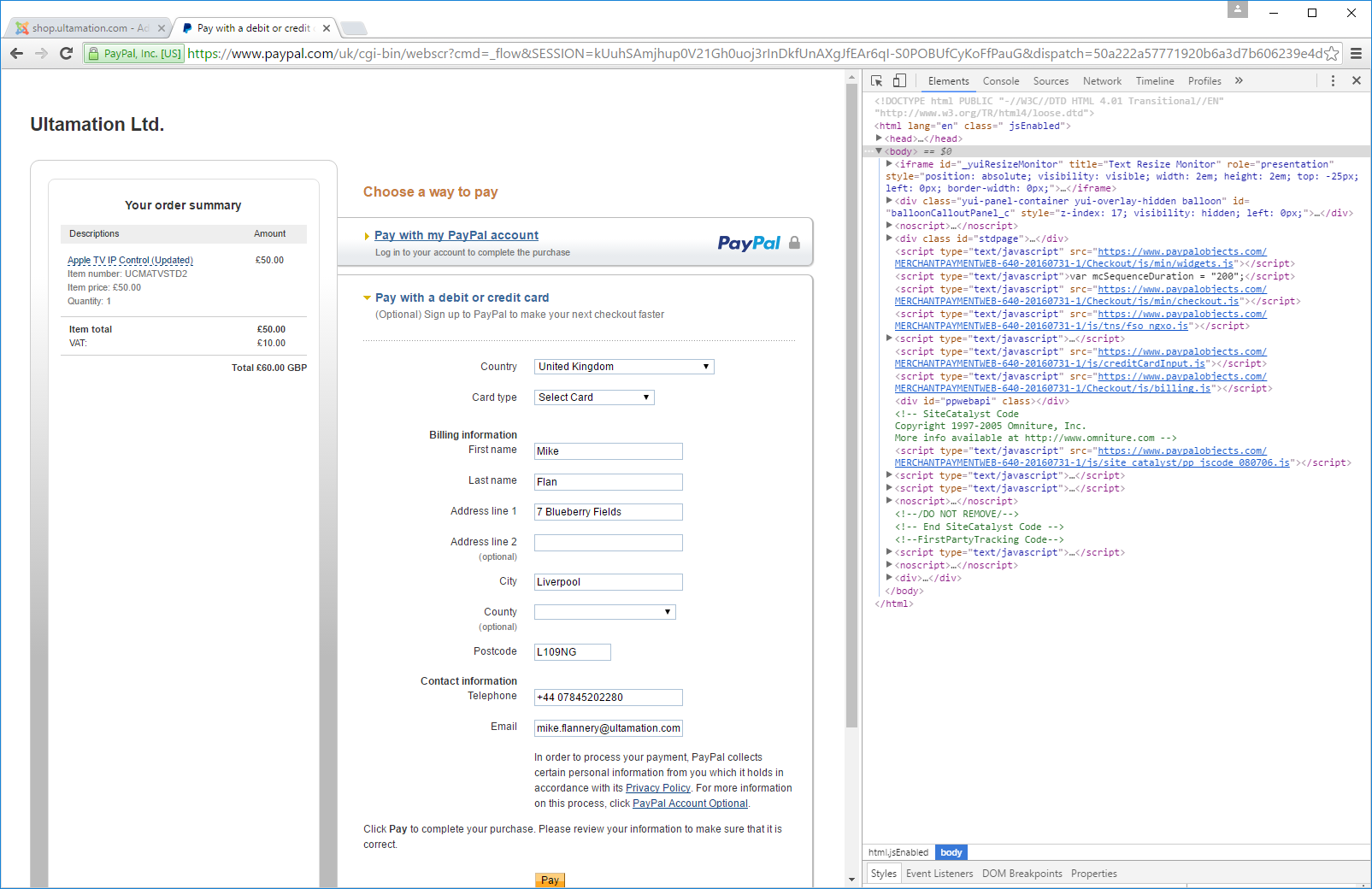

I have created a percentage coupon which takes the price of a £50.00 product down to £0,50. On the Paypal redirect page I stopped the load and checked the input "amount_1" which read 50 not 0.50 which it should be. there are three pictures to explain,
Three pictures attached
Percentage-order on site - shows the product on our site with the discount included.
Percentage-Redirect page - shows the Paypal redirect page with the hidden files.
Percentage-Paypal - shows the amount Paypal asks for on their end.
If you need any further info, please let me know.
Thanks for the help Mike

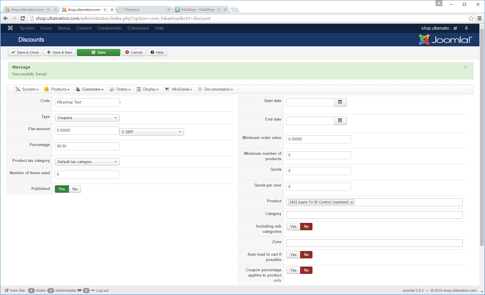

I just try to reproduce your issue but with no success can I see your coupon configuration screenshot please ?
Other point, do you have some checkout override view ( check in Main Configuation => Display dropdown => Views) ?
Awaiting news from you.
Last edit: 9 years 11 months ago by Philip.
  • Posts: 27
9 years 11 months ago #247415
Hi thanks for the quick reply
Attached is the screen shot of the option setting for the coupon.

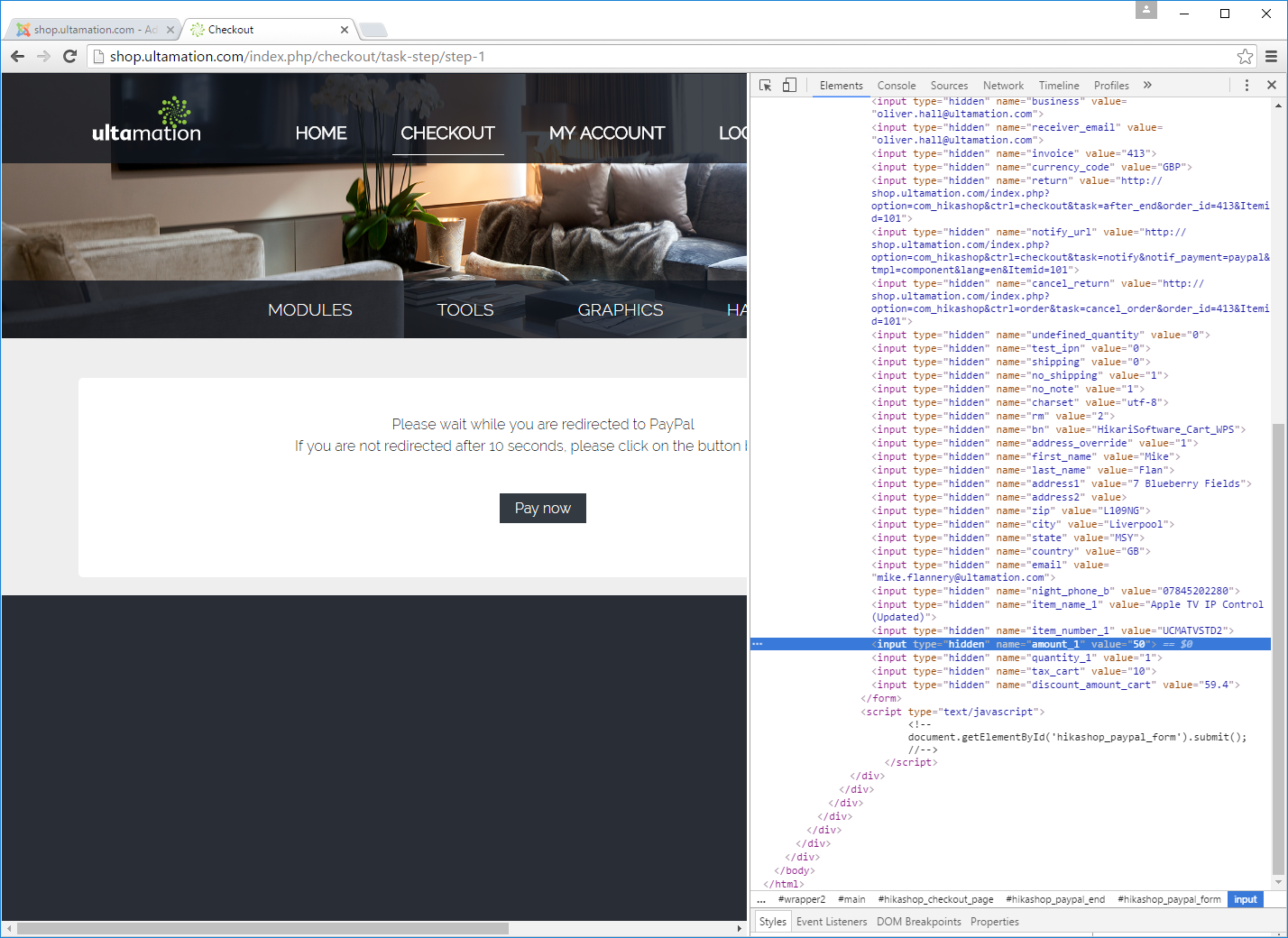

Sorry I didn't even think about the Custom Fields, the Home Sharing Apple ID, just needs to be in the form of a e-mail address "This email address is being protected from spambots. You need JavaScript enabled to view it." will work and Apple TV Name just needs to be a word "example" will work in that field. I have also changed the coupon to any product which means you can purchase a different item if this makes it easier.
We tied your new code but his did not work, images attached show redirect page chrome inspect and Paypal page.
Let me know if you need anything else to test
Again thanks for the help
Mike

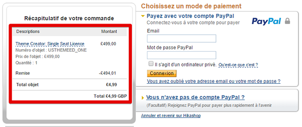

Else, I have something news !
I process some tests on your website, I reproduce your configuration BUT this time I use my own Paypal vendor references to process the test and succeed to have this :
I see only one conclusion, the plugin works correctly, and the root issue is from your Paypal vendor settings...
In this case, maybe you have to modify some parameters, in order to manage detailed cart OR maybe contact Paypal to swicth change your vendor groups (I'm not sure of this last idea or word, just aguess...).
Hope this will help to go forward.
