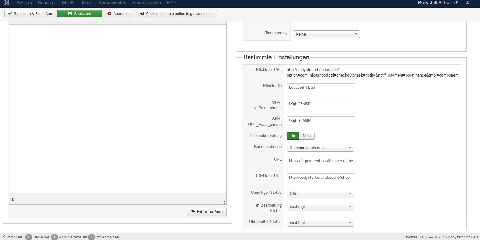

I've also attached the filled formula for the payment as screenshot.
And i have filled the same back URL in Postfinance Backend as in the hika plugin. It is : bodystuff.ch/index.php/shop

  • Posts: 26380
9 years 5 months ago #263817
You should have an entry in your HikaShop payment log telling you the signature is invalid.
Please check your configuration and be sure that the SHA out setting is correct (no extra space, etc).
