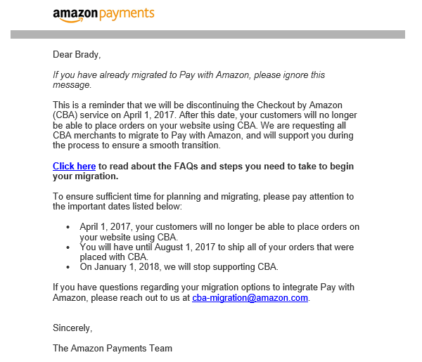

I wanted everyone to be aware that starting April 1st, 2017, "Checkout by Amazon" will no longer be supported and people will not be able to order through the website any longer. Amazon's new service is "Pay with Amazon".
Is the Hikashop team working on a new plug-in for "Pay with Amazon"?
During the last Amazon transition, our company helped with getting the plug-in going. We would be happy to do it again so we don't lose sales and customers. Please let me know.

Yes we have this information and develop a pay with amazon plugin is already on our schedule.
But thanks for your help, if we need it, you can be sure that we contact you, for development process or testing !
