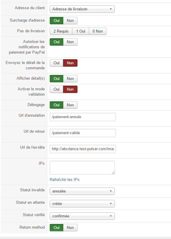

-- Joomla version -- : 3.6.4
-- PHP version -- : 5.3.1
sorry the original message was in french, i'll do it in english ^^
Hie everybody :)
I've linked my website with the sandbox paypal fine, and the emails notifications work good, BUT when i finish to pay, at the return, the order is not set to "confirmed", the status don't move
I don't understand why, because i set the options right :
Invalid status
Pending status
and Verified status
but the order's status don't move, even if i pay the order with paypal and paypal say "it's paid"...
how to do this automatically please ?
thx
Joachim
Bonjour à tous :)
Voilà, j'ai bien relié mon site au bac à sable de paypal, les notifications emails marchent bien, mais au retour de la transaction, la commande créée reste en mode "créée" et n'est pas passée en "confirmée"
Dois je faire à la main le passage de status à "confirmée" ? en remplissant une url retour serveur/serveur ?
Pourtant j'ai bien rempli les options dans la config du plugin paypal :
statut invalide : "annulée"
statut en attente : "créée"
statut vérifié : "confirmée"
Je ne comprends pas ce qui cloche... help please ?
Merci :)
Joachim

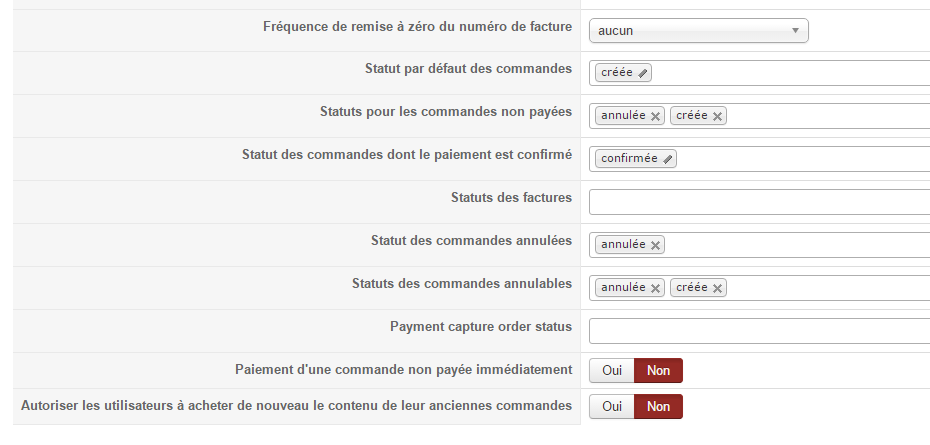

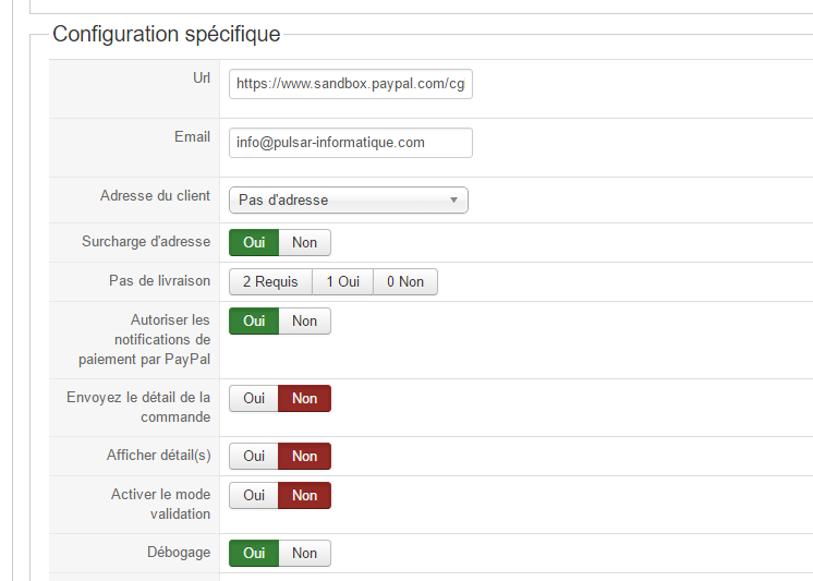

  • Posts: 202
9 years 8 months ago #256312
Ok, now, the log file is created \o/ - the config hikashop wasn't good :) i see it when i was reading the code :)
All work perfectly when i cancel an order on the paypal page : the order status is automatically "cancel"
BUT when i pay the order (on the sandbox paypal) the order status still "Pending" - but on the sandbox it's write "you've successfully paid"
and when i see the log file i see this :

ps : there is my config
Joachim

  • Posts: 86027
  • Thank you received: 14172
9 years 8 months ago #256314
As the log says, the payment notification received by HikaShop says that the payment is pending.
This means that you have the "enable validation mode" setting activated in your payment method settings page and because of that, the payments are not automatically validated when they are made. You need to validate them manually.
That's the most common reason.

Hie, thanks to answer :)
just to be sure, my config is good now ?
my paypal account test is not pro, could it be that ?
thx
Last edit: 9 years 8 months ago by pulsarinformatique.
  • Posts: 86027
9 years 8 months ago #256395
The configuration is good yes.
It might be. But I would recommend you to check your IPN history in your PayPal merchant account in order to know the reason of the problem or contact the PayPal support. They should be able to tell you what's the problem.
  • Posts: 202
9 years 8 months ago #256450
ok, thx, I will be back to you on this as soon as i've the response :)
thx
Joachim
  • Posts: 202
9 years 8 months ago #256647
ok, they say me as i'm with the sandbox paypal, the statut always "pending"
So, when i will be in the real paypal, the return of the statut will be fine :)
thx
Joachim
