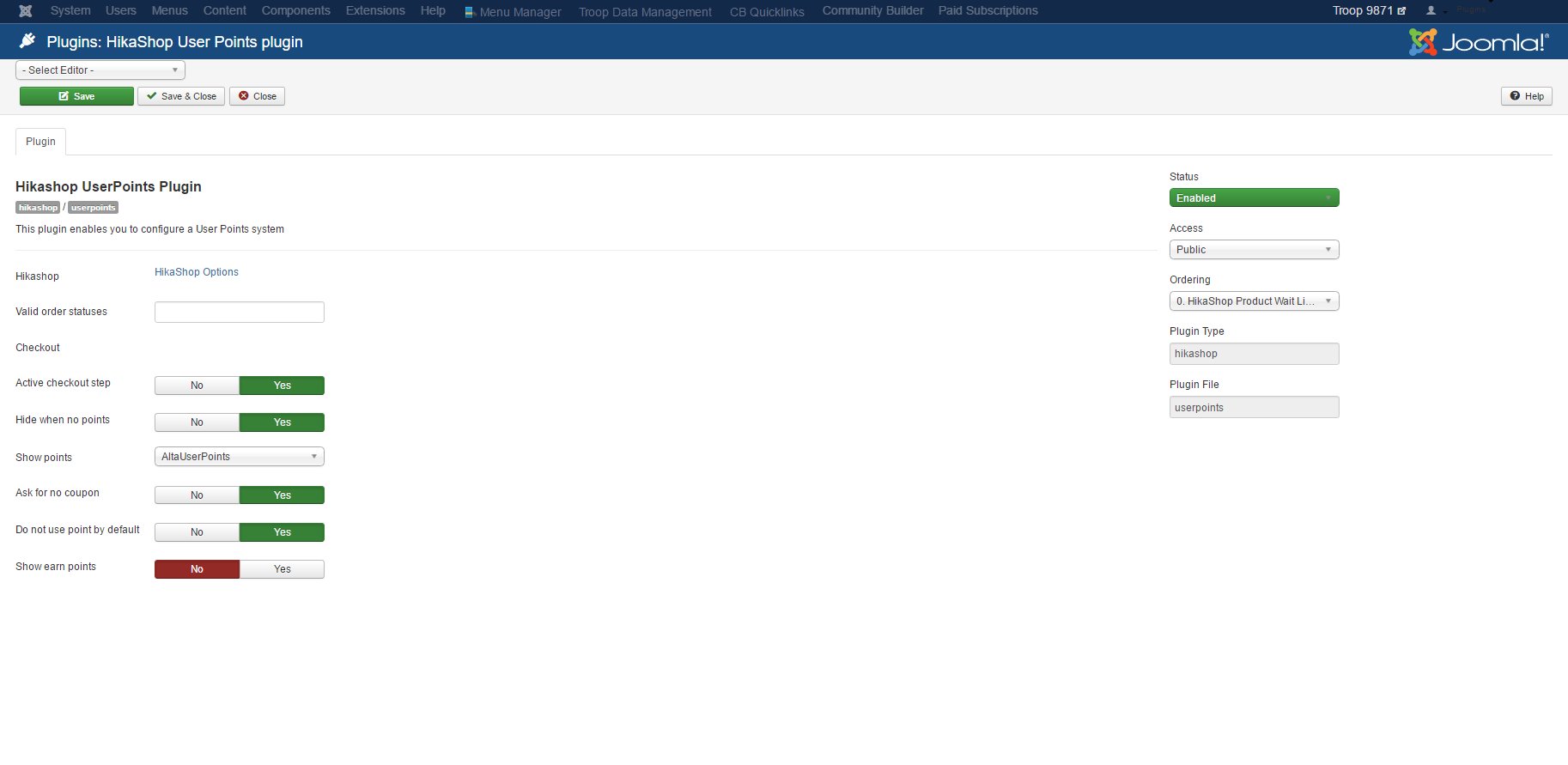

Please provide a screenshot of the settings of that plugin, of the settings of the user points payment method and a screenshot of the Checkout tab of the hikaShop configuration.
  • Posts: 196
  • Thank you received: 6
9 years 7 months ago #258153

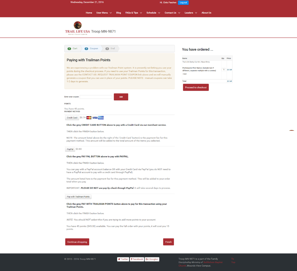

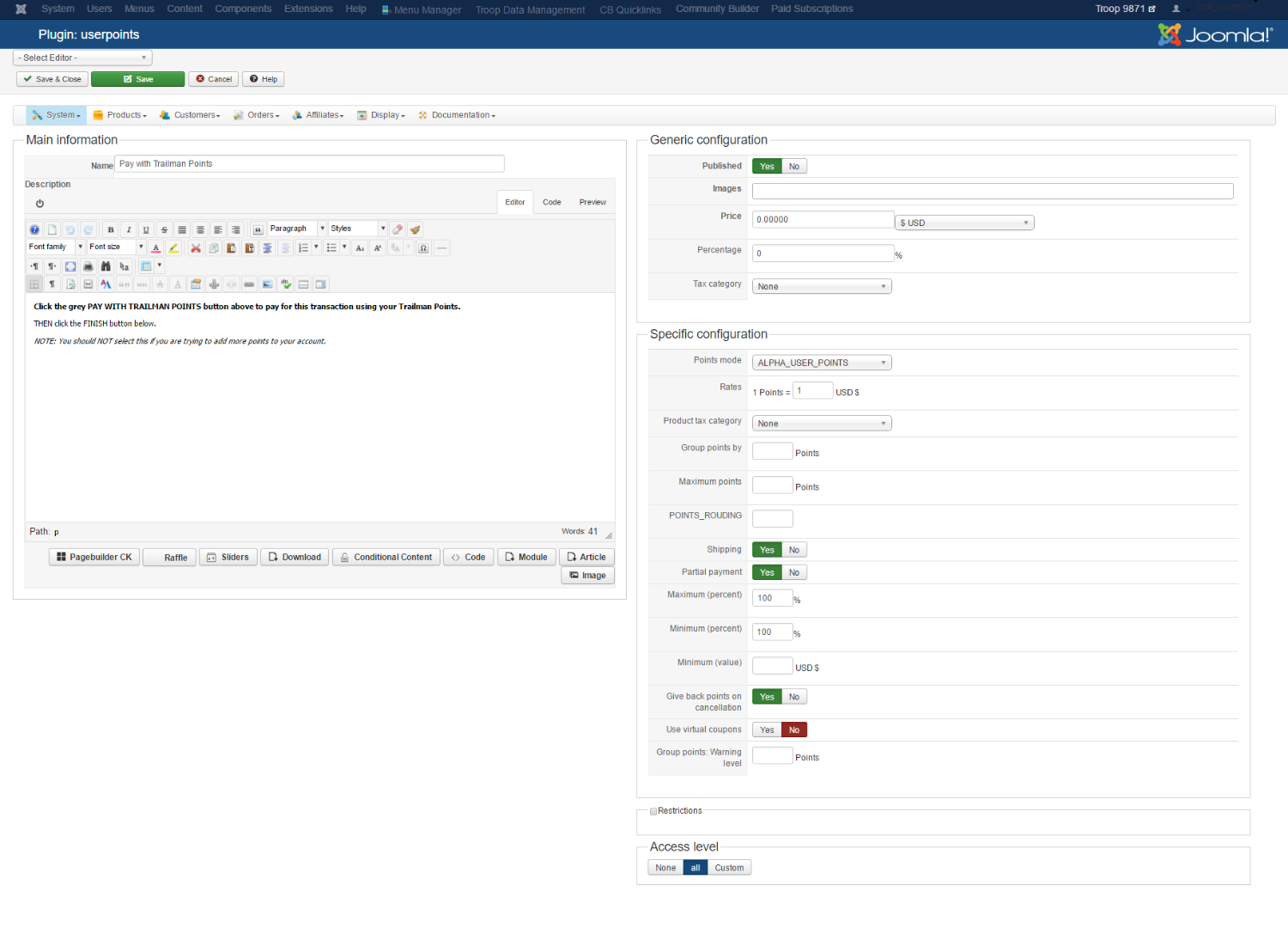

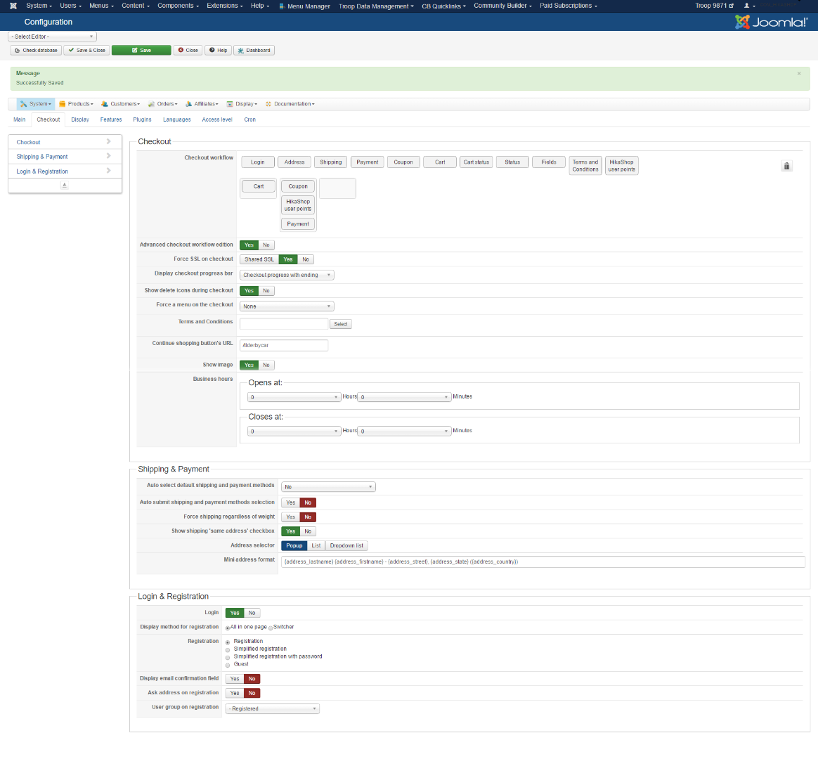

Here are shots of those items, also a front-end shot. It all looks good, it just doesn't DO anything (other than marking the order as 'confirmed' IF you click the FINISH button several times. However, it never deducts any points from the user's AUP account. And I also just noticed that it doesn't send an email to the user when they use the points payment options (but it DOES send email when they pay with the other options).

You're not using the "virtual coupon" mode.
So the process you're describing is normal (no bug, everything good) and is also in the direction where we are telling you to not go.

1 - Your module in the checkout workflow is configure to use "Alta User Points".
2 - Your "user points" payment instance is configure to use "Alpha User Points".
3 - Your cart is not display in the same step than the "user points" block in your workflow.
4 - The configuration of the payment plugin is asking for the entire cover of the order by the points with a strange organisation (partial authorized but min is 100% and max is 100%).
You should configure your elements to use the same point component.
And you should check your configuration and your restrictions.
The block you display your the number of points and propose you to use or not the points for the order.
If you accept, the cart will include an extra line (under the shipping) for the discount ; the cart additional :
But if you have plugins which also use the "cart additional" feature (like the eco-tax plugin) ; it is possible that it generate a conflict.
So you first need to be sure to have the very latest HikaShop 2.6.4 package and if the problem persist ; you'll need to provide details about your plugin configuration (in the HikaShop > Plugins part and also in the Joomla > Plugins section)
I'm guessing you mean the setting within the "Hikashop UserPoints Plugin".
That is because I'm using Alta User Points, Alpha User Points is not an option (probably because it is not installed).
The only 2 options available are "ALPHA_USER_POINTS" and "HIKASHOP_USER_POINTS".
There is no ALTA user points option.
Also, why are these strings not being properly translated?
Does this matter?
Logically, the points should be displayed at the time of payment, not at the time the cart is displayed.
I do not remember changing either of these amounts
I have moved the points to the cart step in the process (item 3)
I've cleared the values in min/max fields (item 4)
And the checkout process appears to work fine (from the user's perspective).

1. You don't see the correct text because your translation file is not up to date.
If you look at the current translation file for english available on our website ( www.hikashop.com/download/languages.html ), you'll see that text on the line 2840:
ALPHA_USER_POINTS="AltaUserPoints"
So actually, when you select the "ALPHA_USER_POINTS" choice, it is AltaUserPoints that is selected.
So that is fine.

OK ... maybe we're getting closer.
But it is still not deducting points.
First, it is very hard to follow any of the instructions on
www.hikashop.com/support/support/documen...57-using-points.html
Mainly because the english is not written well and hard to read.
Second it appears outdated (the screen shot is VERY old) and not accurate (the phrase "Under the menu "HikaShop > plugins" is not accurate, there is no main menu option of that sort. you have to go into HikaShop then select SYSTEM > plugins, etc.)
Third, we are not 'earning' any points (we are only paying with points), so I did not follow any of the instructions in the 'Earning' section. Yet you are now telling me that I should. I'm just very confused with all these instructions (and I'm 10-year Joomla! user with programming experience).
Fourth, You say that I need to configure the Invoice Order Status; however, you don't indicate what status I need to add here to make it work. I've tried CONFIRMED and CREATED, but neither seem to have any effect (points are still not deducted).
I have the user_points custom field created and published, I have the userpoints plugin enabled, and the userpoints payment enabled.
As I've said, it does EVERYTHING (showing the points available, applying the points to the cart, creating invoice, setting the invoice to completed, etc.) but just never deducts the points within AUP.
While I'm guessing it is still a configuration issue, I still can't identify where the problems are. Can you either provide (up-to-date) screen shots of a properly configured system to make this work, or give step-by-step, field-by-field settings.
Without this type of accurate documentation I don't know how we will ever get this working.
This is a huge 'potential' feature for HikaShop ... but without proper documentation it isn't usable at present.
