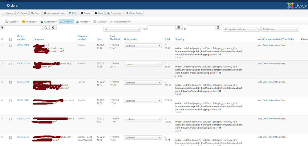

Hi, I have had an issue since the 21st January with no payment notification for international purchases being received by Hikashop? I am getting UK notifications ok but for some unknown reason no international ones therefore the order statues are not being changed from 'created' to 'confirmed'
Any ideas please?
thanks

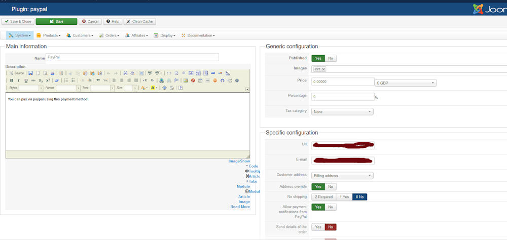

I don't see why the payment notifications would be received for some countries and not for others.
So how did you configure your payment methods ? (could you do a screenshot) ?

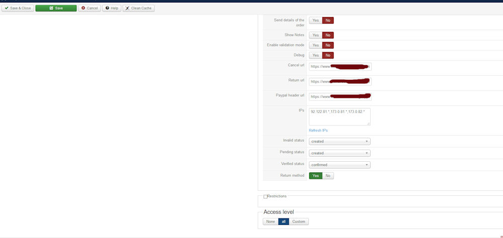

If you turn on the debug setting of the payment method, it should add debug data in the payment log file of the HikaShop configuration after each payment. Do you get anything there for the orders without the status change ? What do you get ?

Hi, No its very strange? after further investigation it is not affecting USA or Ireland but just appears to be Europe?
Nothing showing from the debug.
Only PayPal has this error.
Cannot reproduce as it does not do it with UK payments.
History just shows 'created'
Not sure where to find the payment log file?
PayPal screen dumps attached
Attached is a screen dump of orders after my first post. You can see the 'created' one and this is from Denmark, payment has been received, all the rest are UK orders that have correctly changed to 'confirmed'
thanks

Can you switch ON your Debug mode and provide us (via Contact us form) the log file with succesful paypal order AND unsuccessful order.

Is this the debug on the payment method (PayPal) or site wide?
thanks
9 years 4 months ago #266253
You will find the debug mode for Paypal in his backend configuration, Specific configuration part.
See this tutorial for your Paypal plugin AND this one for payment log.
