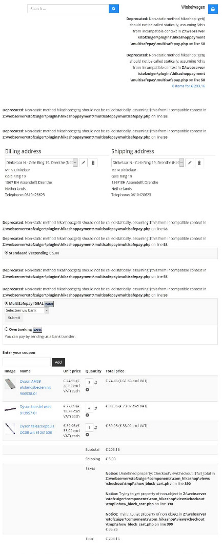

-- Error-message(debug-mod must be tuned on) -- : Deprecated: Non-static method hikashop::get() should not be called statically, assuming $this from incompatible context in Z:\webserver\stofzuiger\plugins\hikashoppayment\multisafepay\multisafepay.php on line 58
Notice: Undefined property: CheckoutViewCheckout::$full_total in Z:\webserver\stofzuiger\components\com_hikashop\views\checkout\tmpl\show_block_cart.php on line 390
I want to use the MultiSafepay gateway in my webshop. I installed the plugin from their website: www.multisafepay.com/solutions/shop-plug...il/plugins/hikashop/
After installing and activating the plugin, I get a lot of errors and the plugin isn't working. Can you tell me if this is an issue with Hikashop? I've added a screenshot of the cart. I removed a lot of the same deprecation messages in the screenshot to make the screenshot smaller.
Can you tell me if there is a solution or an alternative for the plugin?

To remove the warning, in their plugin you should replace
hikashop::get
By
hikashop_get
Afterwards, I'm afraid that we can't provide much more support on the plugin because it does not have been made by our team and do not use the HikaShopPaymentPlugin interface.
Maybe you should contact the Multisaferpay support team to ask them a new version of the plugin, compatible with HikaShop 2.6 - 3.0

Hi Jerome,
The deprecation errors are fixed. Now I get a couple of other errors in the cart. The problem is now that the payment selection Submit button is not working. I also got the feedback from MultiSafepay that some of the cart data is not processed correctly in the session.
Notice: Trying to get property of non-object in /home/deb3757n229/domains/r2h.nl.stofzuiger/public_html/administrator/components/com_hikashop/helpers/checkout/payment.php on line 115
Warning: Invalid argument supplied for foreach() in /home/deb3757n229/domains/r2h.nl.stofzuiger/public_html/administrator/components/com_hikashop/classes/cart.php on line 2016
The plugin works in legacy mode, but this is not ideal. As legacy means that in the near future this will not be supported any more.
I hope you can help me to make the plugin work
