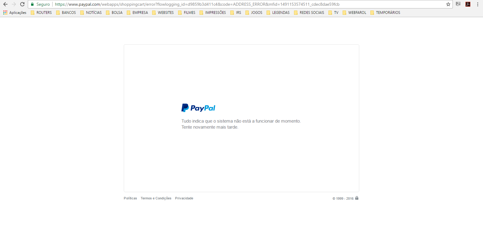

Paypal payment dont work.
After confirm payment and redirect to paypal page it goes to the url
www.paypal.com/webapps/shoppingcart/erro...574511_cdec8dae59fcb

Did you contact the Paypal support ?
The messages is not very specific and mostly give the impression that Paypal services have some internal issues.

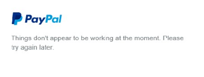

Joom 3.6.5
Hka 3.0.1
Suddenly no one can pay.. just happened today.
Paypal error is "Things don't appear to be working at the moment. Please try again later."
Paypal URL is
www.paypal.com/webapps/shoppingcart/erro...923990_f13b1c88c799e
My site is http only ... has this anything to do with it? (I have other older sites and they work fine, but are https)
url for site is www.tarb.com.au/assessment-book-orders/personal-order.html
But i have closed the site til this is fixed.
Contacted Paypal and they said "shopping cart button needs update"...I dont
know what this means.

I am encountering the very same problem! What is strange is that it affects some, but not all customers. So far it has affected ~ 50% of the customers who tried to purchase my products. Below is a screen-shot sent to me by a customer.
As I mentioned, it seems to affect certain customers, not certain purchase buttons: some people purchased product X from my site without any problems, while other people were unable to buy it.
I asked the customer who sent me this screen-shot, to try to purchase other products from my site. He faced the same problem, no matter the product he tried to buy.
