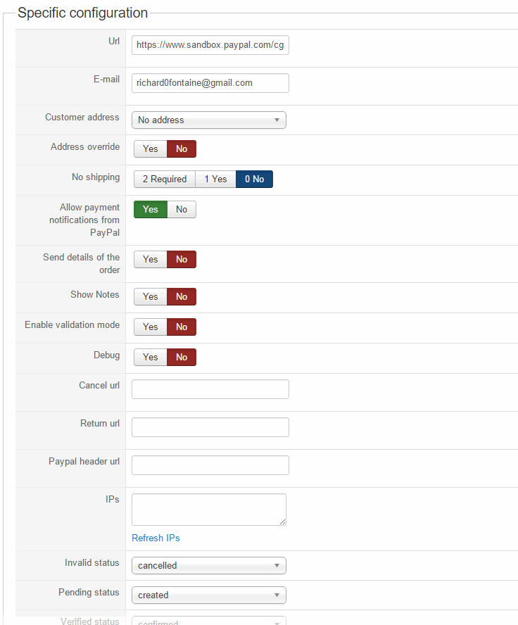

  • Posts: 105
9 years 4 months ago #266812
I have the same problem and it doesn't work anymore.
I have disabled the override and it doesn't work.
I actually don't use addressees, I sell only services; no shipping. I am so far in the sandbox.
Richard
  • Posts: 86027
  • Thank you received: 14172
9 years 4 months ago #266826
Then turn off the "send order details" setting as well.
If that doesn't help, please provide a screenshot of the settings of your PayPal payment method.
  • Posts: 105
9 years 4 months ago #266898
it was already turned off. It tried alsowith "no shipping" set to 1.
regards
RIchard

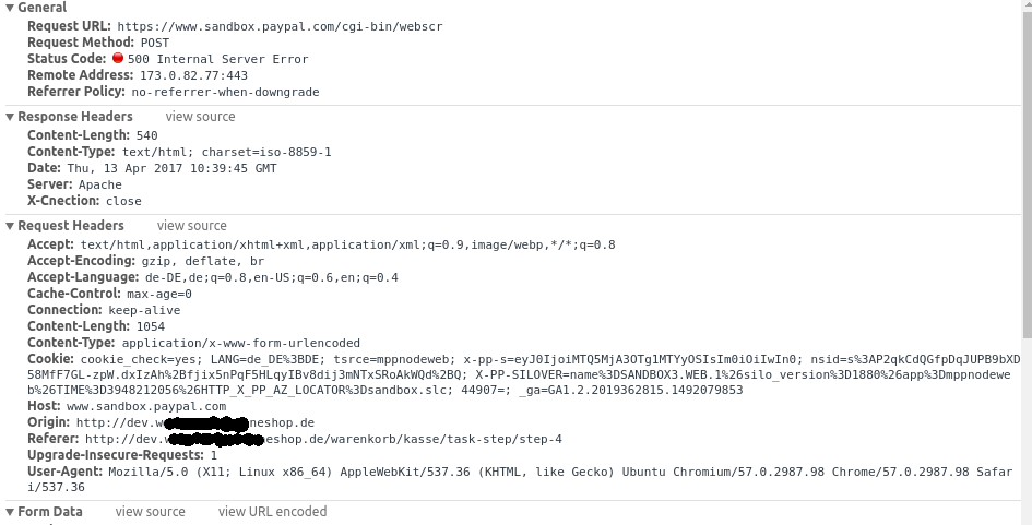

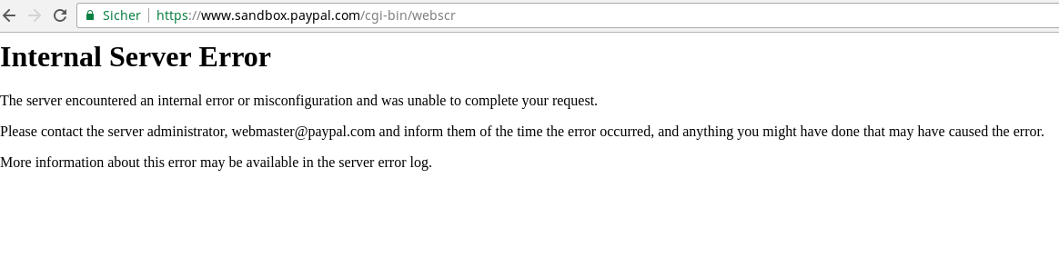

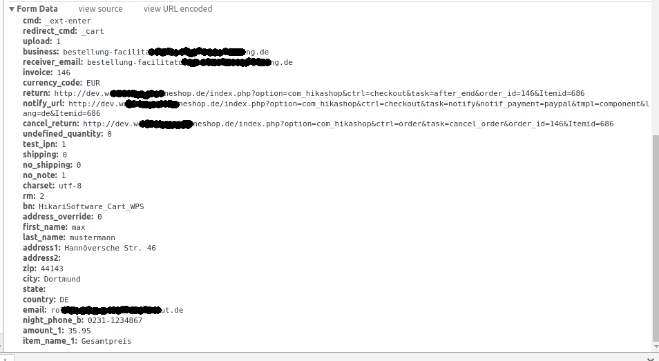

  • Posts: 2
9 years 3 months ago #267332
we also have a problem with hikashop and paypal payment. We are testing the shop with the paypal sandbox but after I got redirected to the paypal site I get a 500 Error. This problem exists for at least a week while some weeks ago this has been working.
I attached the sent form data
  • Posts: 26380
9 years 3 months ago #267489
Please contact the Paypal support in order to have more details about the issue.
I'm not saying that you should debug though. I agree that it's not your role. It's the role of PayPal's support. They should look at your transactions data on their end and tell you what's wrong. That's actually what I told you in my previous message.
