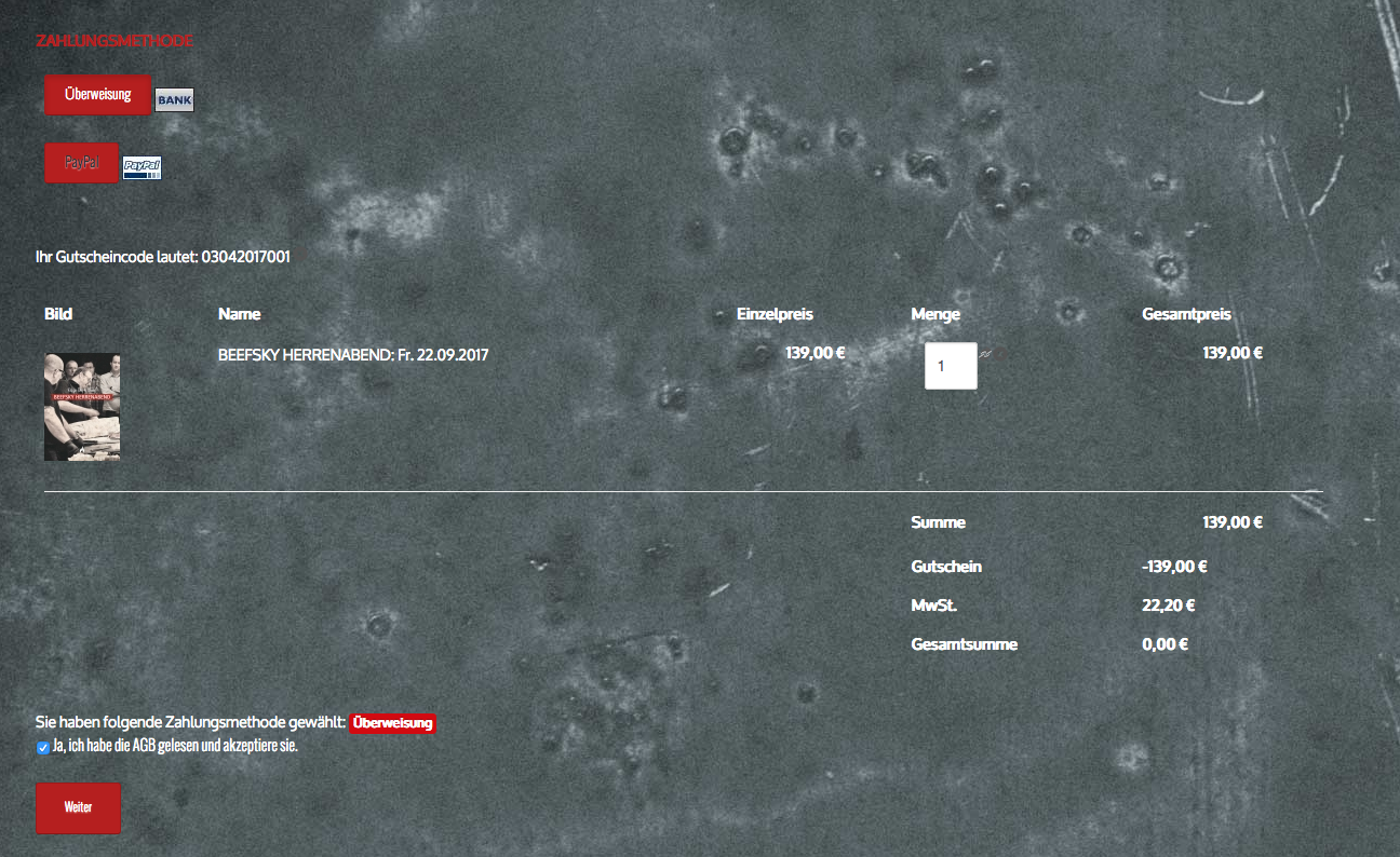

This is a testside so you can make an oder to check it.
If you oder e.g. "BEEFSKY HERRENABEND" and make Coupon-Code "03042017001" inside you have to pay 0,-.

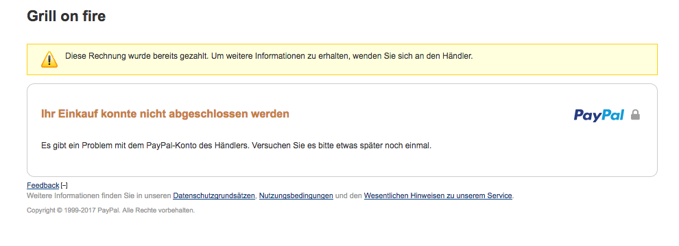

If you make paypal for pay and you click "order" you will switch to paypal with an Error page I attached.
If you make "Überweisung" for pay and you click "order" you will switch to the HikaShop bank transfer payment site.
Is it possible to make an Coupon-Pay-Button or something like this so the user can make a switch in the payment method.
In the backend of hikashop there isnt a payment method with something like this?
Please can you help me?

If i fill out coupon code and the price is 0.- and I click on order, I was taken to the bank transfer payment or to paypal payment but it is 0,- so I didn`t need it.
If I have 0,- to pay Iand click order I must taken to a thank you page or something like that because i didn`t need to pay a balance.
How can I make this.
If I have a balance pay of e.g. 10,- I must taken to paypal or bank transfer witch I choose on order
Did you understand now?

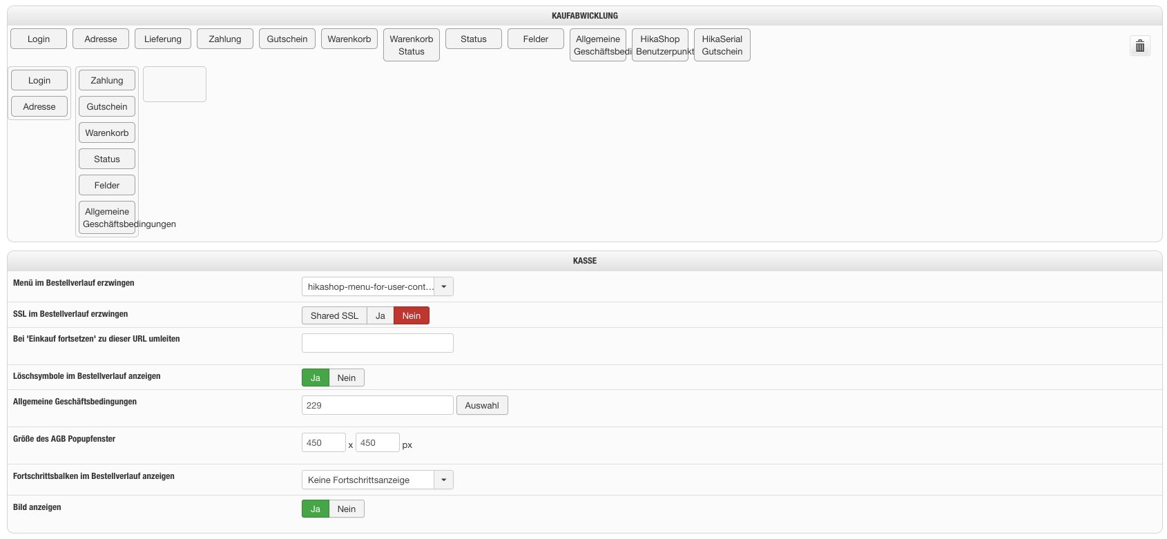

You can see my settings in attachment.
If I fill out a 100% discount but the payment method selection isnt removed so I was link to bank transfer payment or to paypal payment

You didn't provide a link to the shop or instructions to reproduce the problem, and the screenshot you provided is in German, which we don't speak and doesn't contain all the settings under the checkout tab.
So I'm not able to say anything more than what I already wrote in my previous message. Could you provide the information we need to be able to help you ?

grillonfire.seiler-kunz.de
