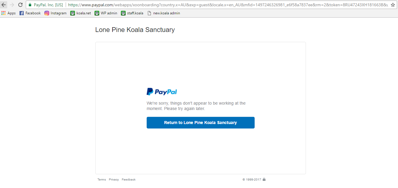

Paypal (standard):
- When customer enters credit card details in to Paypal, we receive the attached message.
- Backend: order displays as 'created' and customer receives 'Your order has been created' email
- No further actions occur after this point.

2. As that error message doesn't contain any useful information on what the problem is, it's hard to say what to do.
I suppose that it must be related to what you're using for your tests and how you configured your PayPal plugin.
For example, if you configure it to override the address but that the address that you entered during the checkout is not a real address, PayPal can refuse the payment.
Normally, a PayPal payment method configured with the default settings and just the merchant email address field filled in should work fine.
