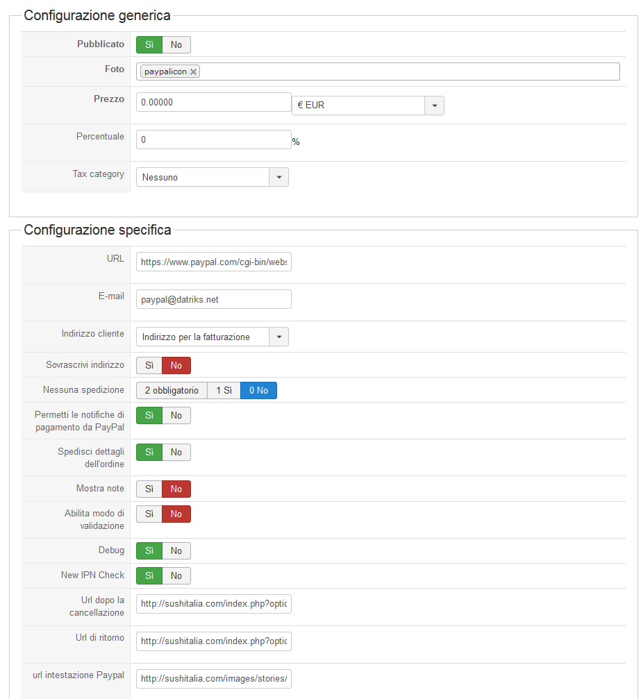

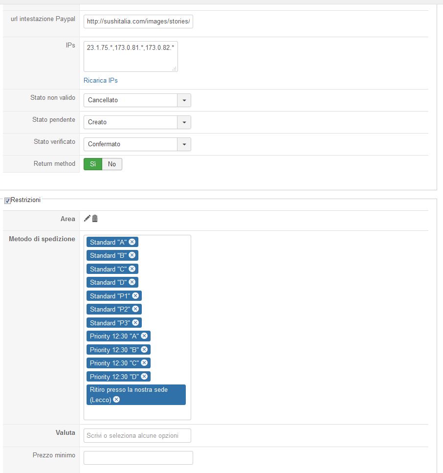

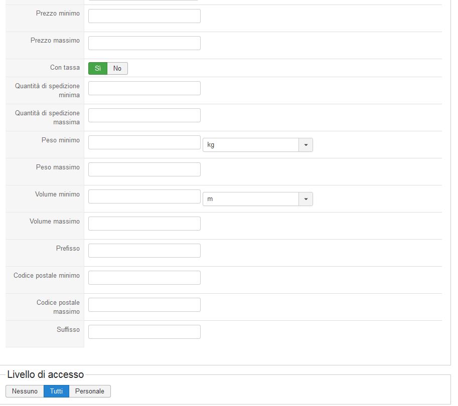

  • Posts: 56
8 years 11 months ago #276107
Hi Jerome,
see the attached screenshots
Last edit: 8 years 11 months ago by trik84.

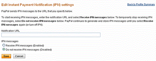

  • Posts: 56
8 years 11 months ago #276226
Hi Jerome,
I've modified the charset from windows 1250 to UTF 8 but nothing is changes, but a difference of problem described in post you link ( www.hikashop.com/forum/install-update/89...pn-check.html#275682 ), in my case I have no notification and nothing in log even though debugging is active.
If i see my IPN history page in PayPal i see all notification before 02/08 have status failed, and all after have status disabled, on 02/08 I've installed new plugin and active tne option New IPN Check.
In PayPal IPN configuration setting the option Not recive IPN messages (disabled) is flaged, to enable the IPN notification this option must be active ?
I've never modified this option but befote the update to the last hika shop version all works fine.
Have you some suggestion ?
Many Thanks
Luca
  • Posts: 26380
8 years 11 months ago #276242
You should force the activation of the IPN :
developer.paypal.com/docs/classic/ipn/in...tion-guide/IPNSetup/
  • Posts: 56
