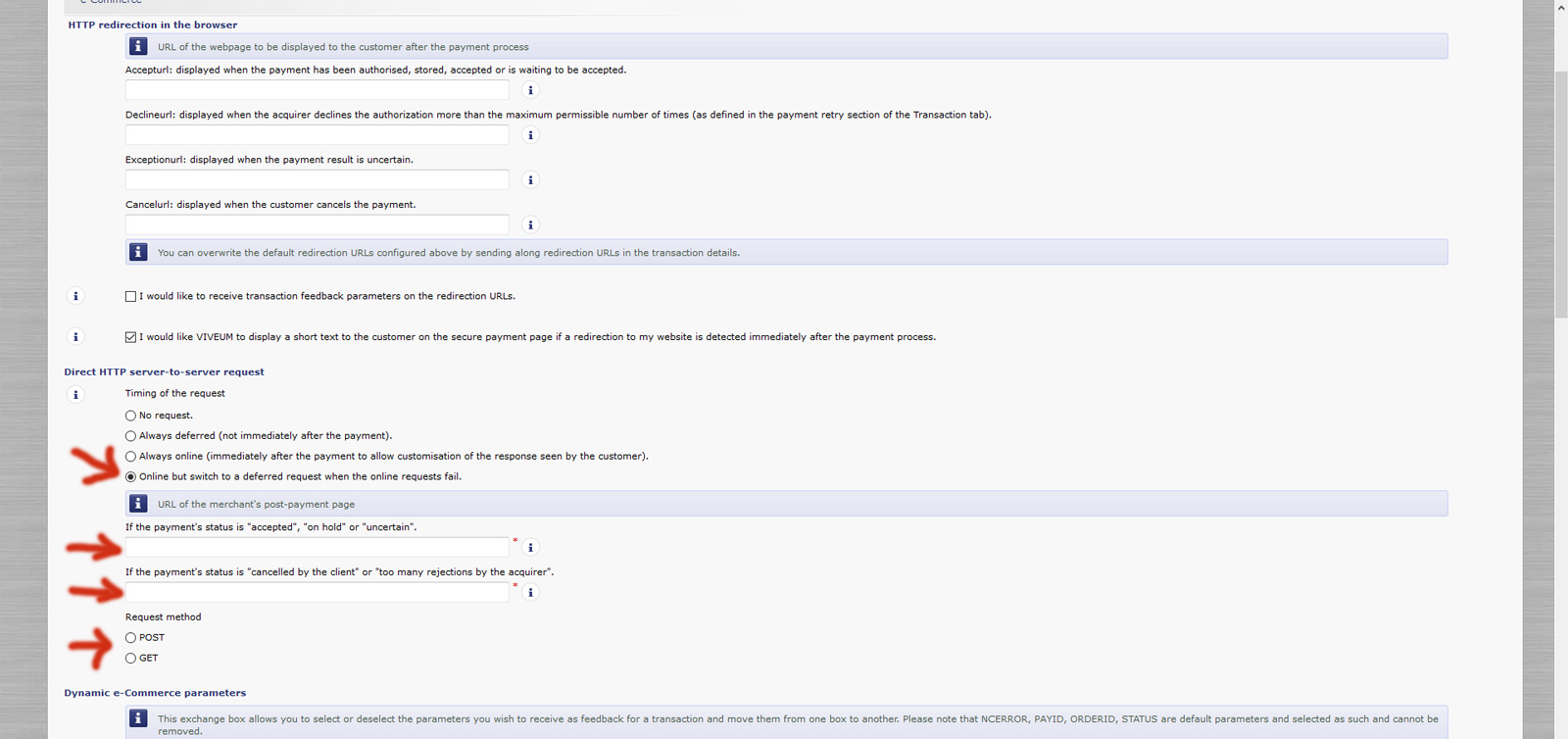

We tried a lot, now Viveum support asks me to fill in the URLs of the shop to where the "Transaction feedback" is sent (see the screenshot).
a) If the payment's status is "accepted", "on hold" or "uncertain".
b) If the payment's status is "cancelled by the client" or "too many rejections by the acquirer".
c) Methode Post or Get?
1. Could you provide me this Info?
2. Or is it a problem of anything else?
  • Posts: 86027
  • Thank you received: 14172
8 years 11 months ago #276940
You want to use "POST" and use the "After payment URL" mentioned in the settings of your ogone payment method in HikaShop for both URL settings.

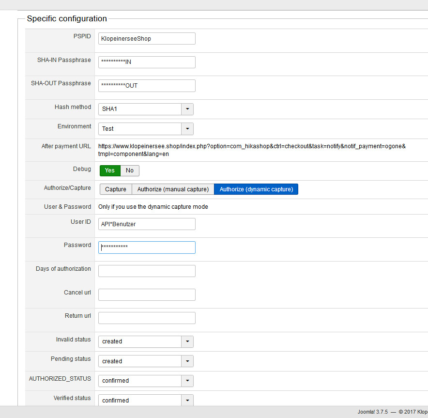

Before I contact Viveum support again, could ypu have a look at my settings of Ogone payment plugin? Maybe there are wrong settings.
thanks
  • Posts: 86027
8 years 11 months ago #277203
Tehse looks ok.
